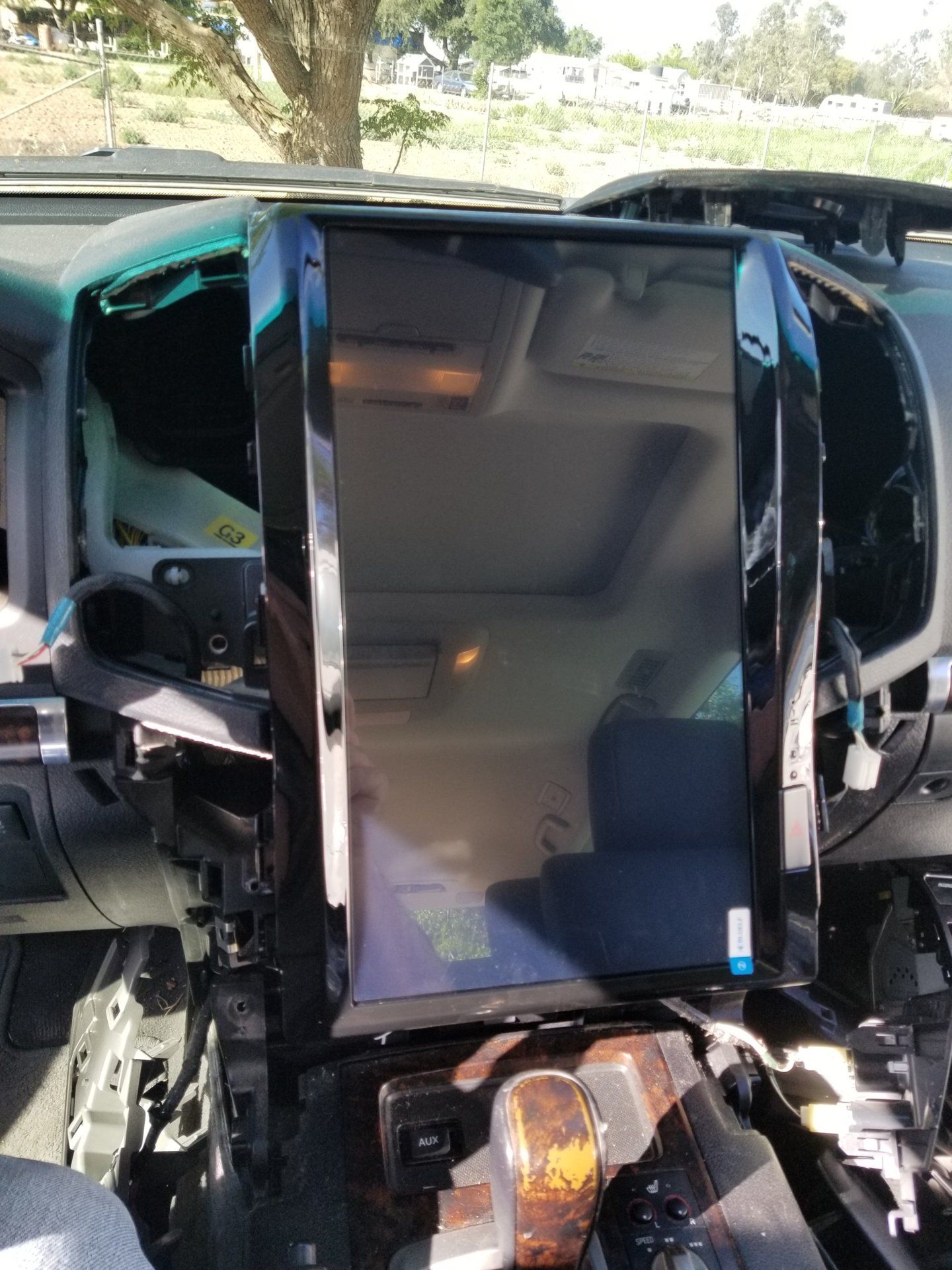

Just installed the 16" screen sourced thru AliExpress (link) in my '08; I believe it is the same as the phoenix one; or at least it looks the same in form and function.
  • Dash Vents Controls = Works.
  • No way of connecting rear DVD Player.
  • No available DVR Front camera yet.
Im still playing with the setup, I cant seem to get any custom setting, images, skins or anything... can someone share the password for the advance settings? and/or the files for update available in the web?
Thanks.
Thanks.

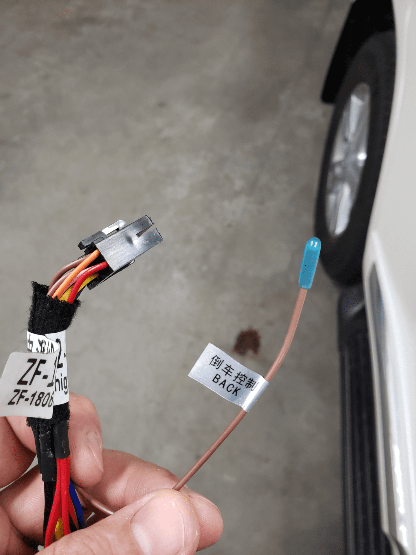

I am trying to work through my issue of having no backup camera and no audio. For those who have installed before, there is a non pinned line on the harness of the 20 pin connector on the back of the unit that is labeled back. There is another pinned line on the av harness that plugs into the back of the unit that says back. Should those lines be connected together? (back line on the main harness feeds the back signal to the back line on the av harness?)
I'm not sure the installation procedure, but I believe "back" should actually read "reverse," if that helps at all. Good luck.

back up signal-can be connected to your existing wiring from stock camera and ground. You need to test in reverse and see if it triggers the video on your new new until. As far as sound, more then
likely it’s your rca cables bad or it’s not connected properly.....If all fails, take it to a stereo shop, they can test those 2 connections, remember to bring stock radio.
good luck
Dear Billund, If you didn't manage to solve your issue with trigger wire for back up camera here is what you need to do is to connect this brown colour wire which is written back to factory harness F28 Pin 13 which is written Reverse but be aware to step down the 12V to the Camera so it doesn't get damaged as the camera uses 6V, I hope this could help if doesn't send the pics of the back of your unit for additional information, Thanks

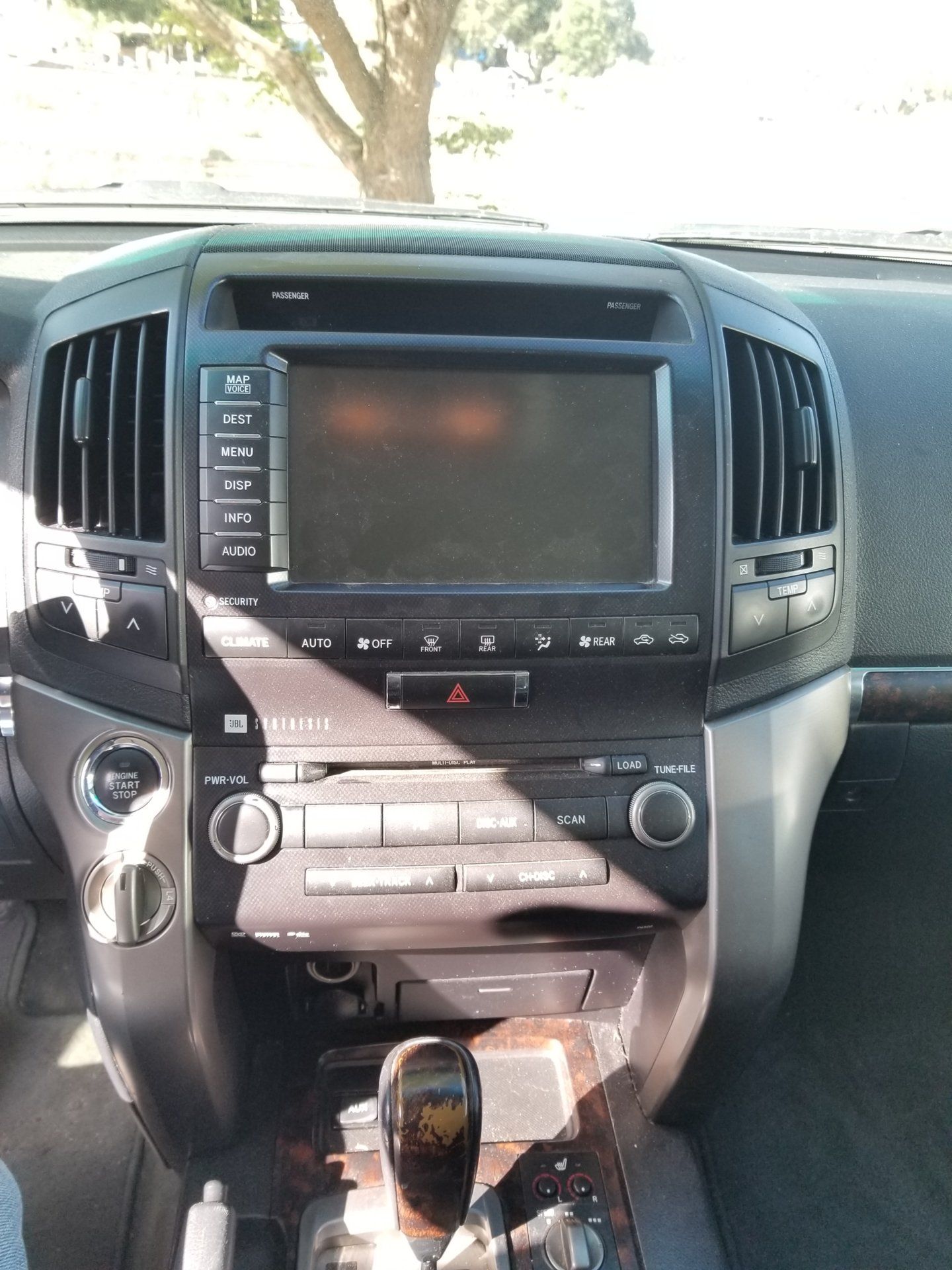

I know there are other posts regarding this, this is just about my install of the latest Tesla style Android 16" vertical infotainment system from Phoenix (which replaced the 12.1" they offered - they still have not updated the web page yet, and I bought the 12.1" and they sent me the 16" replacement). I bought this because I wanted better music media options - USB, streaming etc. I am an engineer and like testing out and playing with new tech, so it was worth the risk for me.

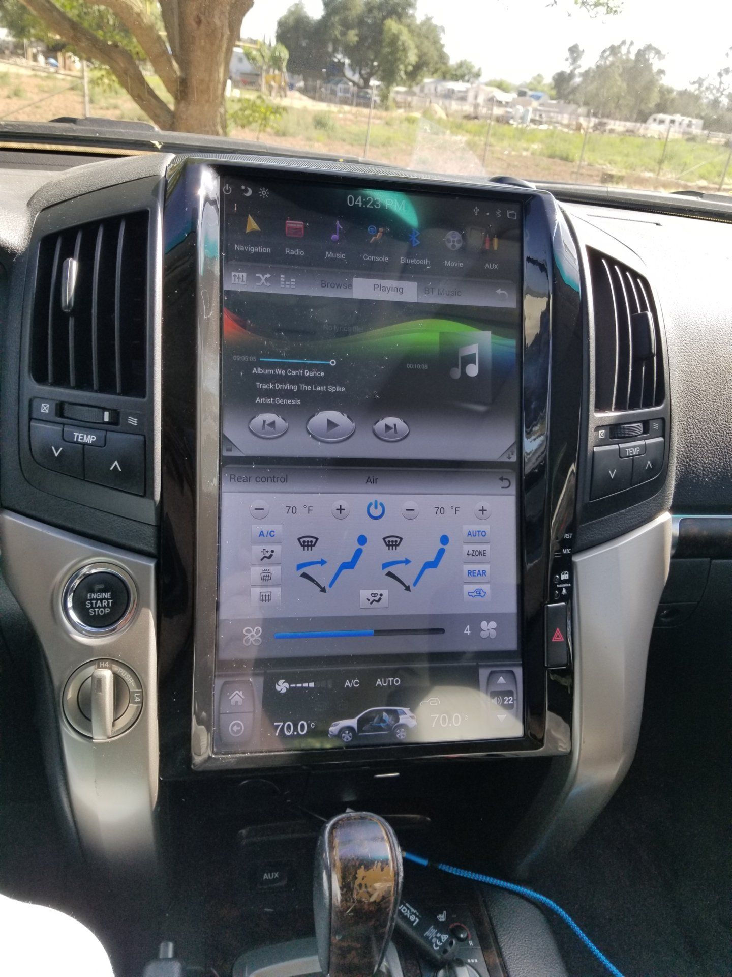

Let me set the correct expectations for everyone, if you are looking for this to act and work just like a it does in a Tesla or a factory setup, it does not and will not be that smooth and responsive - they are just not there yet. However it is improving very quickly, just over the last 6 months they have made great progress and improvements. The latest hardware is really good, they got rid of the moving around of old buttons to face plate of the new one, and the fit and finish is very good as well is the shipping (my experience, not issue whats so over, and that was being shipped by USPS, so that is saying something).
I will break this into a few categories for you:
1st is the replacement of factory controls and what works and does not work.
WORKS
all the climate controls work - front and back
the steering wheel controls work
the backup camera works - for early models it adds the lines so improvement, for the later models I see the options to support the 360 camera, so I am assuming that does work as well
the vehicle icon showing doors open works
the radar option on the older models works with the center dash display as it always has, the newer models it works on the screen as it does on the factory units
Factory preferences - I believe this still works as it did on later models, my 2008 did not have any so I can see them but not change them (still need to use my canbus tool for that).
Can Bus - this unit does hook into the can bus (via factory harness - no need to plug into the ODBII port) and has all the information the original unit got form the bus.
The latest model replaces that small digital display at the very top that showed climate temp, outside temp and the airbag status. That was incorporated into the main screen and a few hard lights on the right side. However I don't see the external temp anymore, and I don't believe there was a connector for the external temp sensor (although in the settings there is one for temp display) so it could be newer models posted on the bus and older model was hard wire not sure but I no longer have ext. temp right now on my 2008.
NO LONGER WORKS
Back seat DVD player - I did not hook anything up for it, although have not physically checked it, will update later
Hard temp controls under front vents - they are still there and hooked up, however the climate temp controls now work from the main display only
No more factory Nav - not that it worked well to begin with (better options see 2nd category)
No more maintenance tracking - did anyone even use that?
No more external temp - see comment above

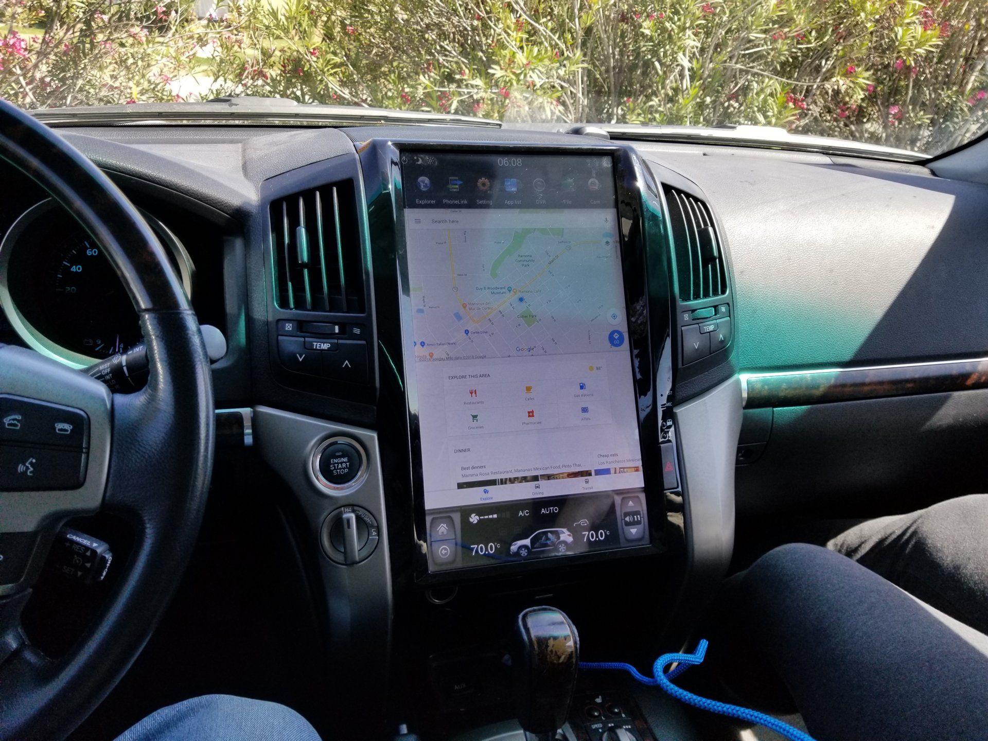

Cool 16" screen. the vertical screen that Tesla introduced is great because it breaks the screen up into quadrants of information or applications. on this one you have a header section - select options hard coded in the software (however it is android so open platform for you to mess with if you know what you are doing) and it has a footer section, this is for your back and home button and also have the information and launching of climate controls. The middle is broken up into 2 equal areas for apps so you can have radio on one and something on the other one, nave so far takes both sections (I am sure I can adjust it, just have not played with it enough) the climate and door alerts are pop ups over whatever else you have in the sections. There are other launch skins and apps you can load Phoenix has a drop box with a bunch of tools and other apps you can get, and also this is android so you can load some of your favorite apps if you like (and the work on that version and build)
This is Android 7.1 btw
you get google maps. Now google works best when it has internet connectivity (get into that later in this post) but you also can download maps and use it in offline mode and early test show it does work but not as good. However finding places and getting routed to them works just fine in offline mode once you have downloaded the maps.

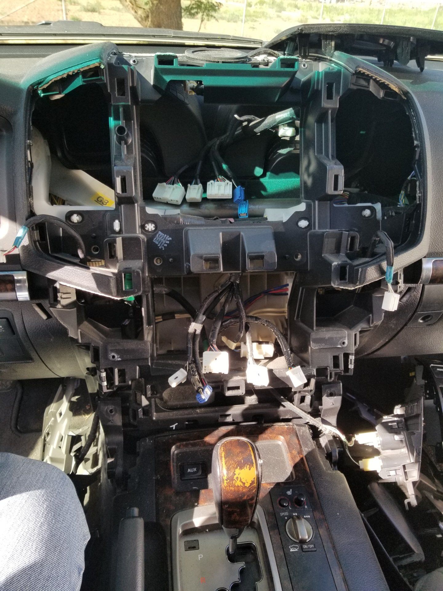

Install
The install is pretty easy, as long as you are good at figuring things out without instructions, if you are one of those that need a thick manual and must study if for hours and then do the job, this is not for you. You will get zero instruction manuals with this unit. However they do have a good knowledge base and support site. It is for the must part plug and play, once you figure out wich hardness to use (they included 3 different ones for me, I imagine it was for the different years) and how to hook up the can bus decoder, video decoder and other "box" that is included. Absolutely no dash modification is required. the fit and finish is very good on this latest unit. only thing that is left up to you is where do you want to route the USB ports (you get 2 of them)
