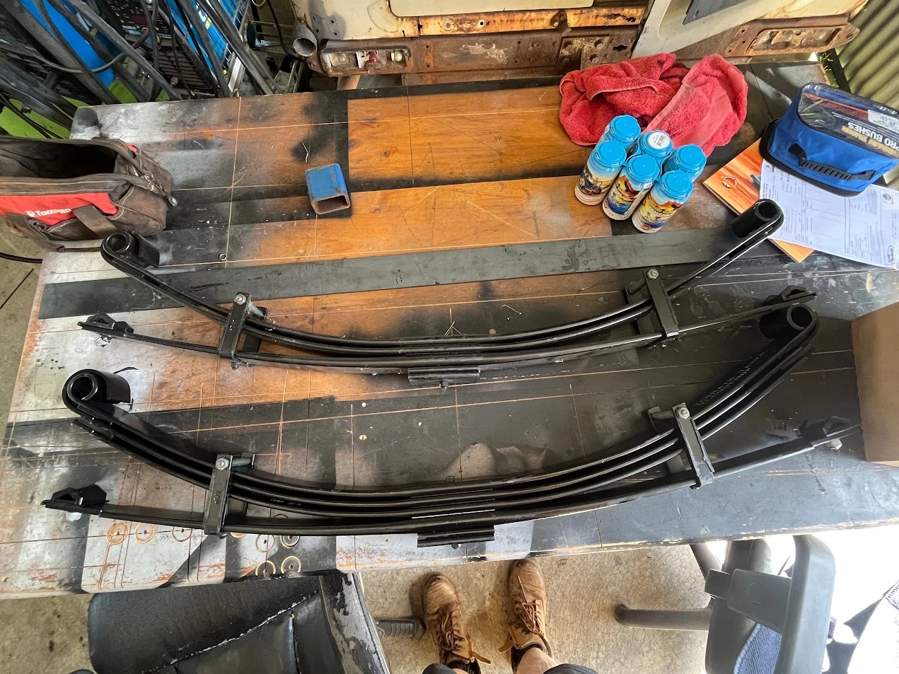

Do the parabolic springs still use stock sized 40 series bushings?
I think so; they're 25mm.Do the parabolic springs still use stock sized 40 series bushings?
That's too bad. Fj40 bushing stock size is too small. Some aftermarket springs come with larger eyes. Probably fine for light offroad though.I think so; they're 25mm.
Hmm . . . my stock-size bushings on the stock springs performed quite well for 80,000 miles before I swapped suspension. But maybe I was only doing "light" off road.That's too bad. Fj40 bushing stock size is too small. Some aftermarket springs come with larger eyes. Probably fine for light offroad though.
I've always gone through stock sized bushings pretty quickly. Springs with larger bushings seem to get longer bushing life for me.Hmm . . . my stock-size bushings on the stock springs performed quite well for 80,000 miles before I swapped suspension. But maybe I was only doing "light" off road.![]()

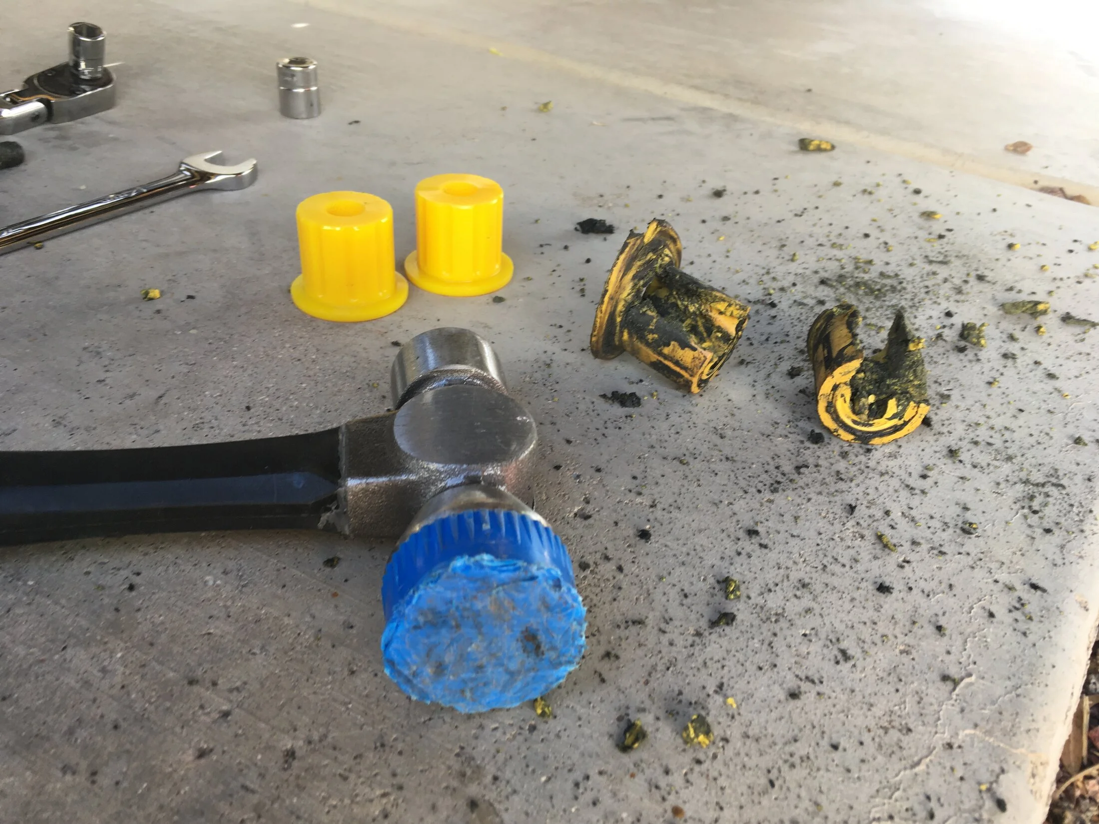

I've found the material makes more difference. Terrain Tamer is using a synthetic elastomer they claim dampens vibration like rubber but lasts like polyurethane. But even polyurethane isn't perfect.I've always gone through stock sized bushings pretty quickly. Springs with larger bushings seem to get longer bushing life for me.
I've used a couple different bushing materials. The fj40 and fj55 bushing od diameter is very small and the shoulder is very small in diameter too. The fj60 model and late fj40 models went to a larger bushing I suspect because it was an improvement.I've found the material makes more difference. Terrain Tamer is using a synthetic elastomer they claim dampens vibration like rubber but lasts like polyurethane. But even polyurethane isn't perfect.
They are interesting bushings! I am very keen to see how mine fair in the coming year.. I noted the install instructions suggest they are greased at install and are good for their service life after that - I'm rather skeptical and plan to regrease regularly - choice of grease still not clear, any thoughts?I've found the material makes more difference. Terrain Tamer is using a synthetic elastomer
Here is a quick driveway shot of it. I'm sure it's cost that prevents OEMs from installing parabolics. As far as stability, there's no doubt the parabolics roll more than standard leaf springs; it could hardly be otherwise! I think shock control will be the determining factor there. On mine I feel fine on the highway so far. I might experiment with the adjustments on the Konis, but they feel good where they are. I'll also install the TT shocks after a while, to see how they perform by comparison. Shocks for parabolic springs need to be valved a bit firmer to compensate for the lack of interleaf friction. PS I'm with you on wishing someone would make a 235/85x16 tire in load range C. E is a bit overkill on a 40.Jonathan, I appreciate the quality review you did on these! Do you have some more shots of your rig? I'd like to see the stance of it on level ground. The 235/85r16s with this lift sounds like a very good looking and functional all around combo, though I wish I could find some load range C tires in that size.
One thing I wonder is why OEMs aren't using parabolics? (to my knowledge). There must be some sort of drawback, hopefully only cost.
I also wonder how these do on the road. It's not uncommon for me to hit 65 mph with a fully loaded rig for hundreds of miles at a time. Stability is important!
