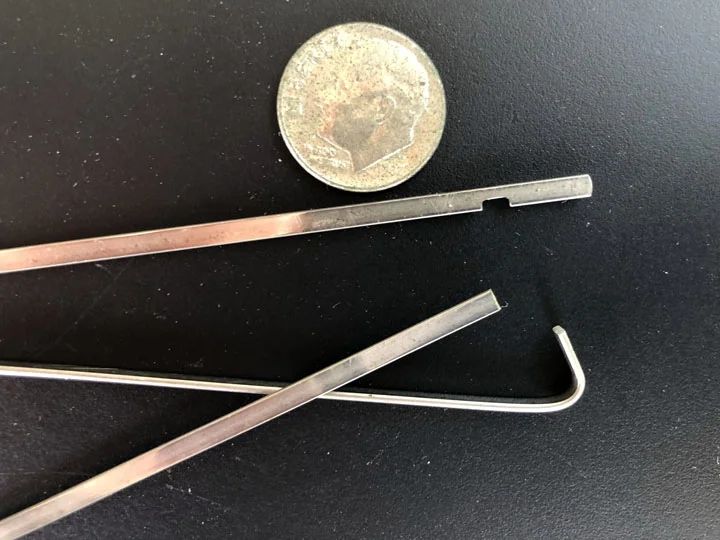

I used a piece of wire clothes hanger, carefully pounded it flat and filed to the correct width. Worked perfectly.

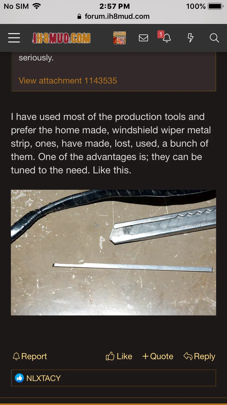

A lot of wiper blades have these stainless stiffener strips which I save. When I can’t find neither of the terminal tool sets that I’ve have put away somewhere, I’ve used these. Lot’s of other uses for them also. Don’t throw them away with the old blades.

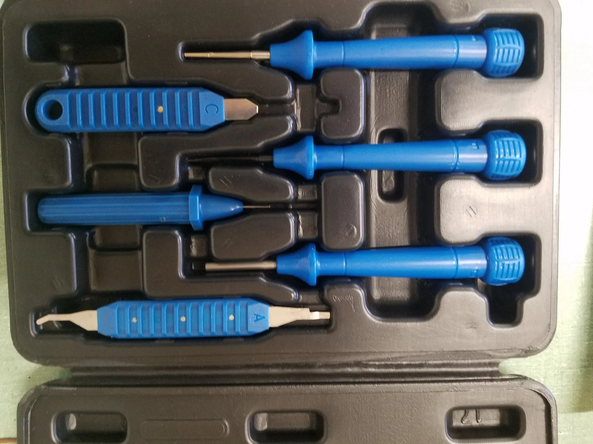

I bought this set, but found it didn't work very well with the old Toyota terminals.

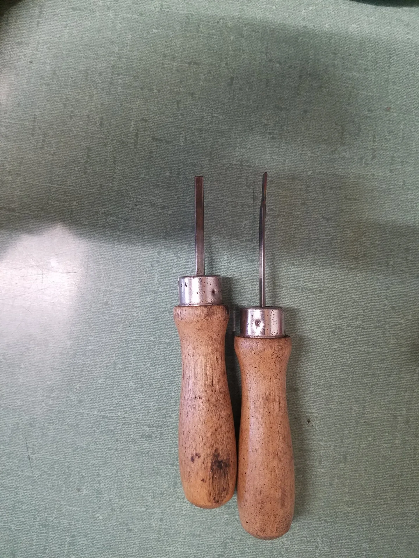

So I made these using a short piece of silver solder and file handles. One is shaved down to work better in the later style plug that has the plastic retainer vs. the tab on the terminal.

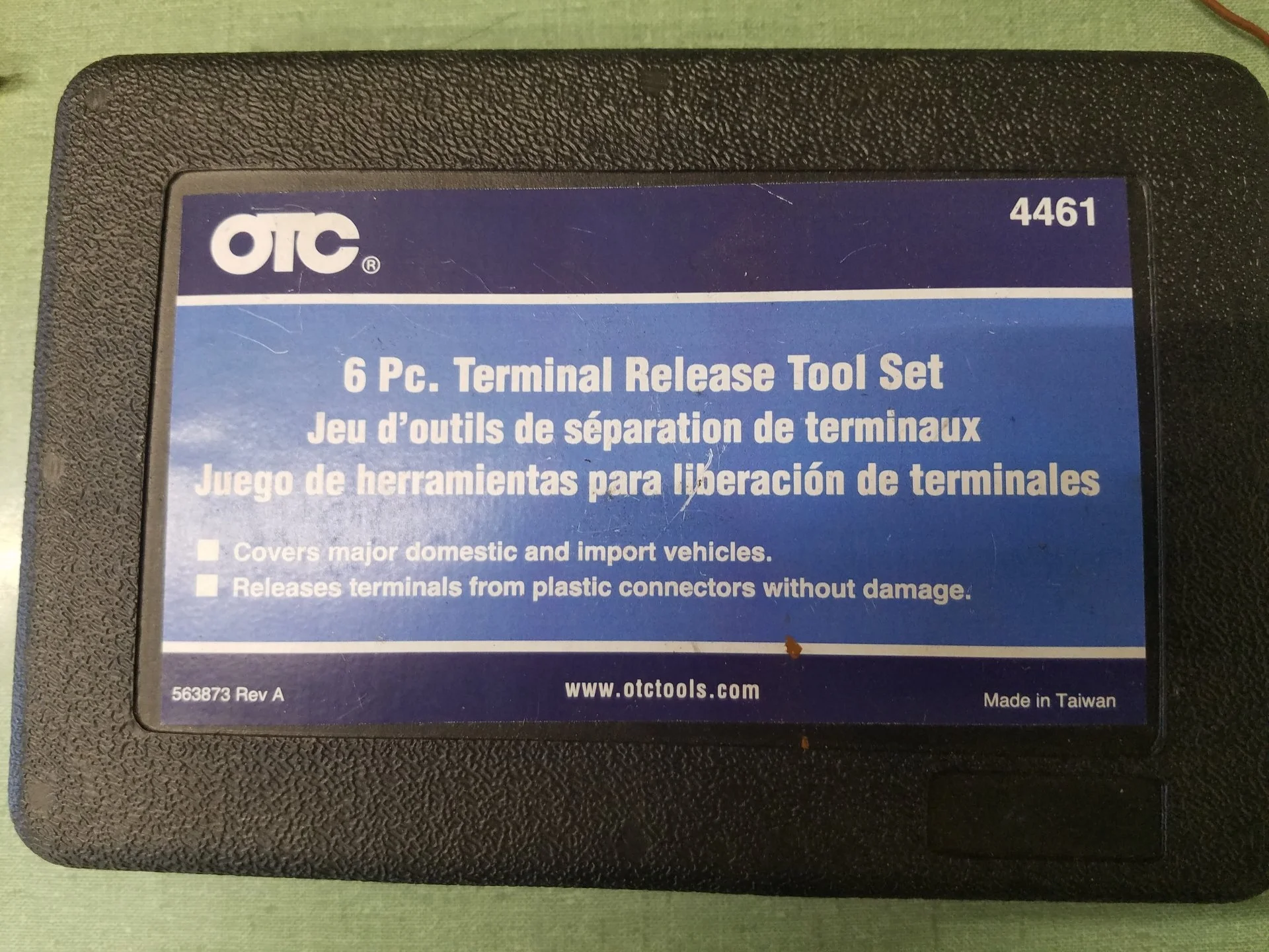

I have the OTC set @Engineer8000 shows , they work great in late model's terminals

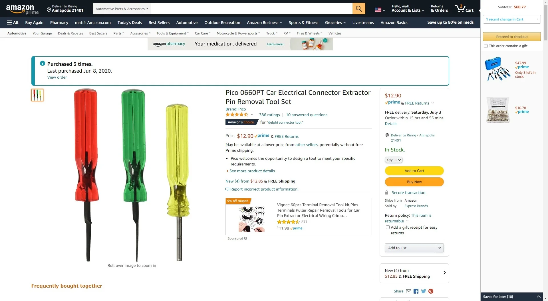

this is my GO to SET the red and green ones do ALL 6.3mm / .250 series terminals
you cant beet the price , i have 5 sets now because i like them so much
