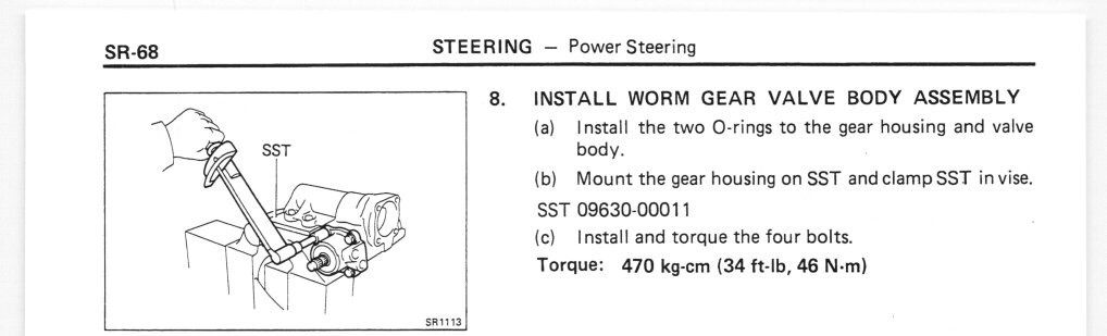

the FSM calls for a 83 foot pound torque on the end cover. I'm at 65 right now and am concerned the bolts may break. They feel like they are stretching. Should I be concerned or go all the way to 83 ft-lb. and I may be missing it, but the book does not cover the torque spec for the top plate on the worm gear. I assume it's the same.

Re-Read your book. You are getting your specs for non-powersteering steering gear box.
I've got my 40/60 series FSM, and I get 29-39 ft/lbs for mine.
Go to the rear SST and Service Specifications of your FSM and double check. I'd say those numbers are
not applicable for power steering gear box. They seem too high to me. If I'm wrong, that's ok.

You are absolutely correct. Really glad I stopped where I did. Thanks for the feedback
@cruiserpilot to the rescue! Nice catch.
@CenTXFJ60 if you've already torqued them to 65ft lbs, they should be discarded & replaced. The torque spec is 34!

The power steering gearbox rebuild instructions are farther in the manual. That page above was SR68.

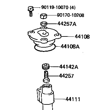

Replace the bolts that got over torqued.
Toyota still sells them.
PN:
90119-10070
