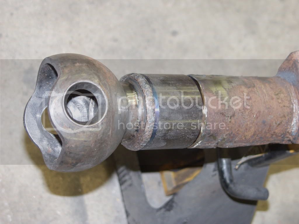

Could those spacers be used to widen both sides of an FJ60 axle?
If so, is there availability of a longer cromo axle to use with 30 spline Longs?

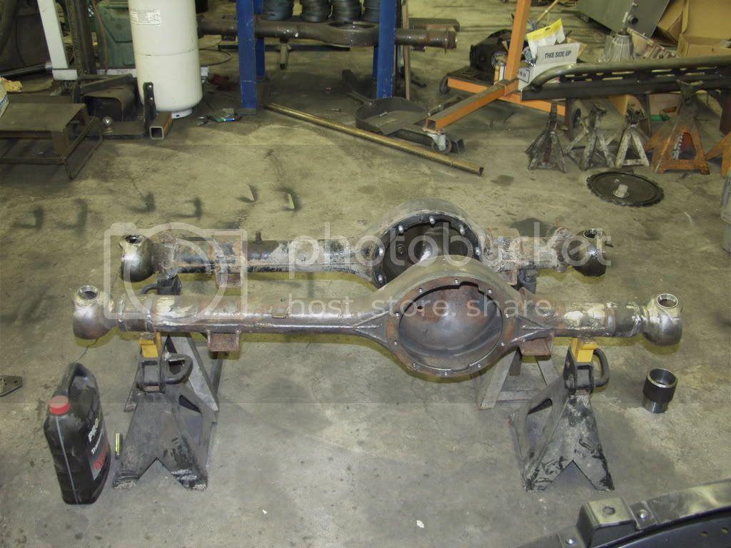

That looks like stage 2 of my FJ60 SOA!

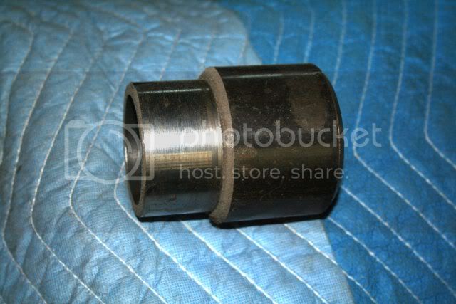

or use one of lcwizard's spacers
but definitely get rid of that kit
hey cruiserdrew,
that last image he posted is a 60series front with spacers on both sides and if you check out the earlier posts about the spacers he gives the info about the special order longs...

Somebody on Pirate did a spacer years ago. A shaft should be no harder than a call to Longfield or Poly, or a custom machine shop (Summit in Utah does shafts). Dutchman, Williams and others?
