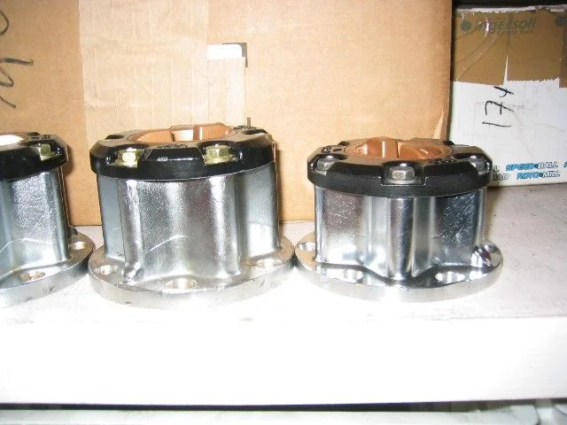

On the Aisins and FJ55s-In the 76-78 era when the Birfield was fine spline, but slightly longer than the standard Birfields used 79-90, the FJ55s came with special "long" Aisin hubs, where the body of the hub is about 1/4 inch longer. I have one of these somewhere in the parts stash and it is an oddity. I was going to use it on my FJ40 but then just converted to FJ60 parts instead.
attachment.php
