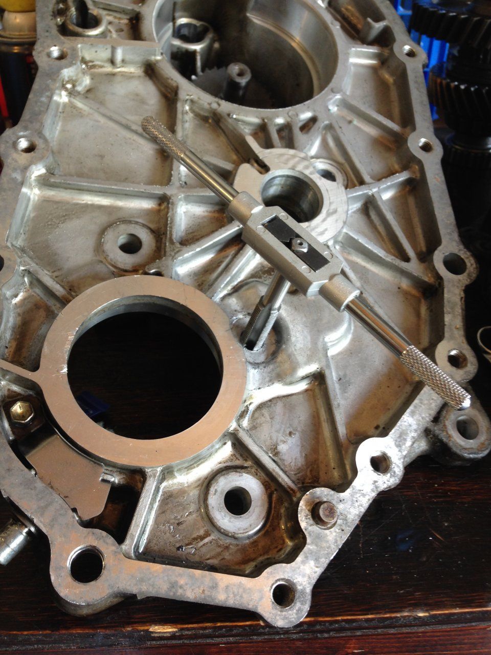

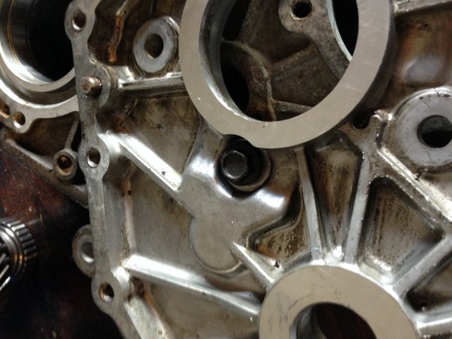

I was lead to believe I could use my parking brake assembly on the later model transfer case that I have for the 5 speed. Am I living in a dream world? Here in Florida, a parking brake is not a huge deal. But where I'm planning on going it will be (more mountains). So, if I can't use my parts on this transfer case, I'll look for a suitable full floating rear axle when and if I get out to the Pacific Northwest (Washington). I did get the extra hole tapped and plugged today. and I've figured out how the oil cup (fifth gear oiler) works. I read through the write up suggested here and there it was; it snaps into position and collects oil spray in the funnel and drips it on the fifth gear bearing (I think). I couldn't picture how it worked until I read the whole thread, so thanks for suggesting the thread Bowlingfor$ and thanks Georg at ValleyHybrids for writing the thread. I once got a transfer case housing for my 62 from Georg which saved me a few $$, so I'm a fan. He knows Cruisers! 002.webp 004.webp
