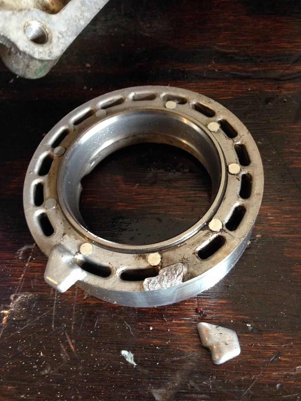

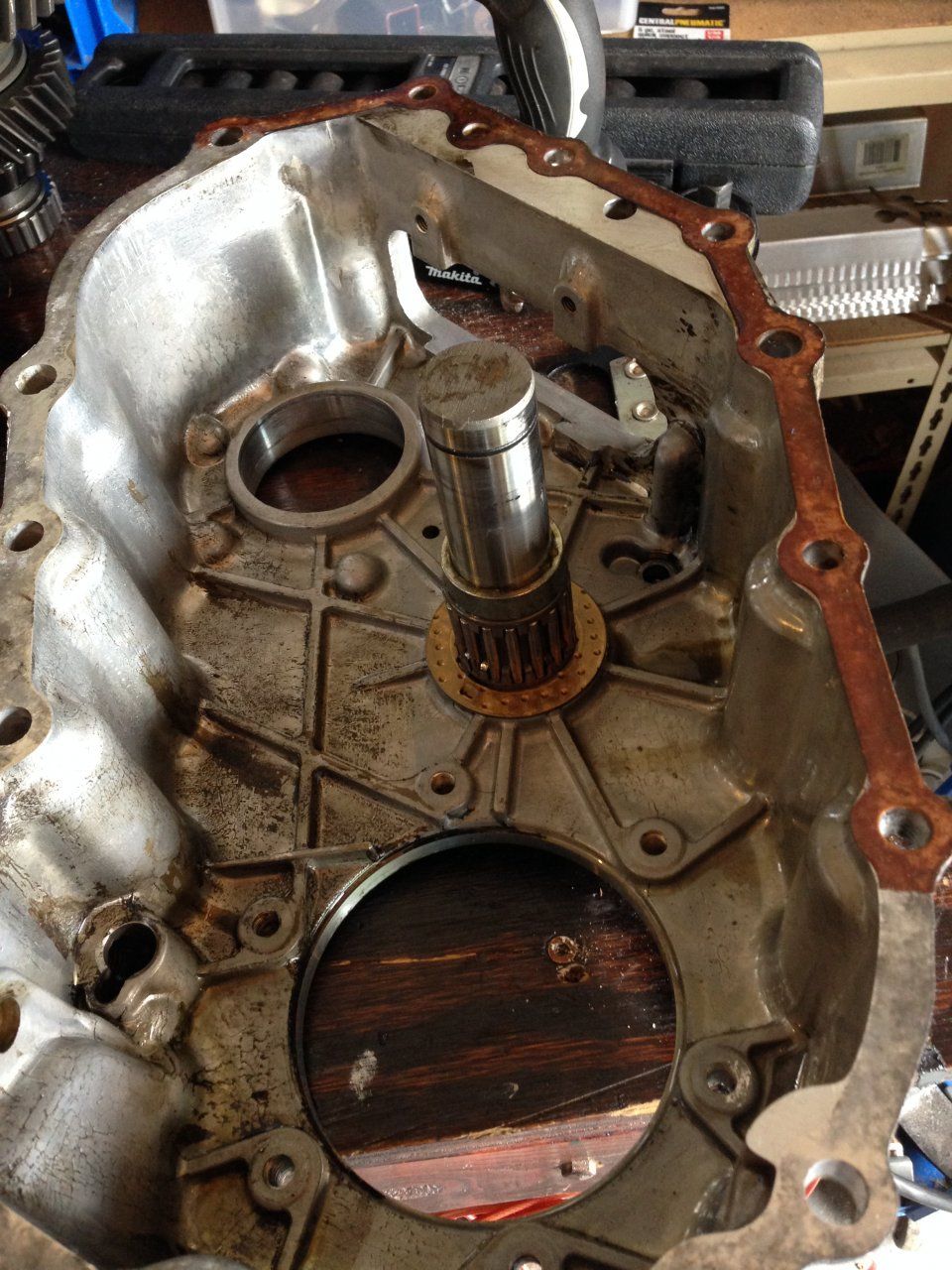

I got the case apart and I found a broken ear on the front output shaft bearing retainer. I asked the guys at Cruiserparts.net (before I ordered) if the case was inspected and they said it was. We'll see if they stand behind their parts and send me a new (used) bearing retainer. I may be able to use parts from my case since its a split case, but as I said, I'm not sure on the year of the case they sent me. It was advertised as compatible with the 5 speed and that's all I know (besides the "late model" identification)?? Other than that, the rest of the case has some corrosion on various bolts and some pitting here and there. The gears don't show any chipped teeth. I'm afraid I'll need to install a rebuild kit either way unless I can use some of my parts from the Troopy's case. I think I did a rebuild on that one as well as the FJ62. And come to think of it, they were the same other than the FJ62 had a push button on the dash to actuate the 4 wheel drive. I believe it was a pneumatic actuator as I recall.

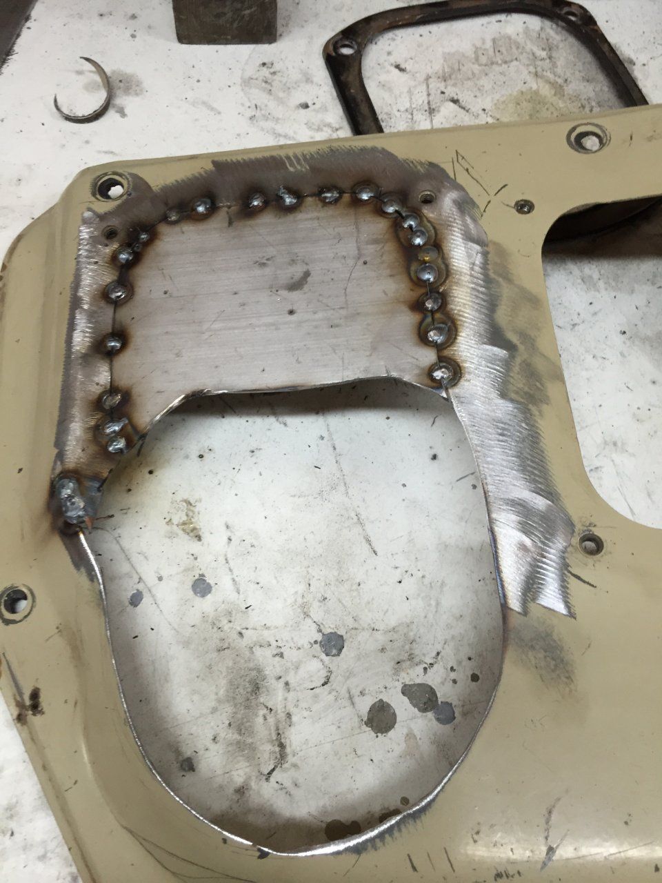

The transfer case was fine. I did rebuild it while it was split but it was perfect. I have a crazy 3" body lift so the only alteration needed was to cut a hole in the tunnel and move everything about 3" towards the seat.
