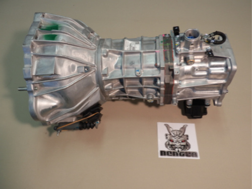

Tempting. Very tempting. With shipping and tariffs would come out to about $2360. Would be nice to be able to just slap the split case on a shiny new trans and shove it in there.
Definitely a chunk of change but not a bad price for a brand new transmission.
Way I see it, its about $1000 more than rebuilding a mine truck trans, assuming no major parts need to be replaced like the input shaft or chipped gears, etc. In that case, it would almost be a wash... or worse. Also, comes with a new trans mount and may be able to use the clutch fork and throwout bearing with the 3VZ bellhousing. And time saved. I think it is worth it.
Excellent point. Given that is an HZJ7x spec unit, you won't be able to use a 3VZ bell housing on it since the input shaft would be too long. A 5VZ bell housing would work though, the HZJ's share the same input shaft with the 5VZ powered 4Runner, Tacoma, T100, etc.
You're right I just mixed up the IDs. I'd be getting a 5vz bellhousing.
Trans ordered, should get it in about a month which is around when I should get my trans adapter. Also found someone who did a UZ swap on their 3rd gen 4runner who is passing through town this week and will sell me his 5VZ bellhousing, flywheel and clutch with 7k miles on them.
