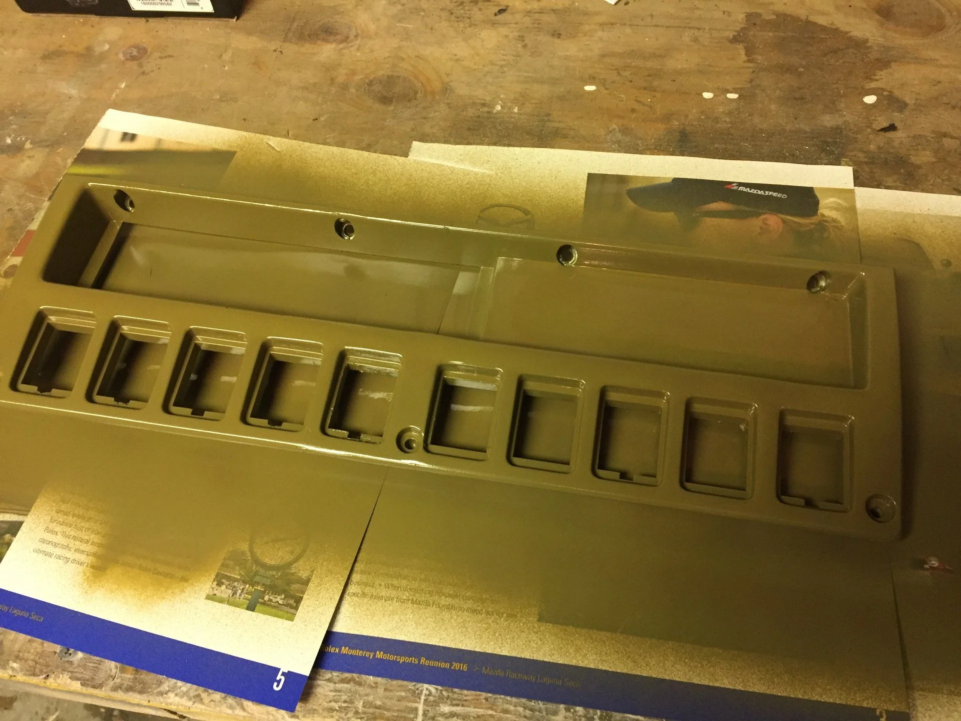

Tan interior paint
Sep 14, 2015
30
170
Chicago
I wanted to knock out some interior work but couldn't find a matching plastic paint. I was digging through my spray paints and came across an almost perfect match. This is interior plastic trim paint for a 69 gto with gold interior. I got it from Ames performance for my goat. It's called mustard gold I think. Almost a perfect match.

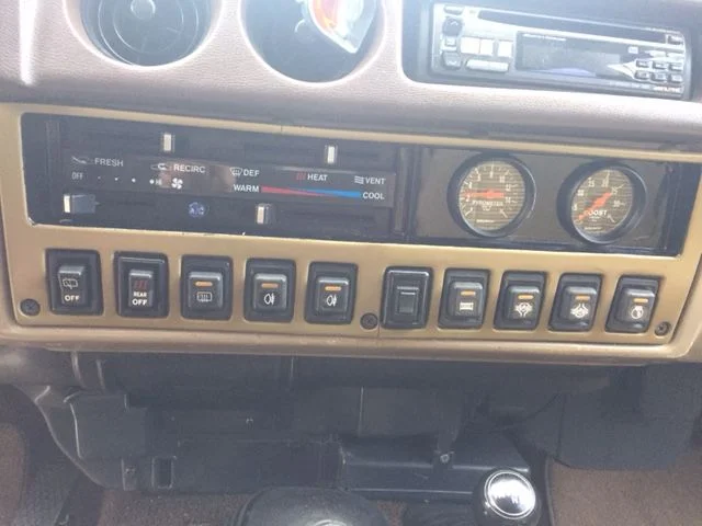

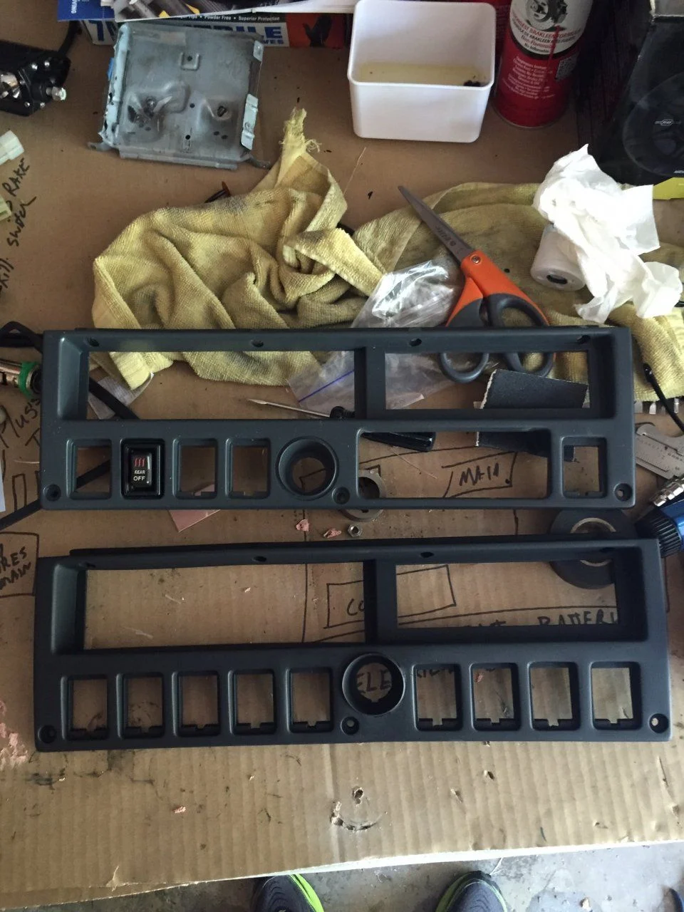

D - I acquired a nice surround and cut all of the blanks off my crappy one using a dremmel. Trimmed them to line up and then used fiber glass on the backside to hold it all together. I then used bondo on the front side to clean up the seams and gaps.
I used some of the plastic from the storage thing to make a plate to cover it up. I'll be cutting a boost and pyro gauge in there after I paint it flat black. The whole job took about 4 hours.
I was going to keep the lighter and use it as a phone charger port but the blanks lined up perfectly.

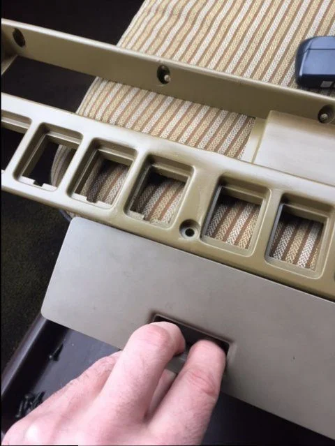

Very clean man. Great work. Back to the paint... is that gloss or semi gloss? It looks like it has a little more sheen than the factory paint, but maybe it's still wet. I would love to see some side by side photos when it's dry. The fuse cover will pop right off and you can put them in the same light and snap a pic for us please. Thanks.

Well..I may have spoken too soon. After drying it's a bit more gold than the tan in the truck. I'm going to paint the entire dash so I'll have to decide if I should look for something else or just paint the entire dash the same color as the piece I just painted.
Thanks man... that's a tough color to match up. For some reason, it really deceives my eye. I have a bezel that I've put about three coats of paint on, trying to do the same thing haha.
When I redid my AC surround I knew I'd never get a paint match so I only painted the black parts. The rest I sanded down with 2000 grit and polished it with plastic polish. Looks like new. Oh, and I epoxied the mount points on the back side to strengthen them to avoid cracks. It worked great.
Im not sure about that. There are several Tans from SEM. I was basing it on the contrast of the newly painted trim bezel against the fuse box cover in the photo above. Paint is tricky though when its not seen in person. This link has a low res photo of the SEM color chart and you can get the same one from Amazon for about 10$
