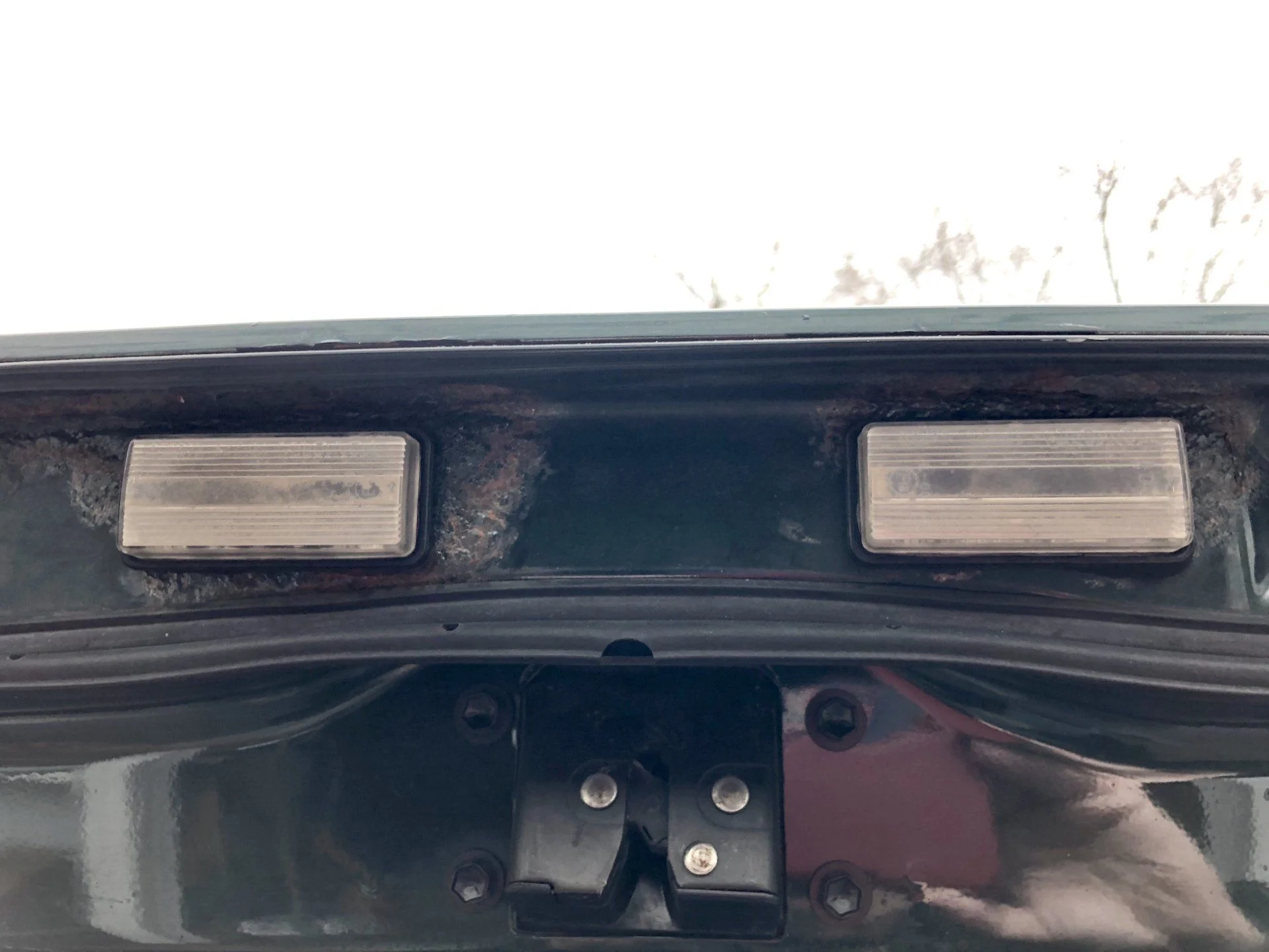

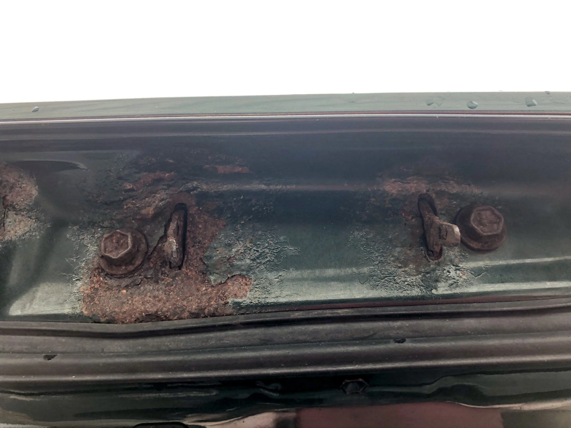

The only place I see rust that worries me is at the bottom of the rear hatch. I took it to a guy that I trust who does body work, and he told me I should just try to clean it up, and cover it with undercoat or paint.
Now, I’m curious to know what you guys think. Is this just a simple scrape, sand and paint job?

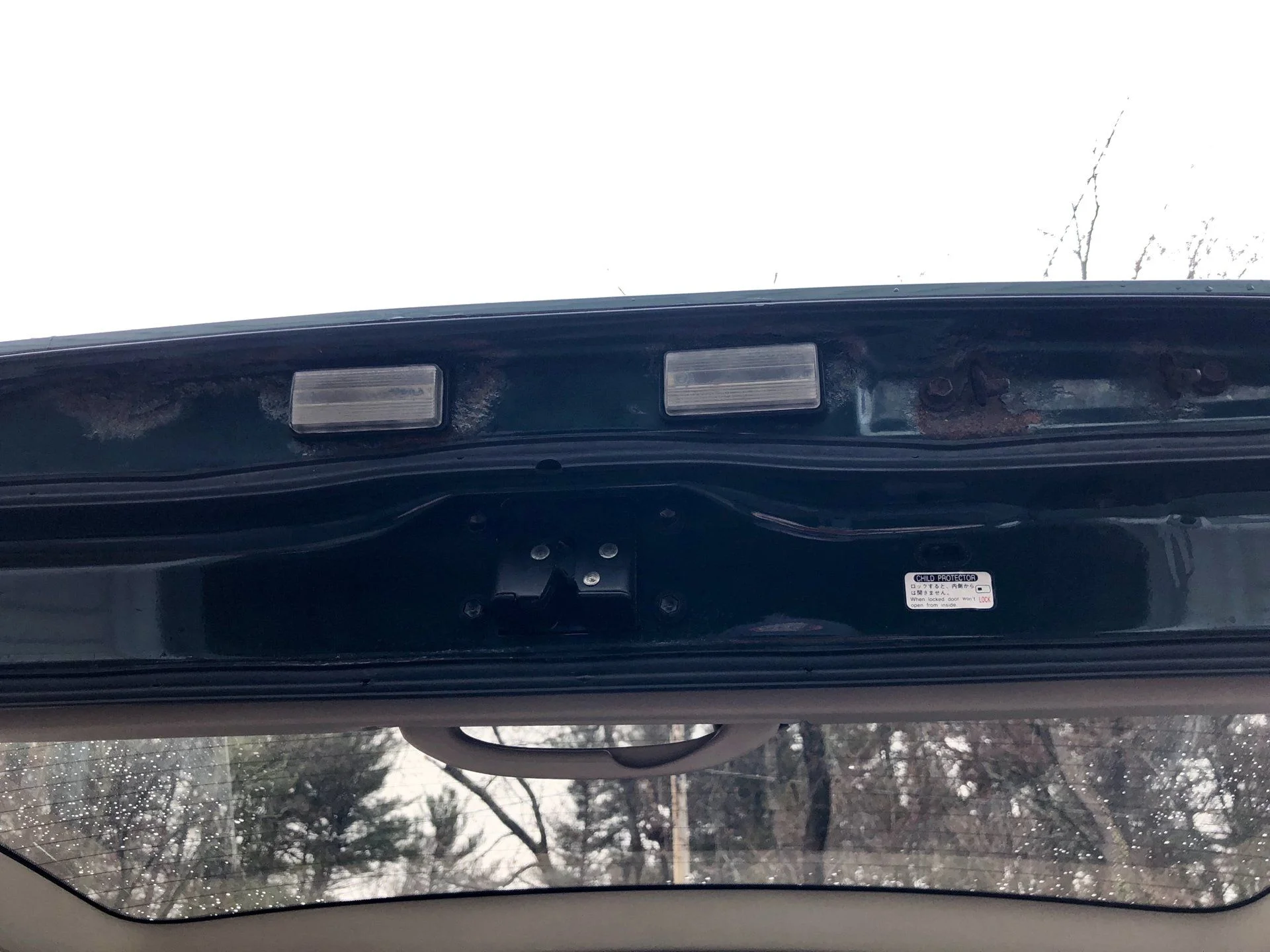

I have a new handle mechanism, and ordered a handle. Note from the pics this assembly/mechanism is also rusty, which is probably why the handle is missing. I need to figure out how to get in there and replace it.
Bottom of rear hatch: most of the rust is around the handle and license plate lights. Sorry about the bad lighting.
The area around the handle (you can see the handle itself is missing):

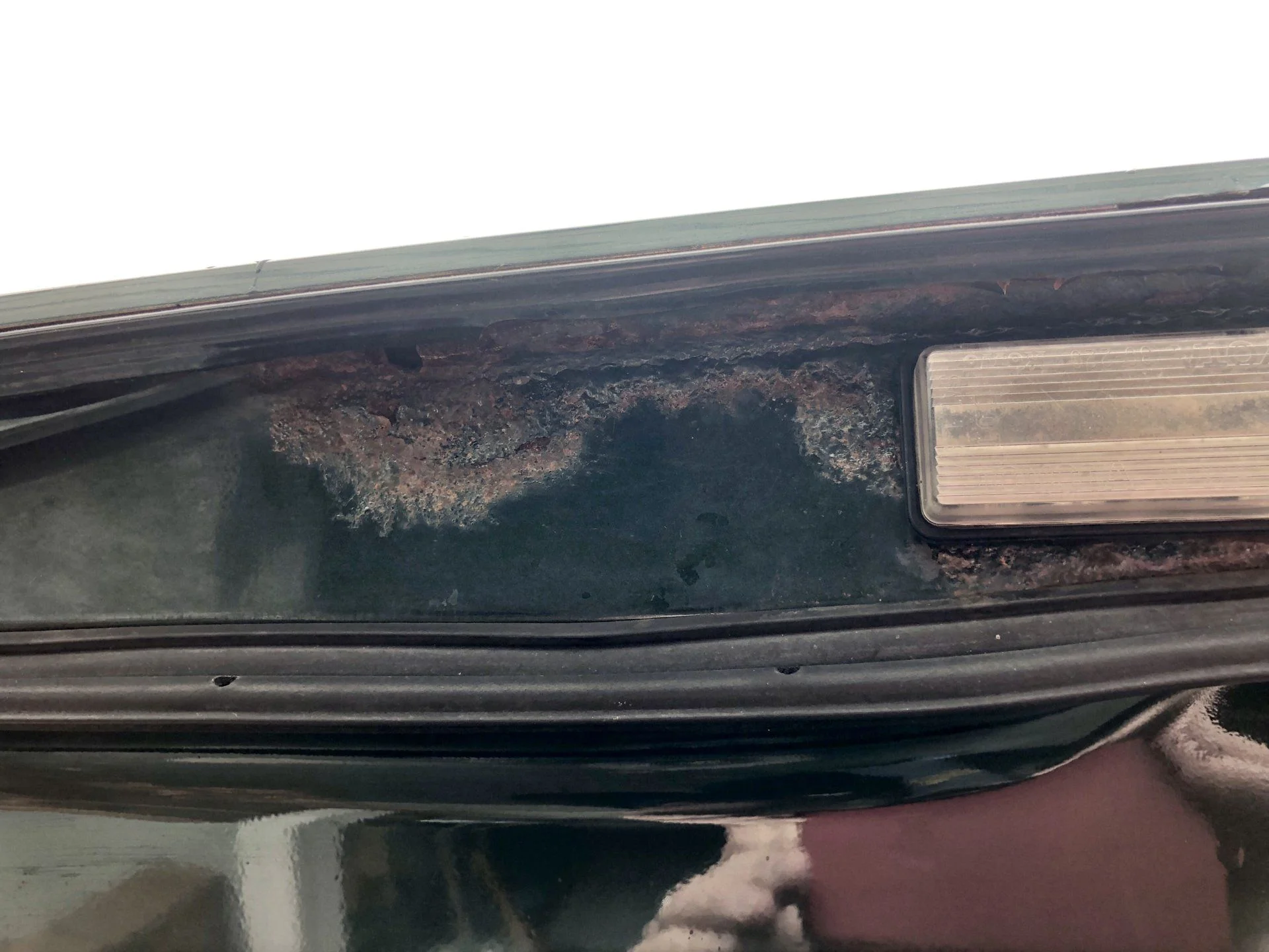

And around the license plate lights:

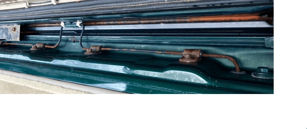

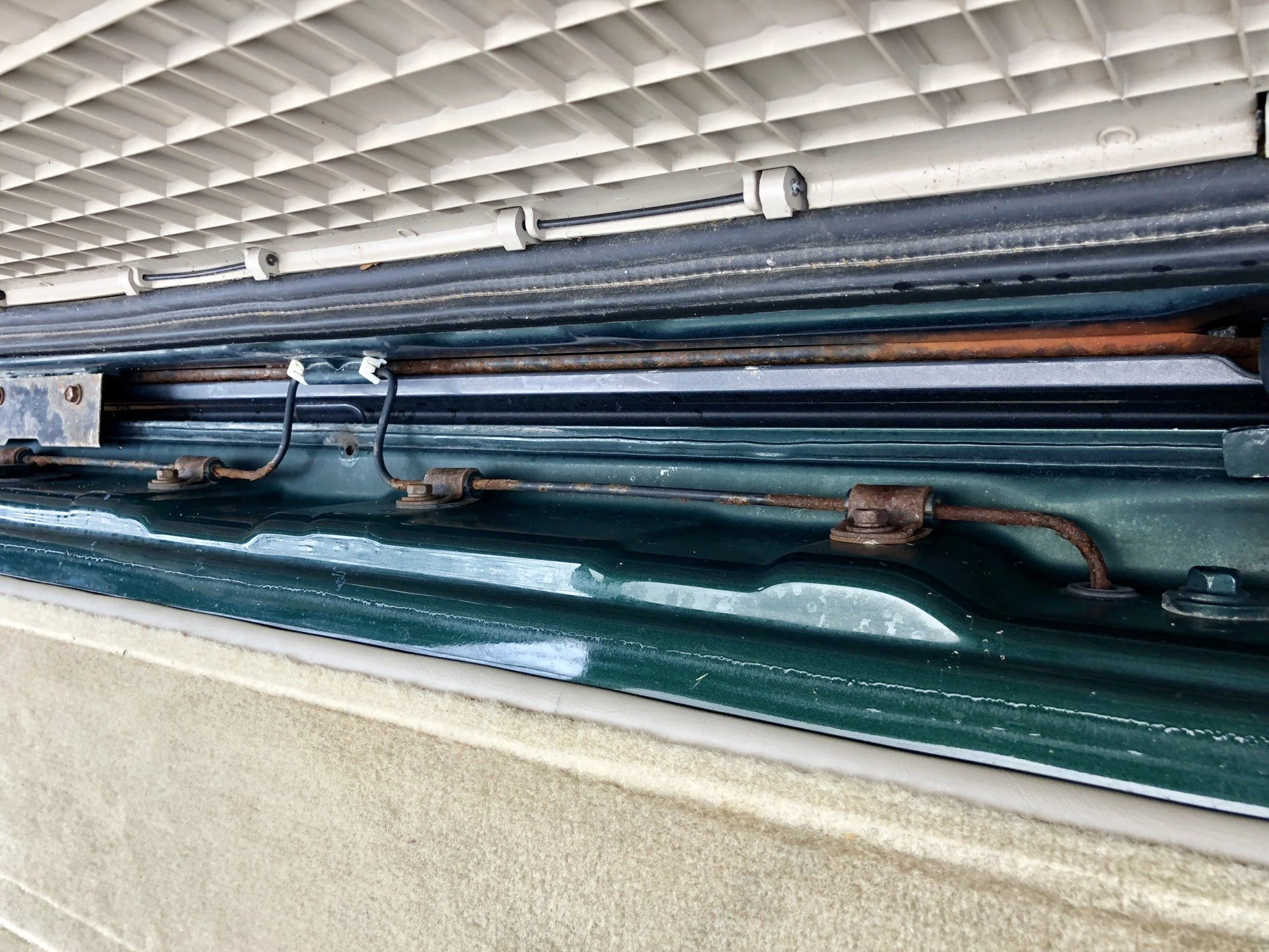

The bottom / tailgate has some rust but I’m guessing it could be treated the same way? Scrape / sand / cover with undercoating?
Suggestions on how to best deal with this rust are appreciated! Also any ideas where the water could be getting in from? This truck is missing the rear spoiler, if it matters.
I had this exact issue but not to the degree you have. Water is coming through rear brake light cover panel. This is the panel put over the rear brake light spot when they moved the actual light to the spoiler from the lift gate itself. The gasket is a porous foam and lets water through (some engineer ought to be beaten).
I removed the cover, used silicone to seal it back and then tore apart the hatch to replace the latch. I have also since replaced that torsion spring assembly that acts as a counterweight for the tailgate. PM me a cell number and I can walk you through the fix if you’d like, too much to type. I am EDT.

Sorry to say but your rust has started inside and is making it's way out now. It's too late to fix. Replace it and be done with it.
This is basically what the body work guy I took it to said. He said I’d be wasting money to have him “fix it”, as he would not guarantee his work (the rust would just come back). He could make it look good but at this point I should just clean it up, and paint on some undercoat. He pointed out the pinch seam, and how there was likely rust between/inside, and in a year or two it would fall apart.

Oh man that looks bad, gotta dismantle everything and go crazy with wirebrush, get all the rust off then paint it with POR15

New hatch time....as mentioned above. I don't see any way to rectify the current hatch. Just know that with a new hatch, you should make sure the 3rd brake light is sealed up real good. That tends to be the weak point for water intrusion. RTV Silicone is a fantastic fix. I did that on mine and added plenty to every roof mounting bolt on my rack.
Yeah remove the 3rd brake light and put a bead of silicone around the housing then put it back on. That’s where water enters. Check the upper part of the hatch for any holes that might’ve rusted through and ingesting water. I didn’t want to spent money on a new hatch so I just wire brushed the rust away and primed it and then wrap it with vinyl.

Sorry to bring this thread back allive but can these lines be replaced?., Mine looks very similar to this.
I think that is the spring tensioner for the tailgate to keep it from just dropping open. Mine looks about the same. I was just looking at mine today!
