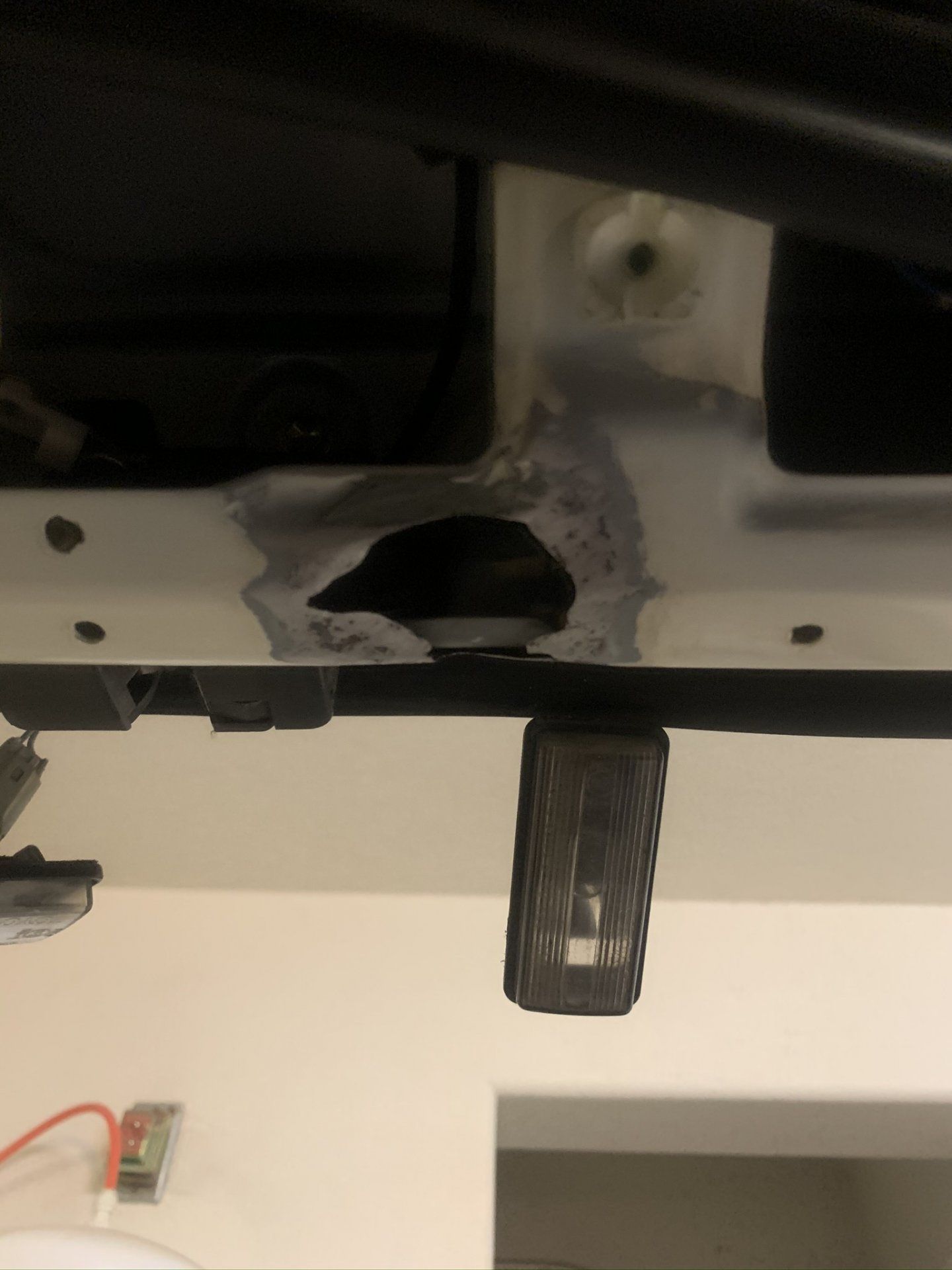

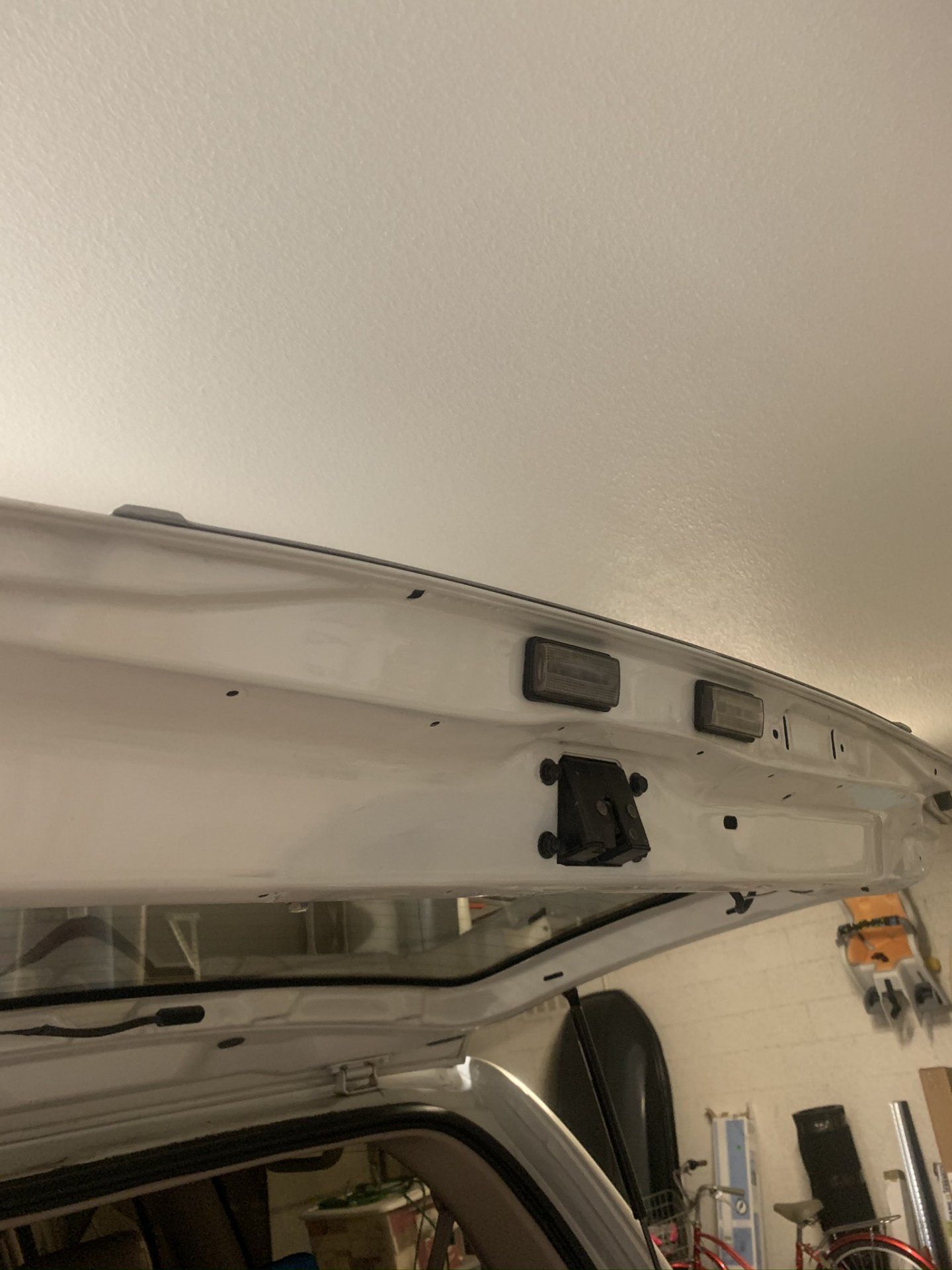

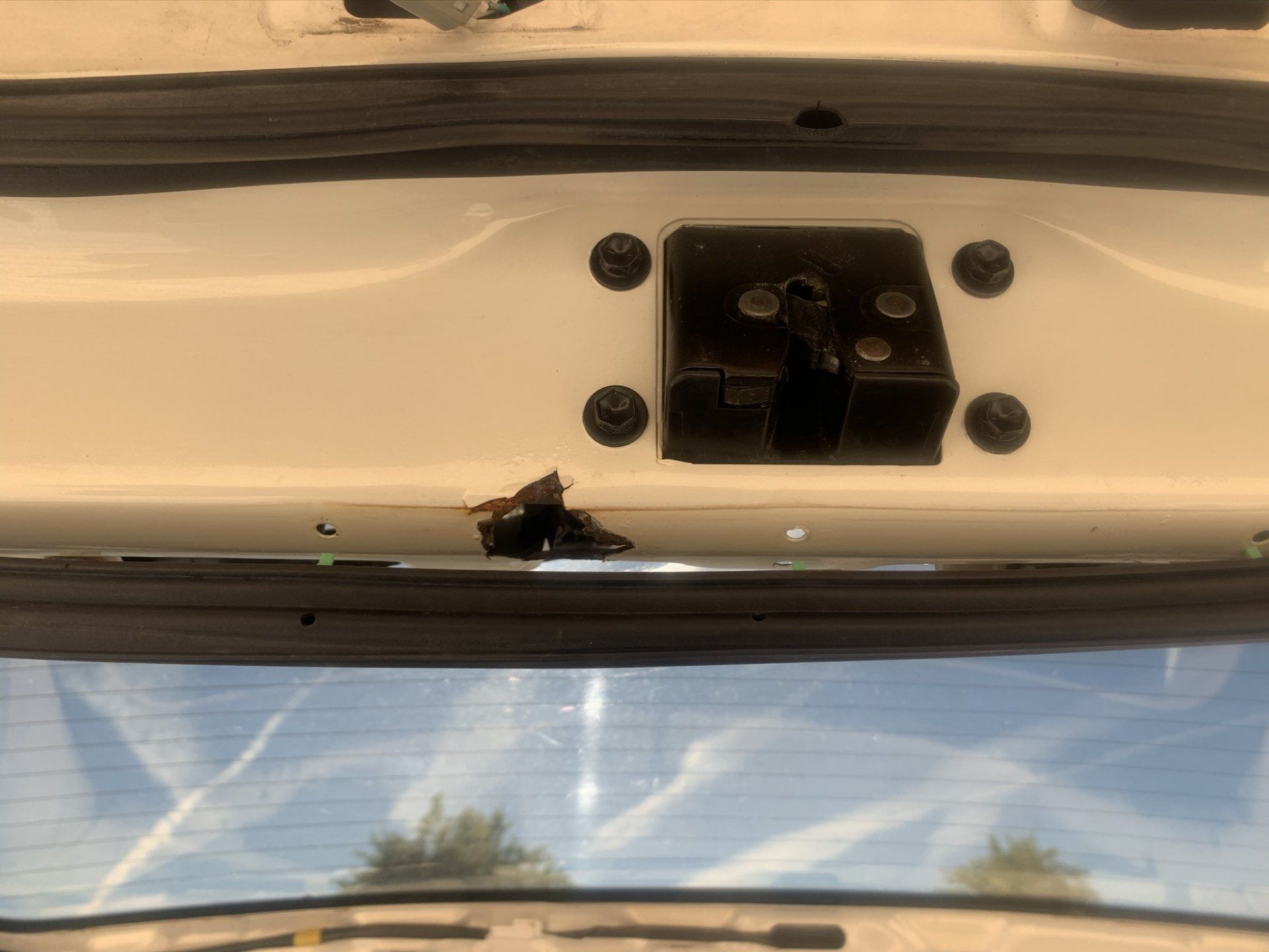

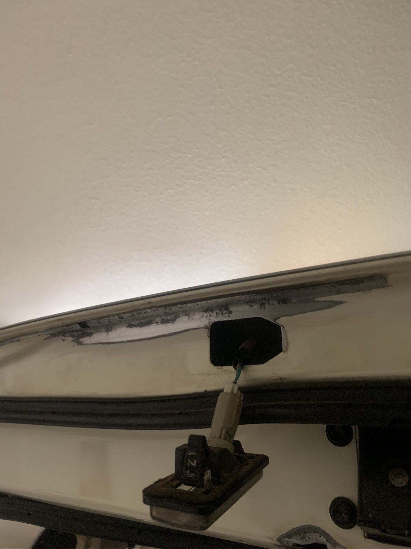

Tailgate Rust... How should I deal with it?

I had a similar issue and decided to tackle it myself. I ordered a new third brake light and did the silicone seal like others mentioned. All the tailgate work was wire brush primer and Bondo with a lot of sanding. The whole project took about a week because I work full time. For the time and effort it turned out just fine for me. As others have said if you want the problem gone get a new hitch. I was able to get to a point I didn't think it would spread further and didn't look too bad when I was done
the rust is only bad in 1 or 2 areas. if you are an avid diyer you can weld in patch panels (not hard at all just a little time consuming). my father and i replaced every single floor pan in his 96 jeep cherokee (you could see the highway below your feet). also eastwood makes a rust encapsulator that has a 3 foot hose with a 360 degree spray nozzle that you can feed up into the shell. this will stop the rust and prevent new rust from forming.
