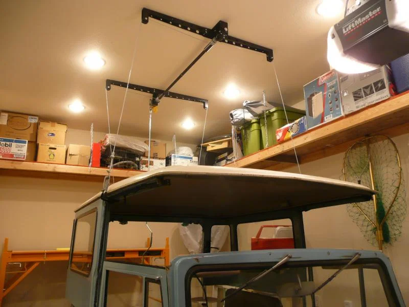

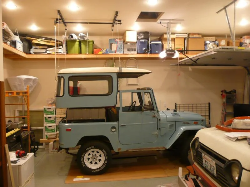

As the Charlotte weather slowly gets warmer, gets extremely cold, and then warms up again I am starting to think about ways to take off the top on the 'ole 40. Was thinking of installing a wench/lift on my garage ceiling similar to the one in the images attached from (FJ40 Hardtop Lift Storage System). Don't know if warp while driving around without the top on will affect the process of putting the top back on. Anyone know how serious of a problem that is if it is one at all? Anyways, might not get this done anytime soon, but hopefully I'll have an easy way to take the top off within the coming months.

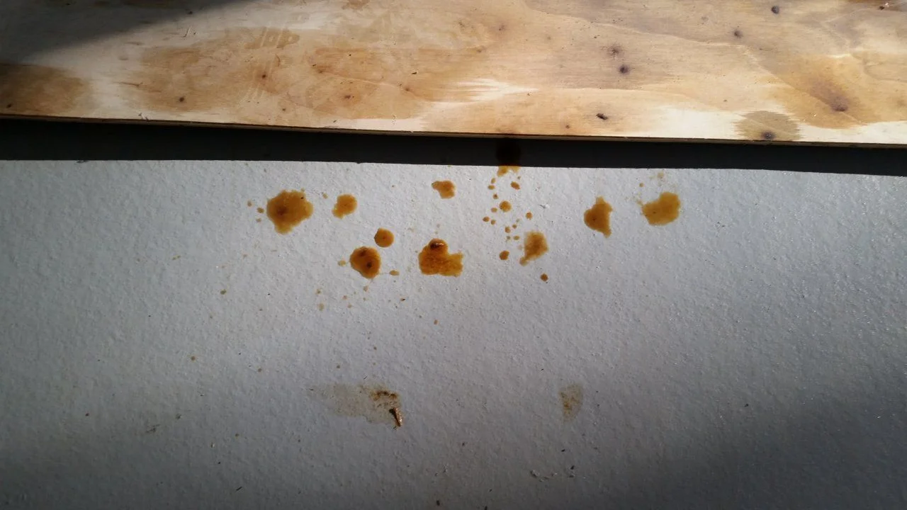

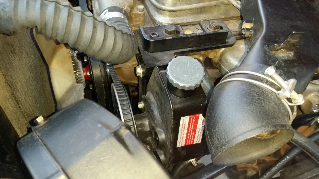

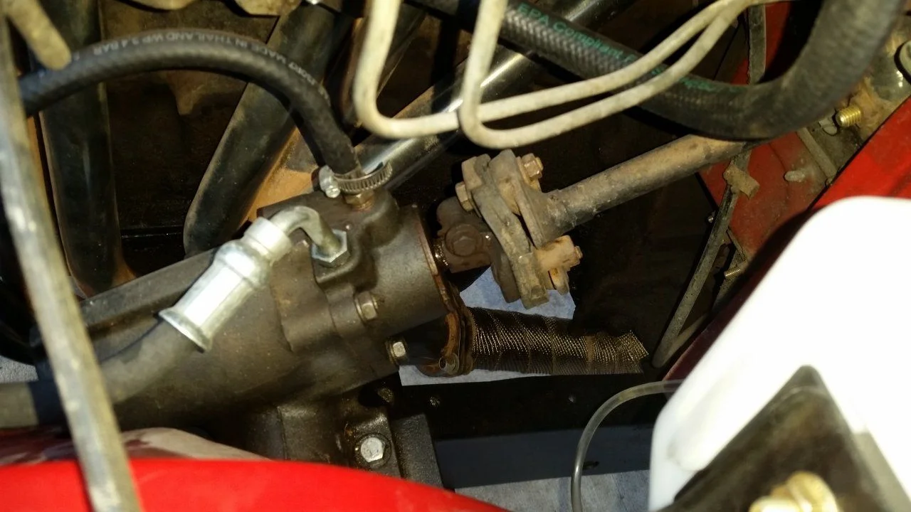

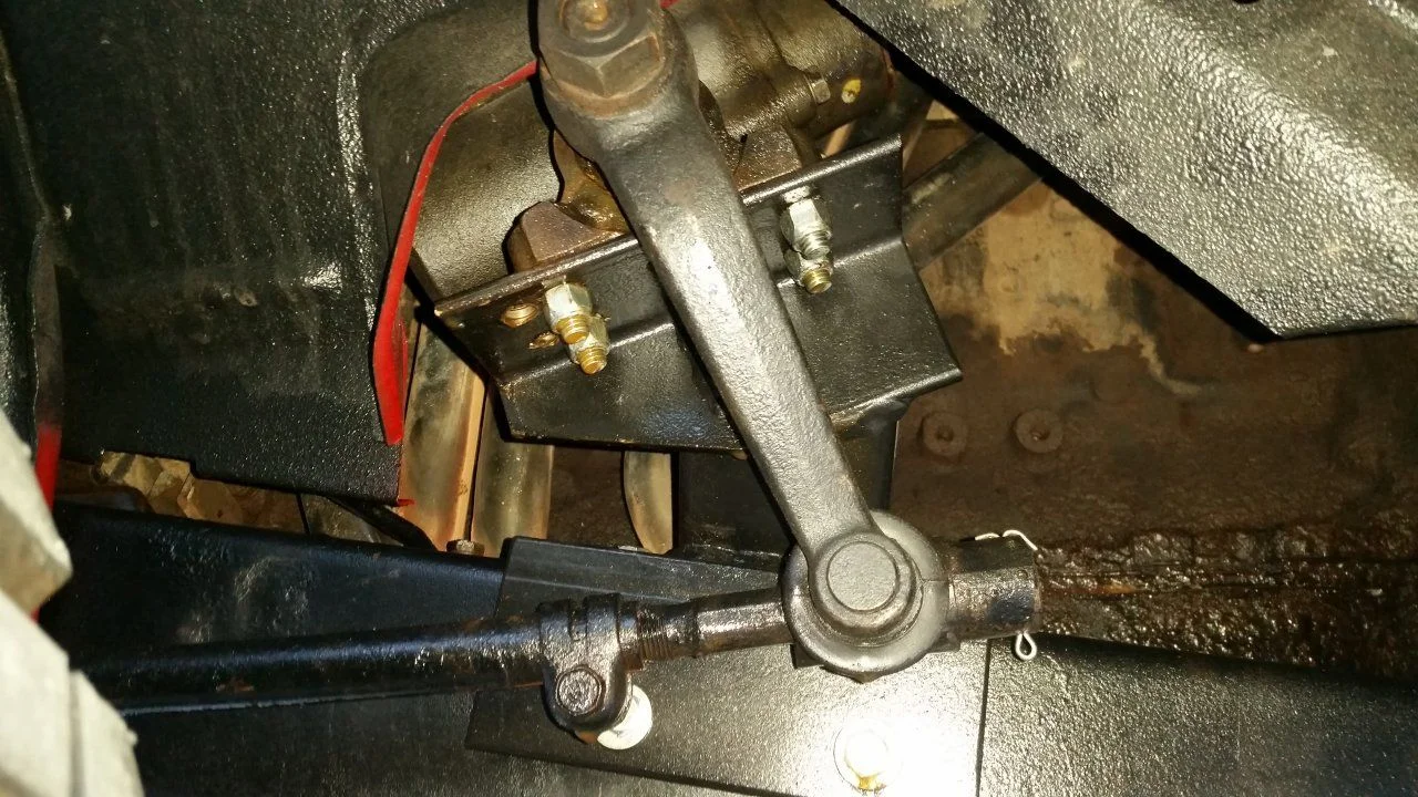

Other recent info: Trying to figure out if there is a particular reason I am leaking so much oil. I suspect that the Fram filter isn't doing a good job. There is also brown colored fluid dripping off of the steering column. I am guessing that is power steering fluid because it is not near any other oil leaks. There is a fair amount of fluid in small pools resting in flat spots under the engine (pics to come soon). About a month ago, while driving, my power steering fluid canister didn't have a bolt in and it completely tipped over spilling all of the fluid and also, due to being connected to the timing belt, stretched out the timing belt which was an easy fix, but now makes me worry about the brown fluid coming from the steering column. Any info would help. Thanks!
Definitely a nice pulley system, I'll have to look into something like this for my cruiser.
Pictures:
1. Liquid is resting right under timing belt
2. Steering column where I suspect brown liquid is coming from
3. Brown Liquid dripping off of steering stabilizer shaft (old man emu)
4. Brown liquid
5. Power steering fluid canister. No signs of leaks
