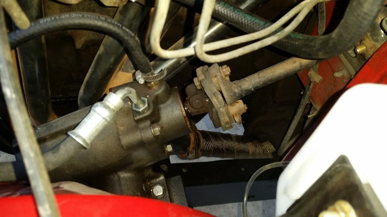

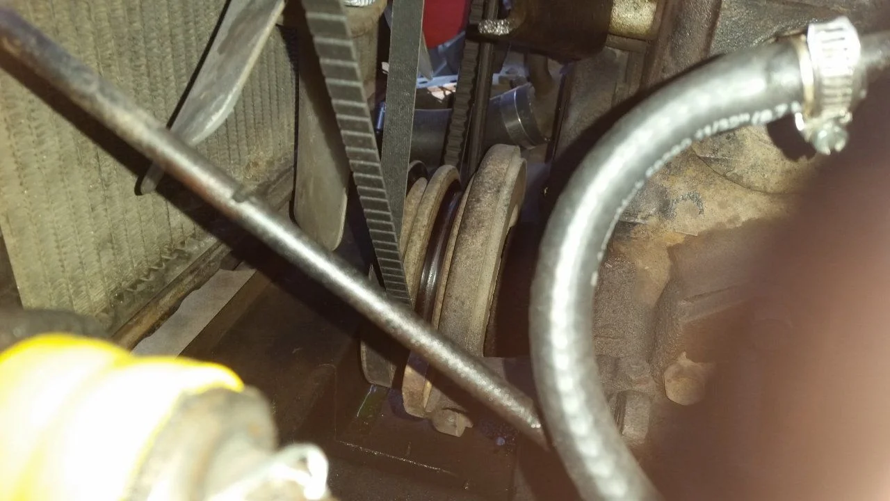

Rusty, I recommend the following; tighten all cooling hose clamps, under the water pump there's a weep hole check if it's leaking if it is it's time for a new waterpump, check radiator for leaks
20160306_162018-jpg.1220419
If PS fluid is coming from the PS gear box then it's most likely a bad seal, these units are re-buildable

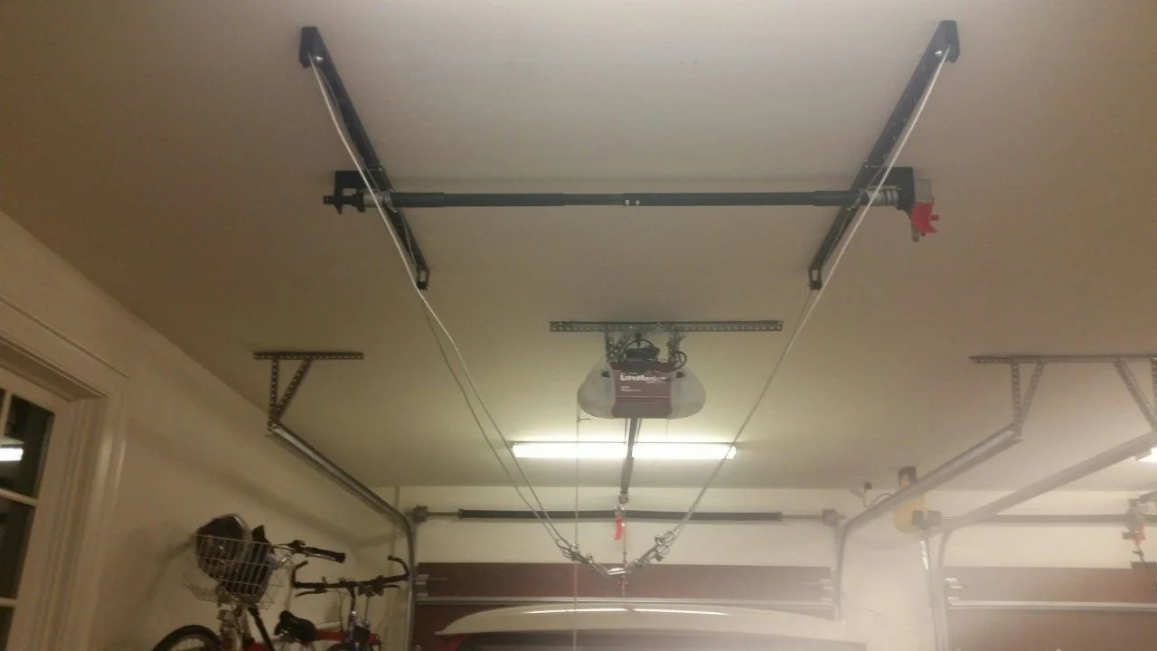

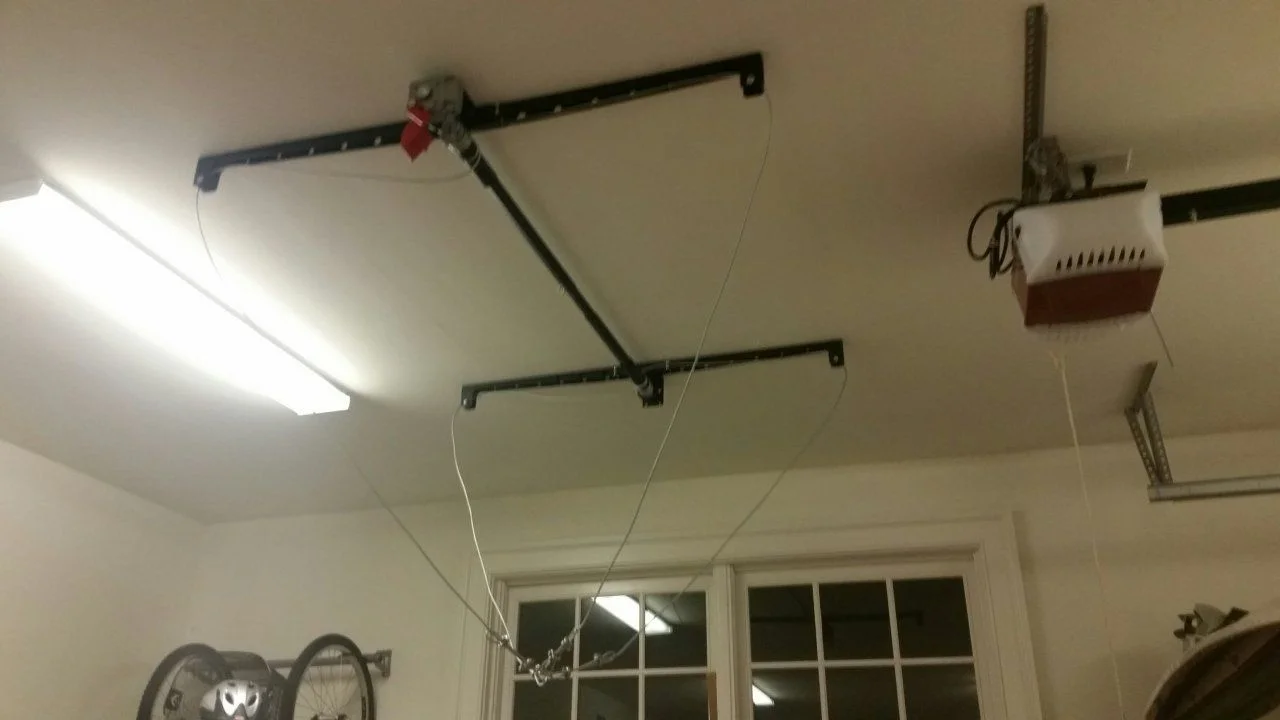

I didn't know I would get this close to done this fast, but it is getting pretty hot around Charlotte. I bought a racor system and have it setup in the garage. The U-hooks to grab under the top of the 40 should arrive shortly...
How tall is your ceiling?
As a point of clarification, that belt is just a drive belt, not a timing belt. The timing gears on your 2F are internal, under the timing cover on the front of the engine.
That first leak looked green like coolant. Would suspect a hose or water pump. If water pump would look to get it replaced sooner rather than later.

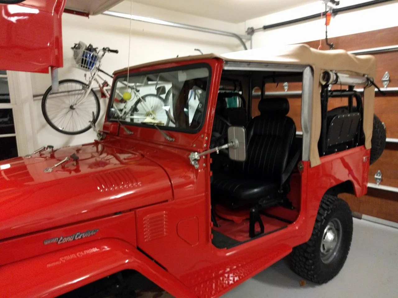

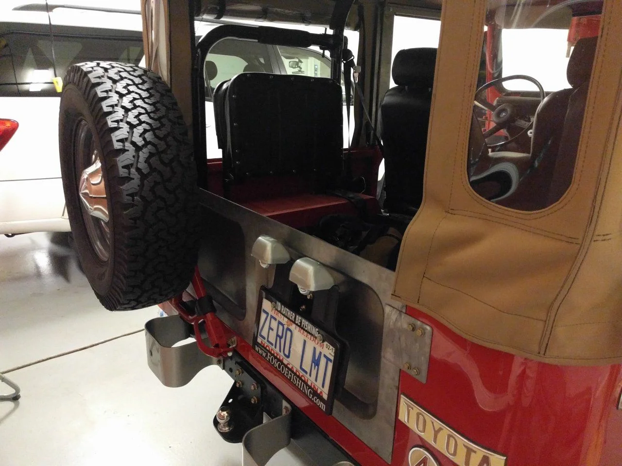

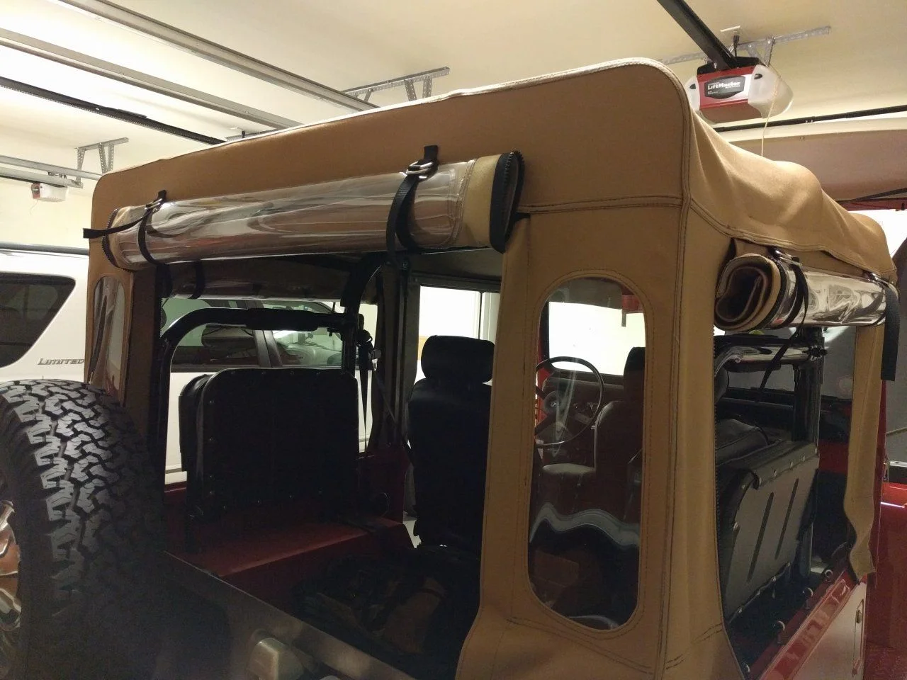

Latest addition... Trollhole soft top! still need to paint the bows and new tailgate. Wooden tailgate for sale here: For Sale: - Wooden Tailgate FJ40 NC/USA Better pictures to come once painted. Should be a near perfect rig after we get a new carburetor and get belts redone. Maybe a couple more months and it'll be in top shape! :steer:
Just a tip...roll the side windows to the inside versus the outside to prevent them from flapping around or catching air. Damn nice work on your 40. She looks great. Looks like you need a tool roll?
