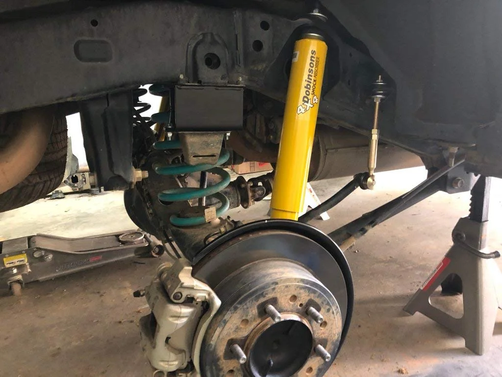

Moog makes a replacement as well as Dobinson. Mike Studts are well built and are disconnecting. That’s what I’ve run on the front of my FJ and now GX for more than 2 years.

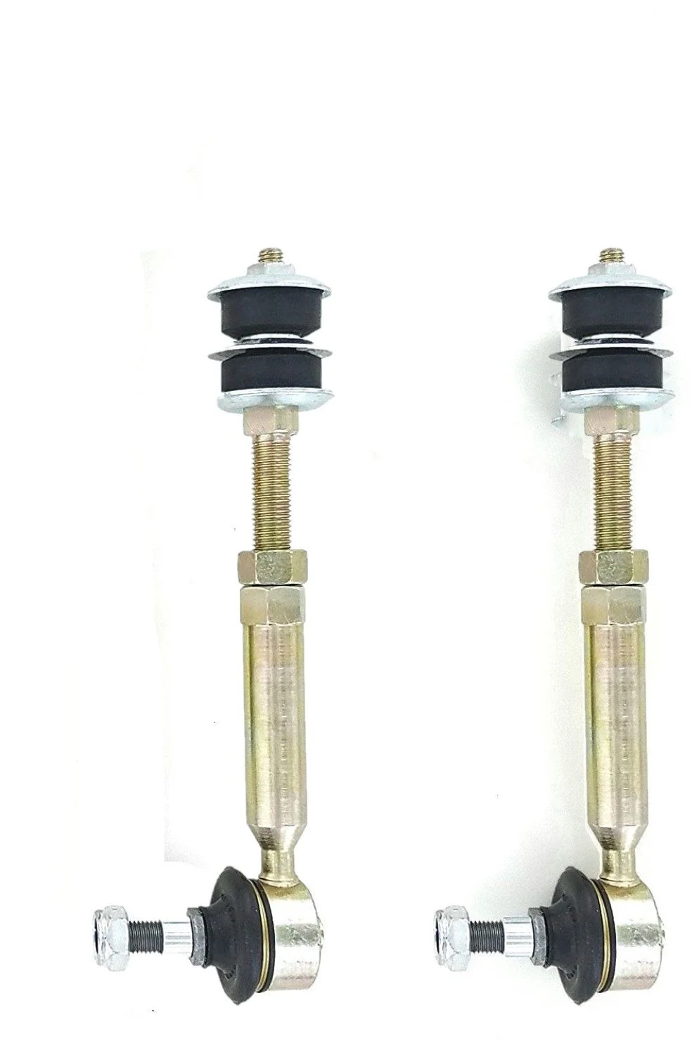

Here is a picture of ours. They are adjustable and feature oe style ball joint and rubber bushings. The links are gold zinc plated to prevent any rusting.
Cant wait to get around to doing mine, those look beefy!
