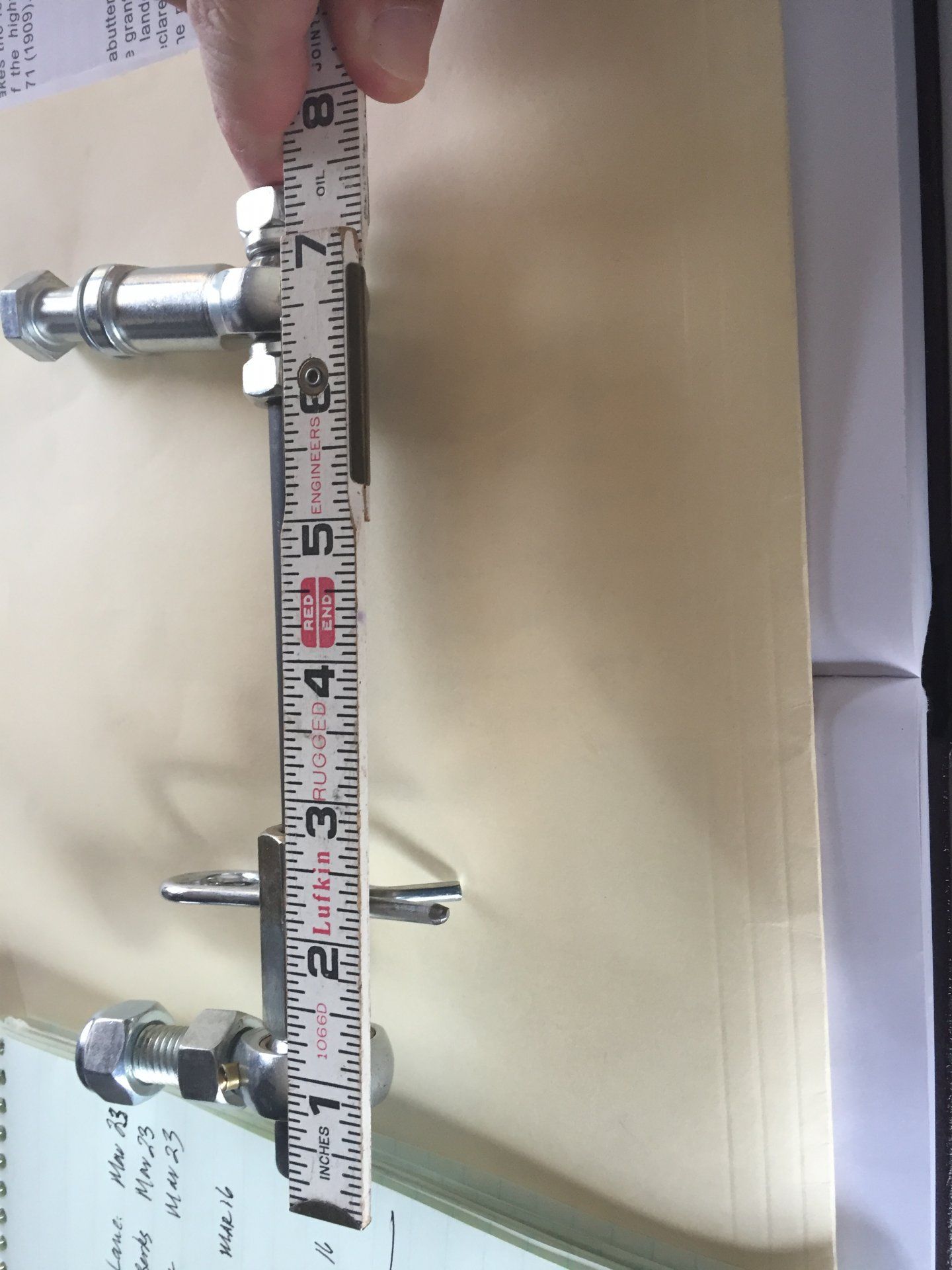

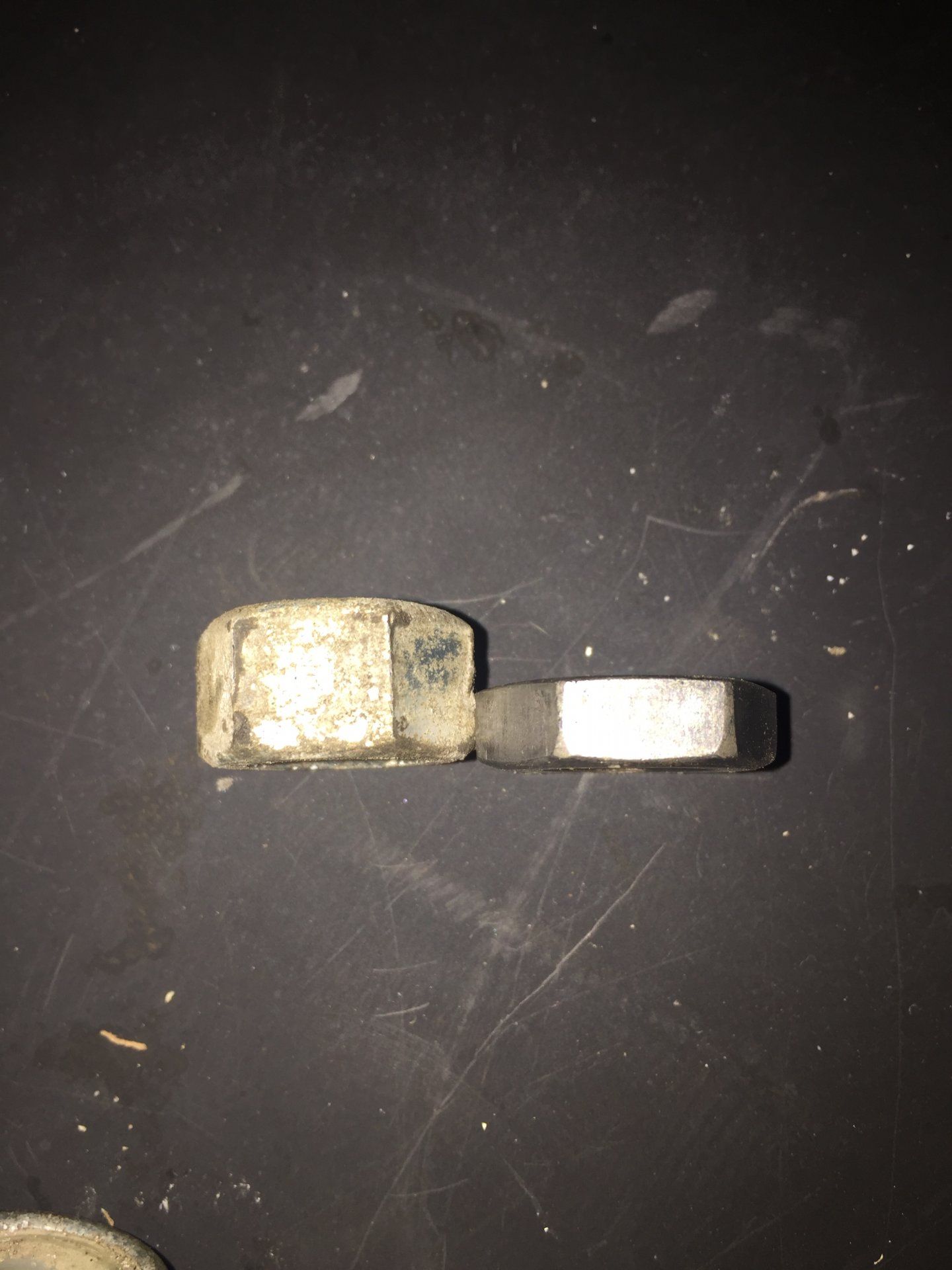

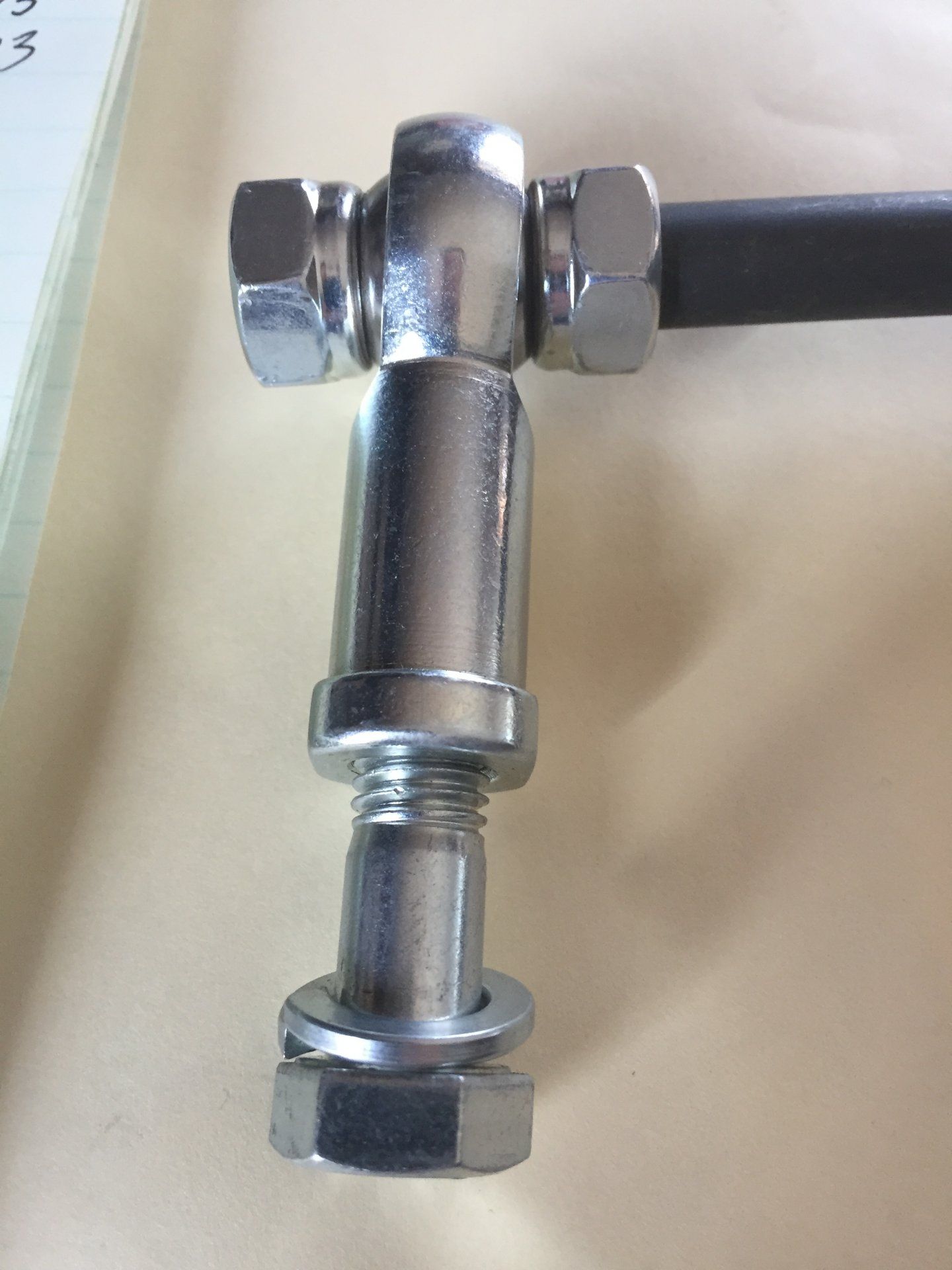

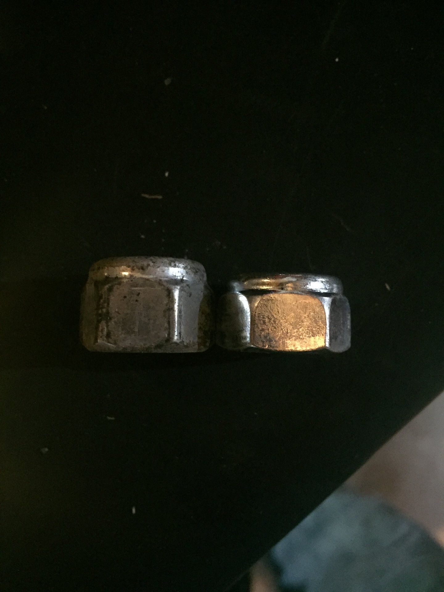

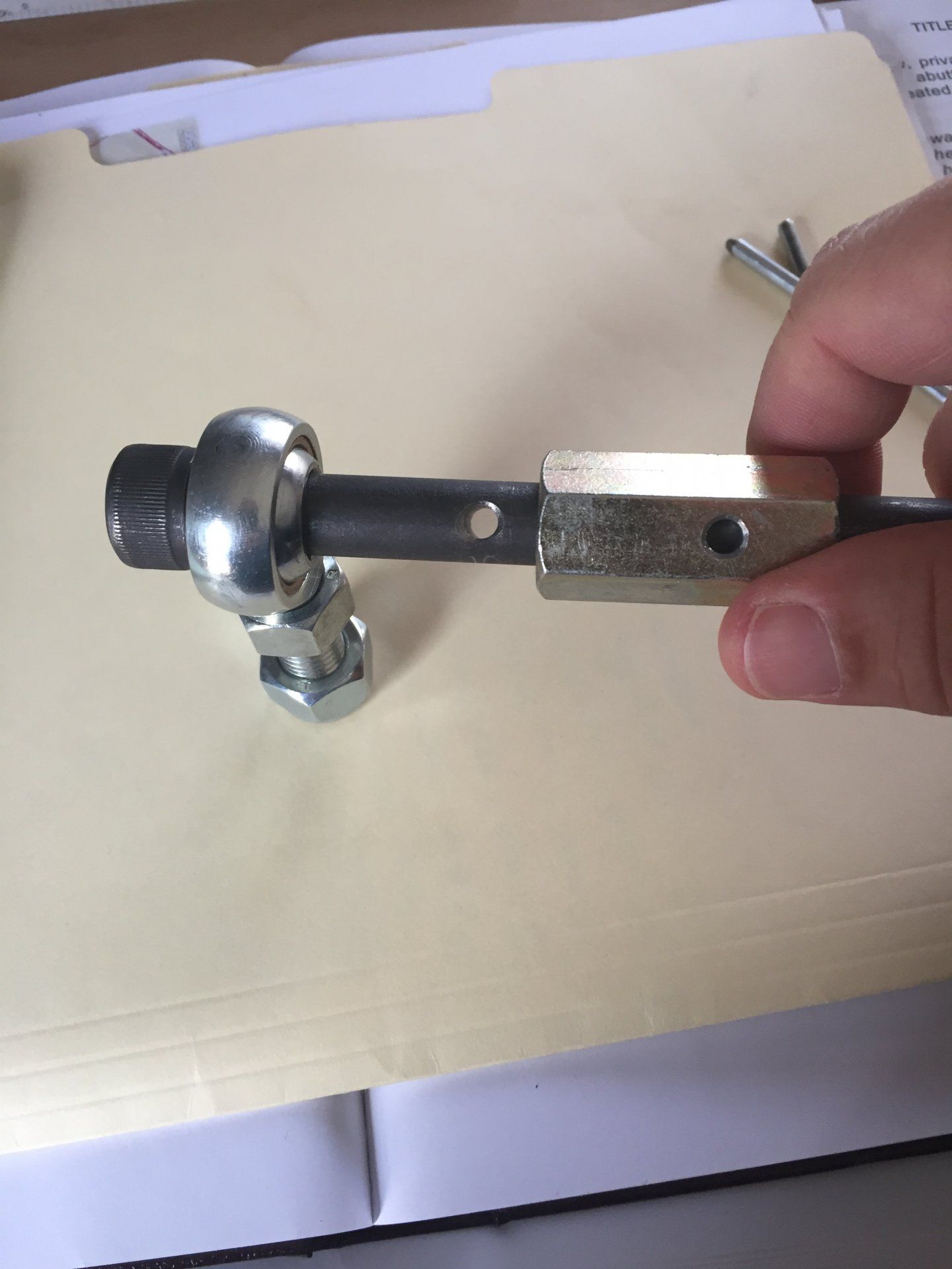

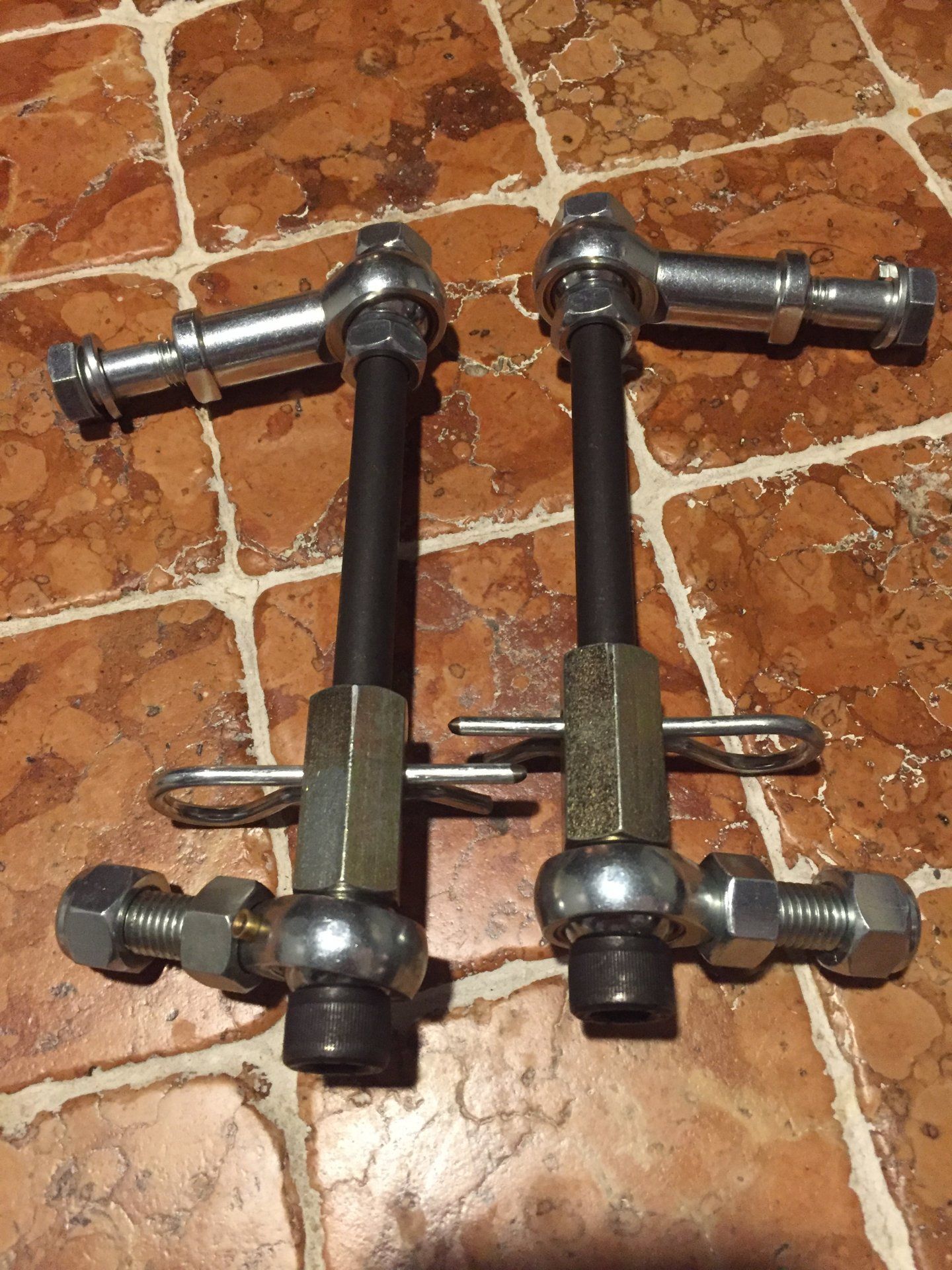

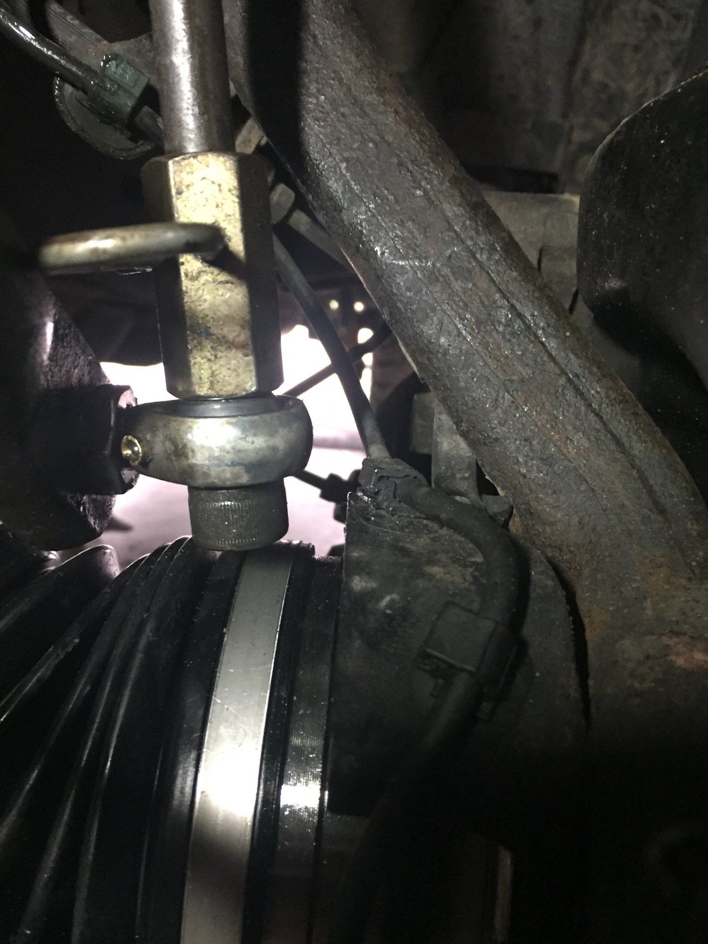

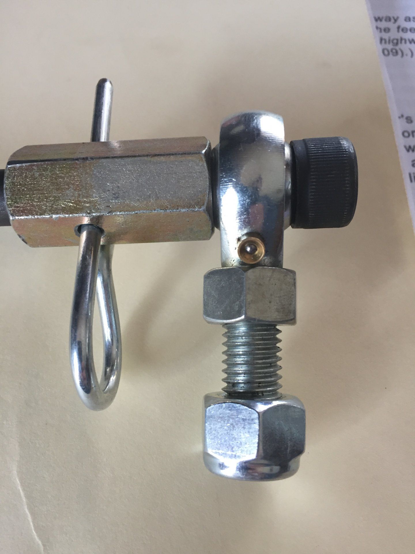

Mine came directly from BAZ. I ended up using a jam nut in order to get more thread purchase for the lower connection, lock tight and the Heims w/ boots seem to last longer. Again, I’m in the NE where everything rots prematurity. Another thing that I’m not sure was mentioned in that thread is they were were designed to be used in conjunction with the sway bar relocate kit. I initially didn’t have that and had some clearance/ alignment issues when they were disconnected and fully cycling the suspension.
first couple of pics were when I first got them.
The last few is a comparison of what BAZ sent and What I reduced the locking nut and jam nut to. It’s been awhile but I’m pretty confident we determined there was a difference in sway bar thickness between 07-09 FJs and 10-14. 07-09 being thicker. Probably the same between the 120 and 150 platform but can’t say for sure.

I picked up the jam nuts and shorter lock nuts at Fastenal.
I never had an issue with them backing off after going that route.

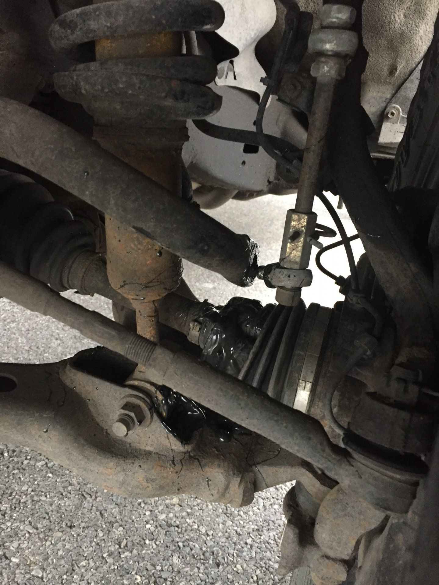

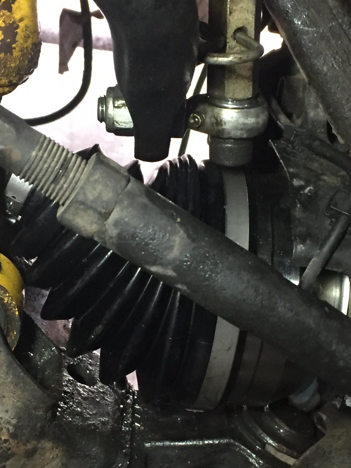

You lose a CV when they fail. That is what lead me down the path of modifying the hardware. They do work very well, connecting and disconnecting is simple but they do need to be maintained or they get loud.
When a nut backs out, sway bar starts chew into CV
damage. Luckily I caught it immediately
New hardware with better thread purchase.
