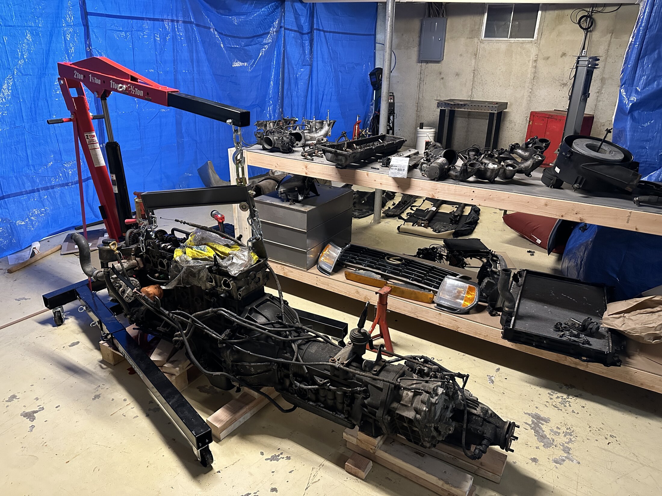

I can’t be much help for your questions but I sure can help with motivation. Let’s see some pictures of your vehicle and parts if you have them. Excited to see this project start!

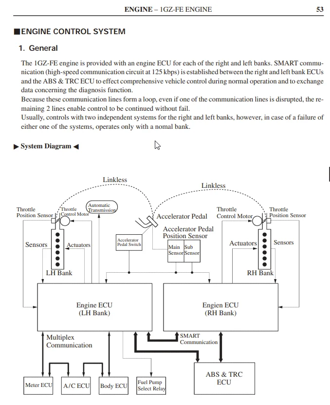

That motor has two harnesses right, one for one bank one for the other? Like two in line six motors running together, as opposed to a single v12 engine control.

You are correct, the motor has two completely separate ECUs that are nearly identical. The intent from Toyota was to maintain operation in the event of a single computer failure. See attached excerpt from the manuals I do have.

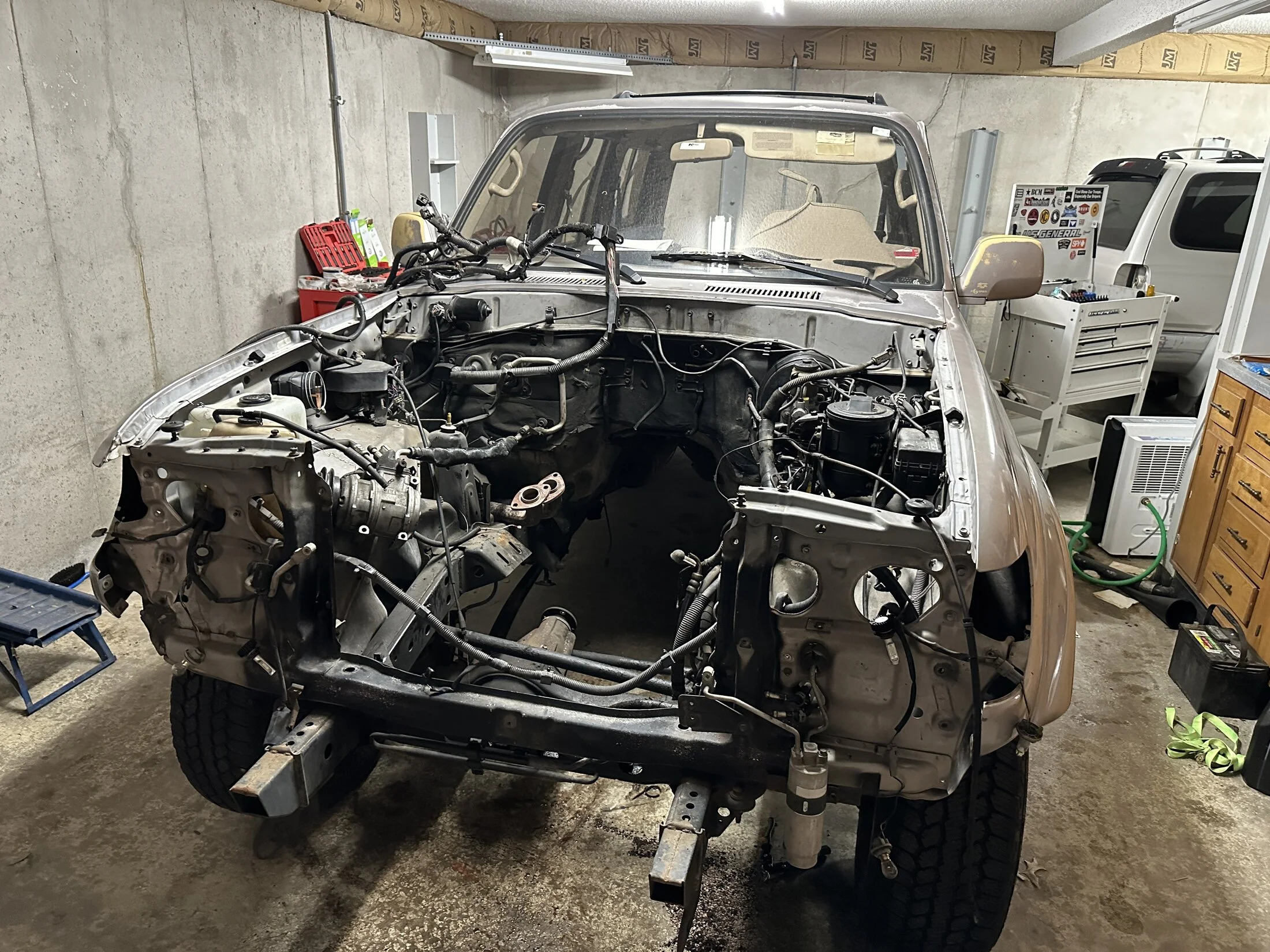

Drivetrain is out and ready for the V12. Unfortunately, my New Zealand contact who claims to have got a couple running on the floor has not answered my emails. Still looking for a Japanese contact to help out.

Dream isn't dead, but it is on hold. Work has me potentially relocating to a remote area this spring, so we got to get the cruiser driving again. A new 1FZ is going back in it for now. Understandably, the service manuals are hard to come by. I might even be willing to roll the dice on a Japanese one and see if I can get some fancy tech to translate it.
