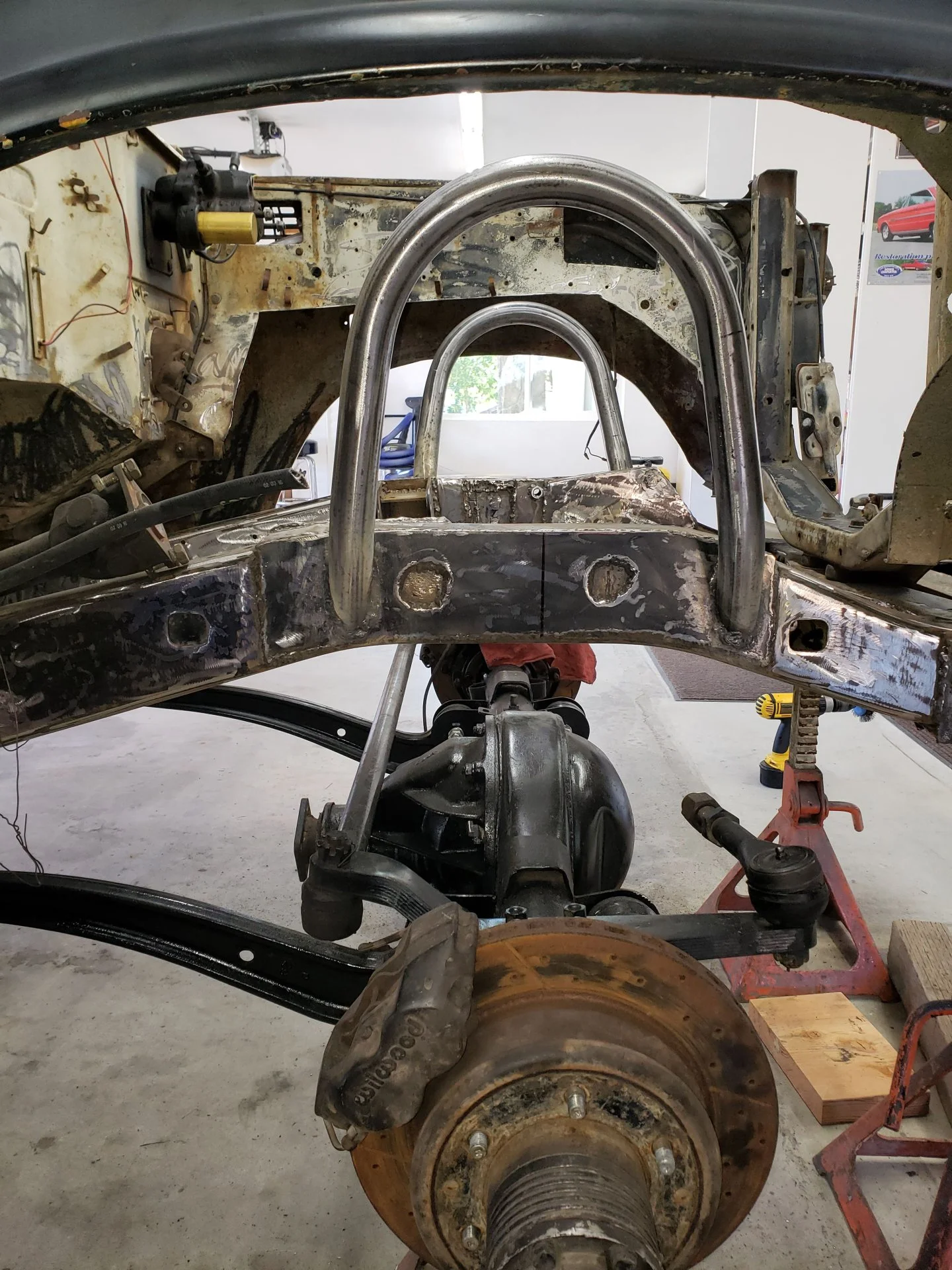

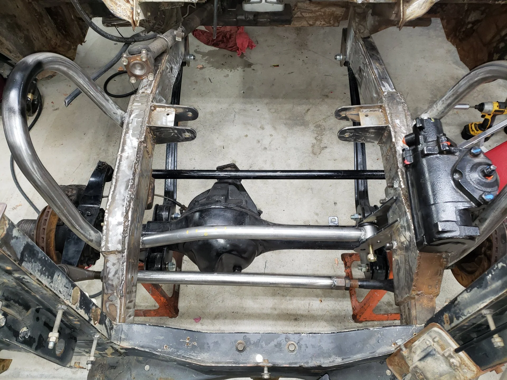

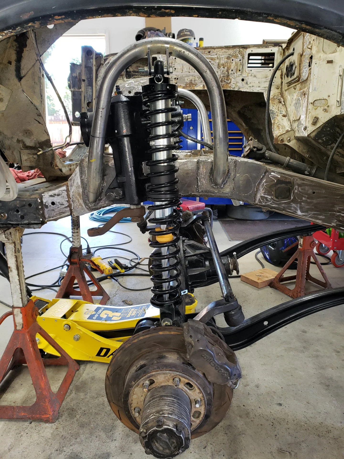

Yup a few now, some done & sold others underway.
Browse through the builds...
