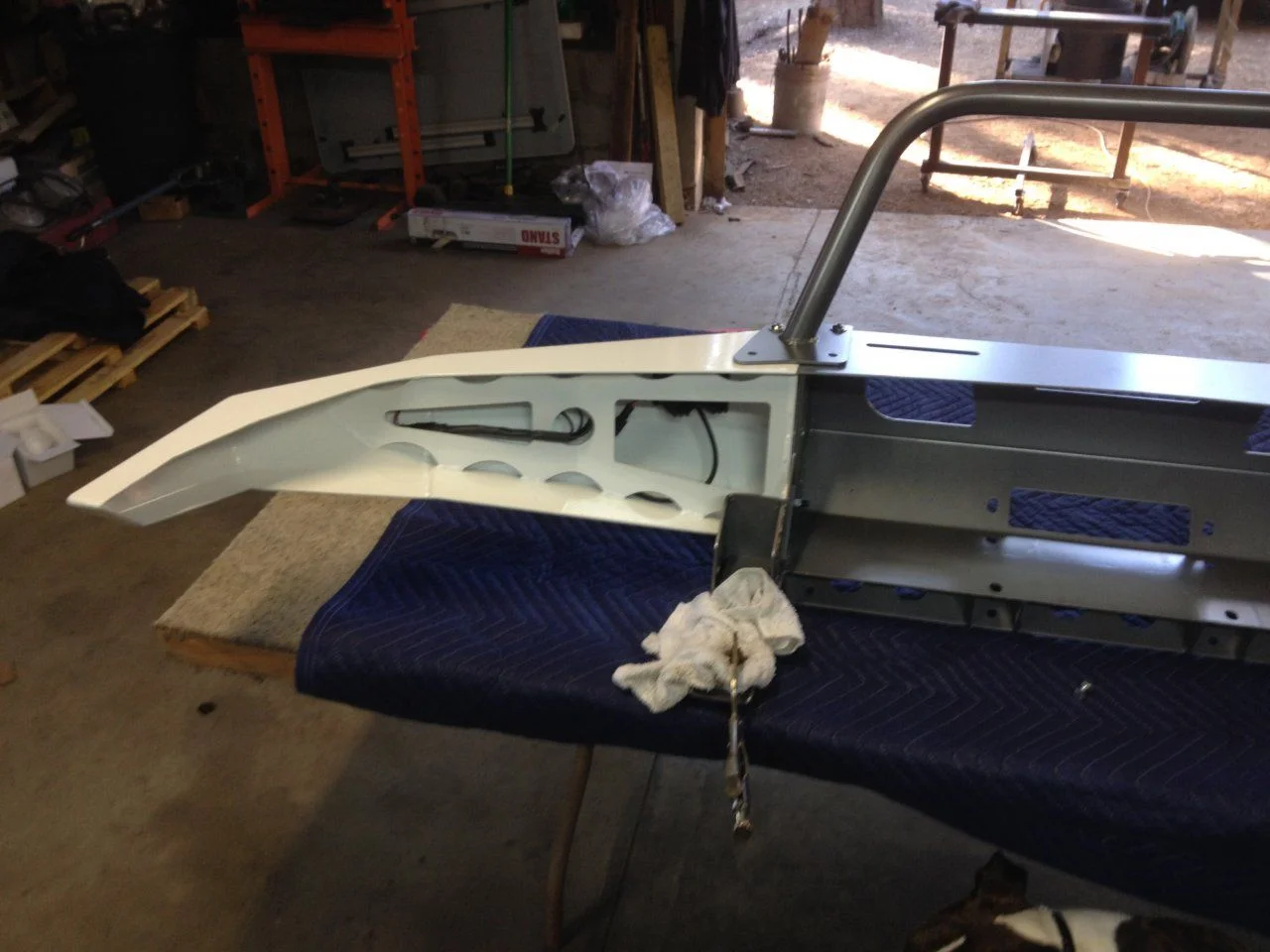

Here's a pic of the internal wing gusset.
The full bar will add a bit of strength to the wings as well.

I put a lot of time into the design of my bumper to save weight yet not compromise in strength. Anywhere I could cut out metal I did and added gussets where needed. The dissent bumper weight is about 85lbs without bull bar and 115lbs with full bar, after the removal of the factory bumper and bumper cover you are only adding 55-85 lbs to the front and will have little to no effect on the front suspension.

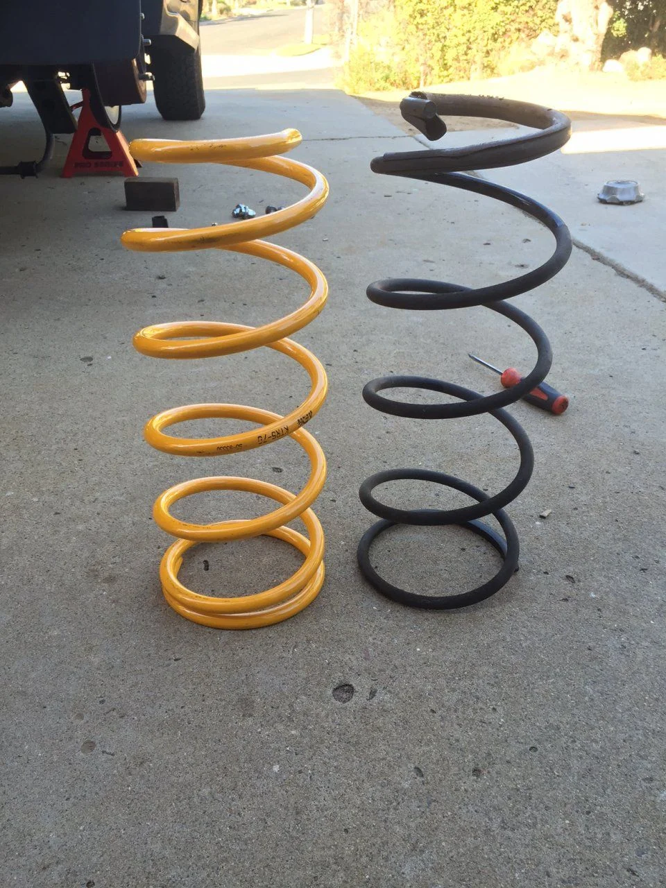

I wrote a long story on IH8MUD about my spring choices which can be found here -- it may be of interest. Nearly a year later I have no regrets about my choice of KING KTRS-79 springs with AHC -- but it is 'horses for courses' and it all depends on what you want your vehicle to do, where you want to take it and what loads it will be expected to carry ....
