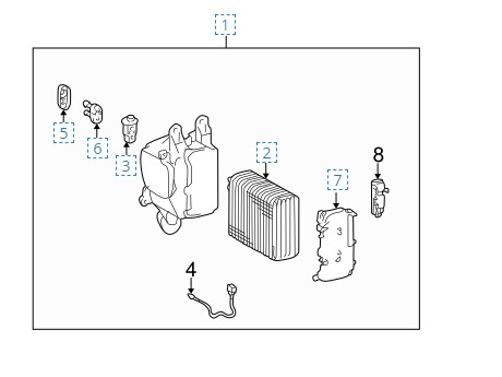

I have searched the site and think I have narrowed down my issue to the AC EVAP and maybe the expansion valve.
Symptoms:
Water leaking from behind the sound deadening black rubber material.
water drips bad from under the truck after driving on dry roads while running the AC.
Items checked:
Sun roof drains are clear and flow correctly.
windshield was checked.
Water is not coming from the seal on the front of the EVAP cannister.
What are some of your guys thoughts? Should I check something different?
Can you replace replace the EVAP core and expansion valve without removing the entire dash? I saw where you can cut that lower piece and get the core out, just not sure if you can get to the expansion valve or not as well.
Thank you.
I have an 04 Land Cruiser if that helps.

I understand there is a drain for the condenser that drains under the car and that is normal, but water leaking inside the passenger floor board is not normal and that is what I am dealing with.
The drain is not clogged for the AC, water drips out of there.

Water is not coming from that location, it is coming from the back side of where the EVAP core is. It is leaking behind the sound deadening on the firewall and under the carpet. Not on top of the carpet where the seal you are referencing would leak.
