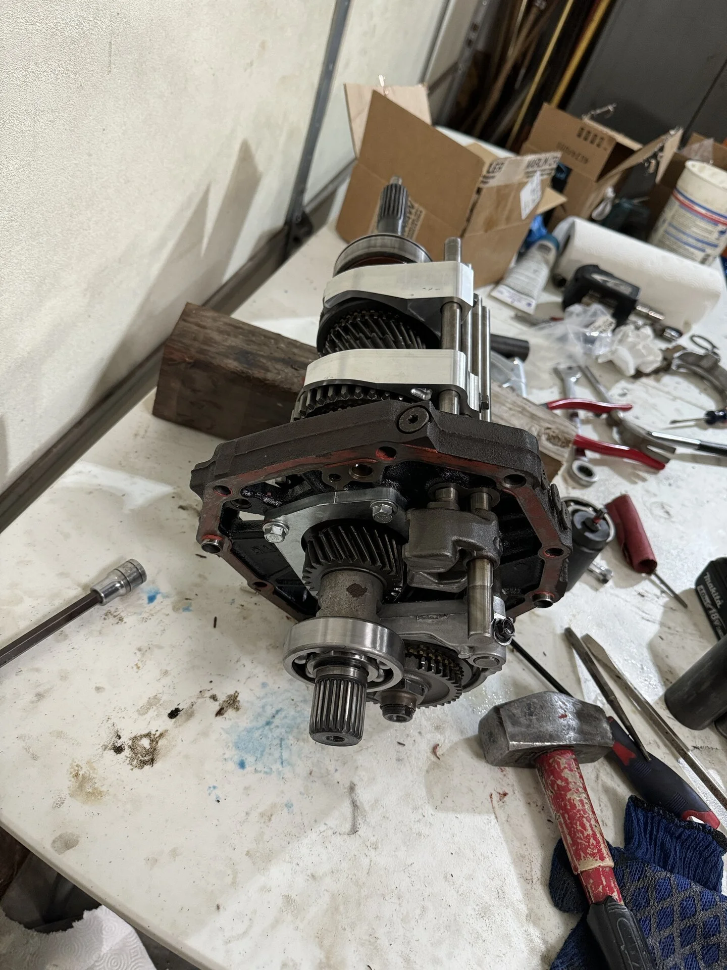

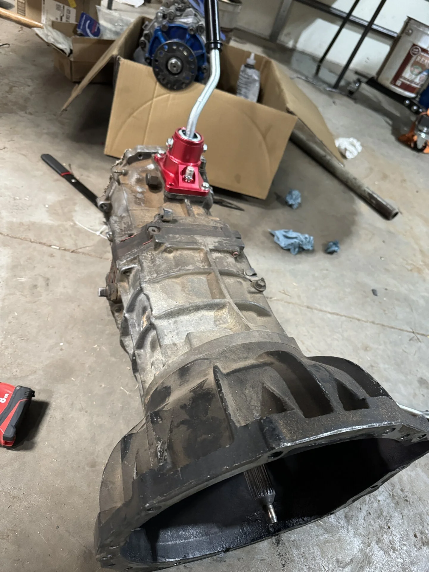

Rebuilding the trans that was in storage
New marlin thrust washer (recommended for builds with 300+ ft/lbs of torque)
New bearing retainer as well

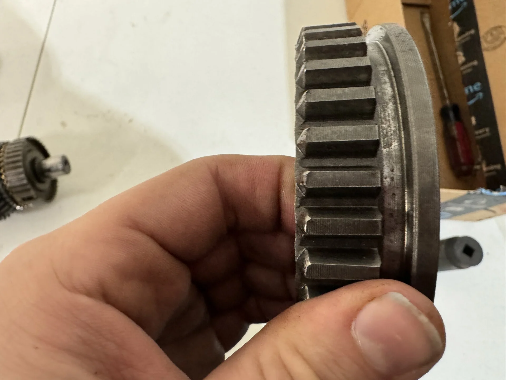

The 1/2 gear slider is also reverse on these and the teeth are awful so I’m ordering a new one of those as well.
We will see if all this work fixes the noises

Honestly manual transmission was fairly easy to put together obviously a few more moving parts and some special tools but hey I’m excited

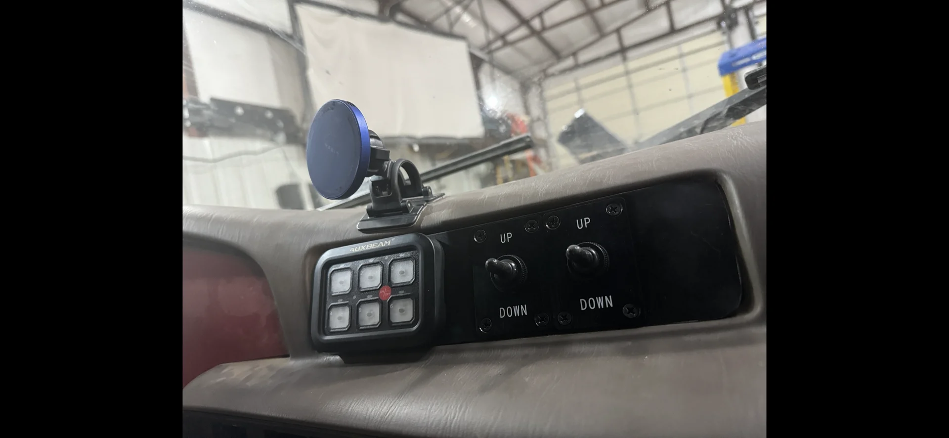

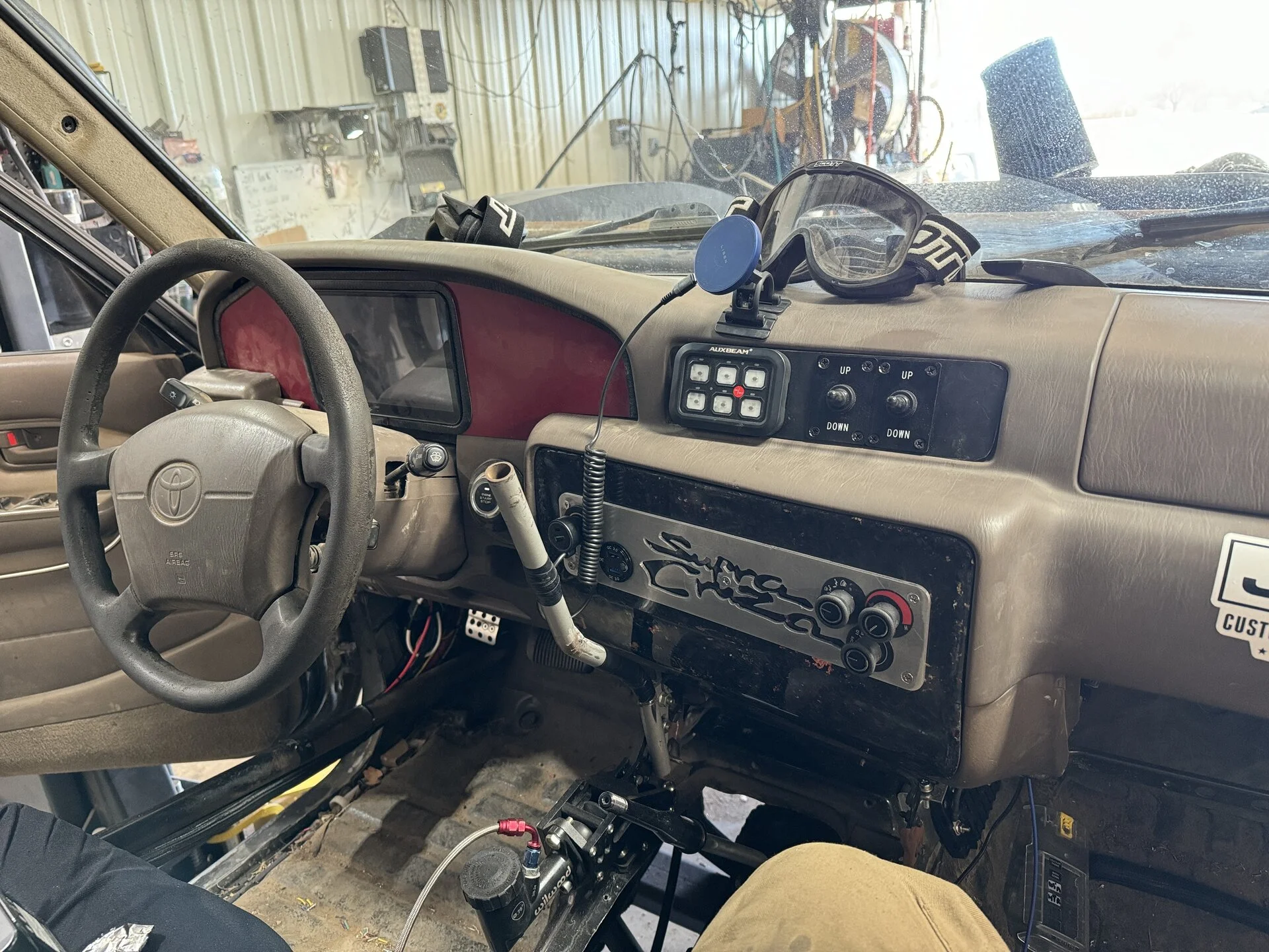

Creature comforts

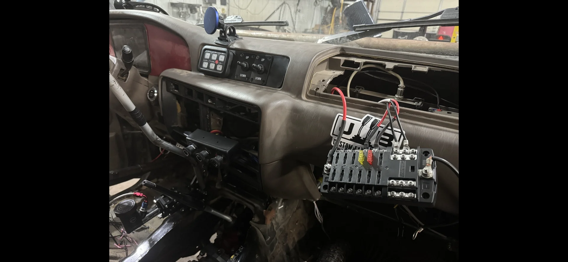

Working windows
Switch panel from Auxbeam

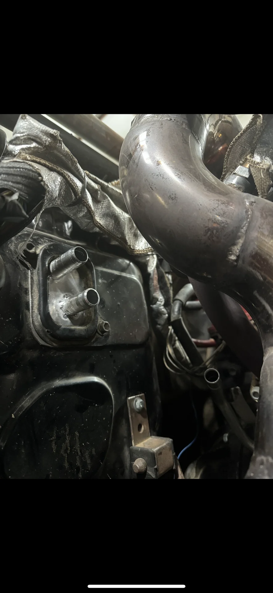

Heat and defroster from vintage air

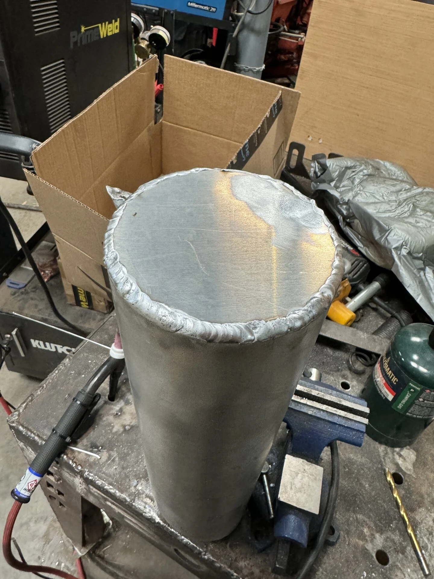

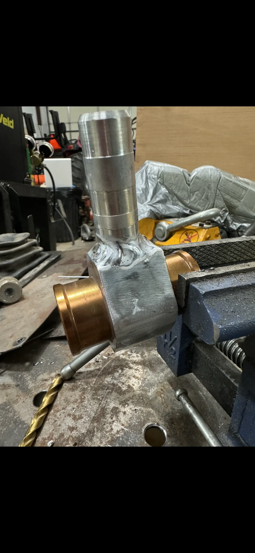

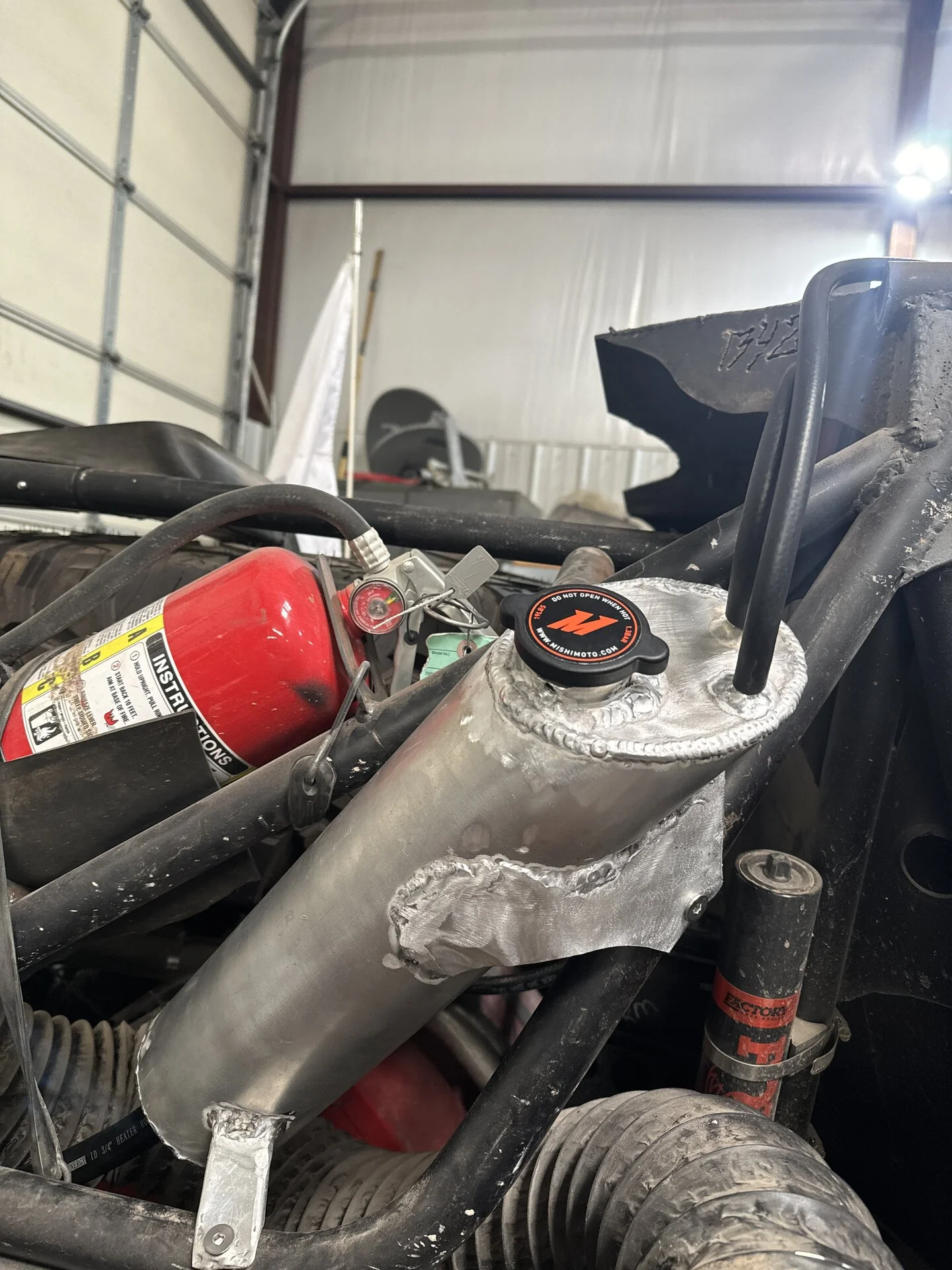

almost tolerable aluminum welds
In my defense I have no idea what I’m doing
Pro welders close your eyes the engineer is behind the helmet😂
It held 50psi. I hid far away from it.
Radiator expansion tank
Top 2 go to the top of the radiator and the top of the engine
Bottom goes to the inlet of the radiator
Should auto burp the system. Also shouldn’t need an overflow, we will see.

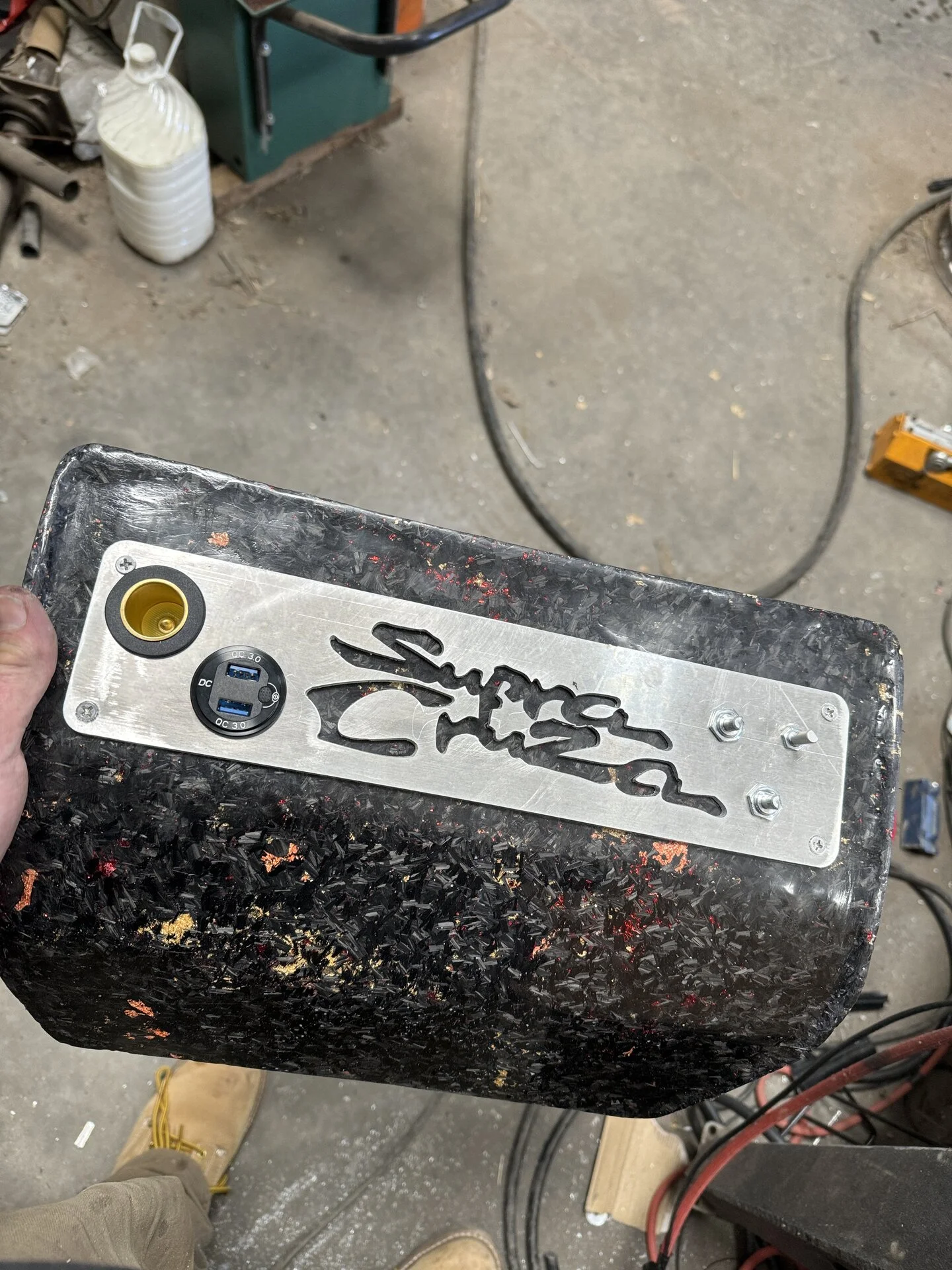

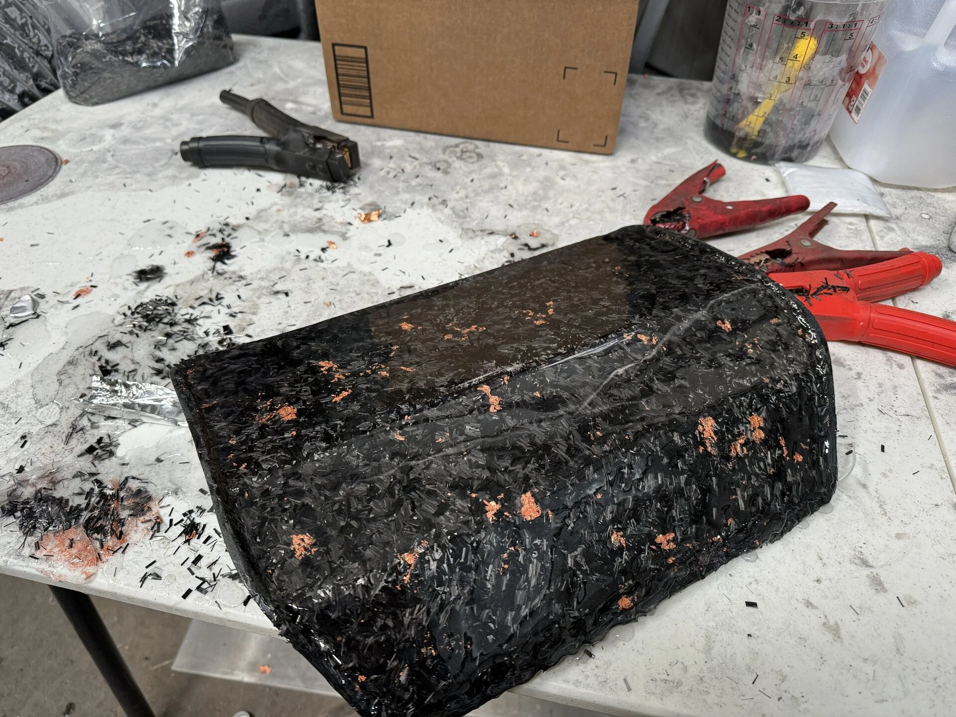

Also doing some CF over cardboard tape and paint
Who would know, I will, it will be hilarious
Well now that I have spent over a week on a piece of plastic I think I know how to do it more correctly
Don't feel bad, I don't think I've ever made anything right the first time.
Except mistakes, I've made those flawlessly right outta the gate.... 😆
Lots of those in this thread 😂
Finally done

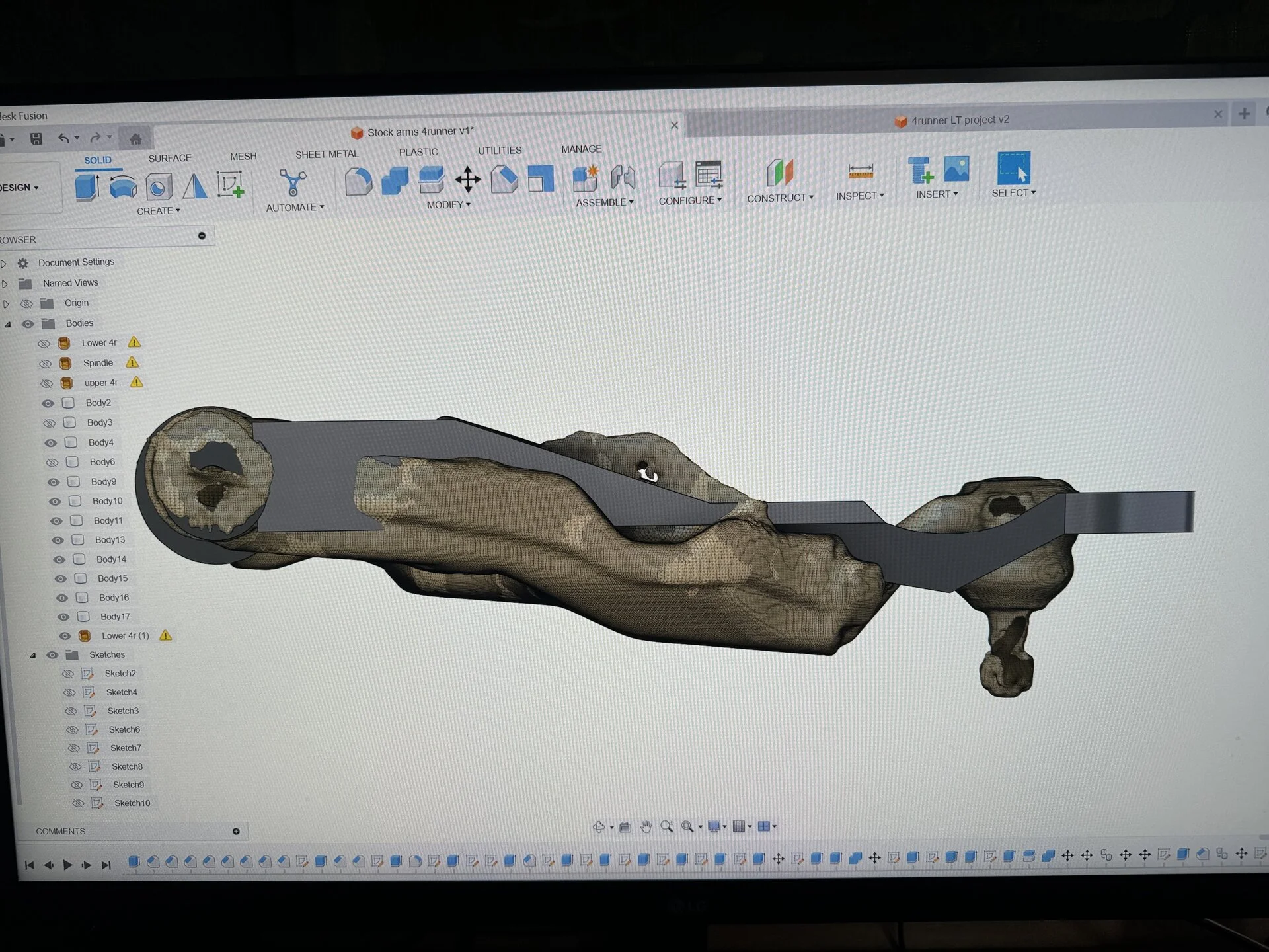

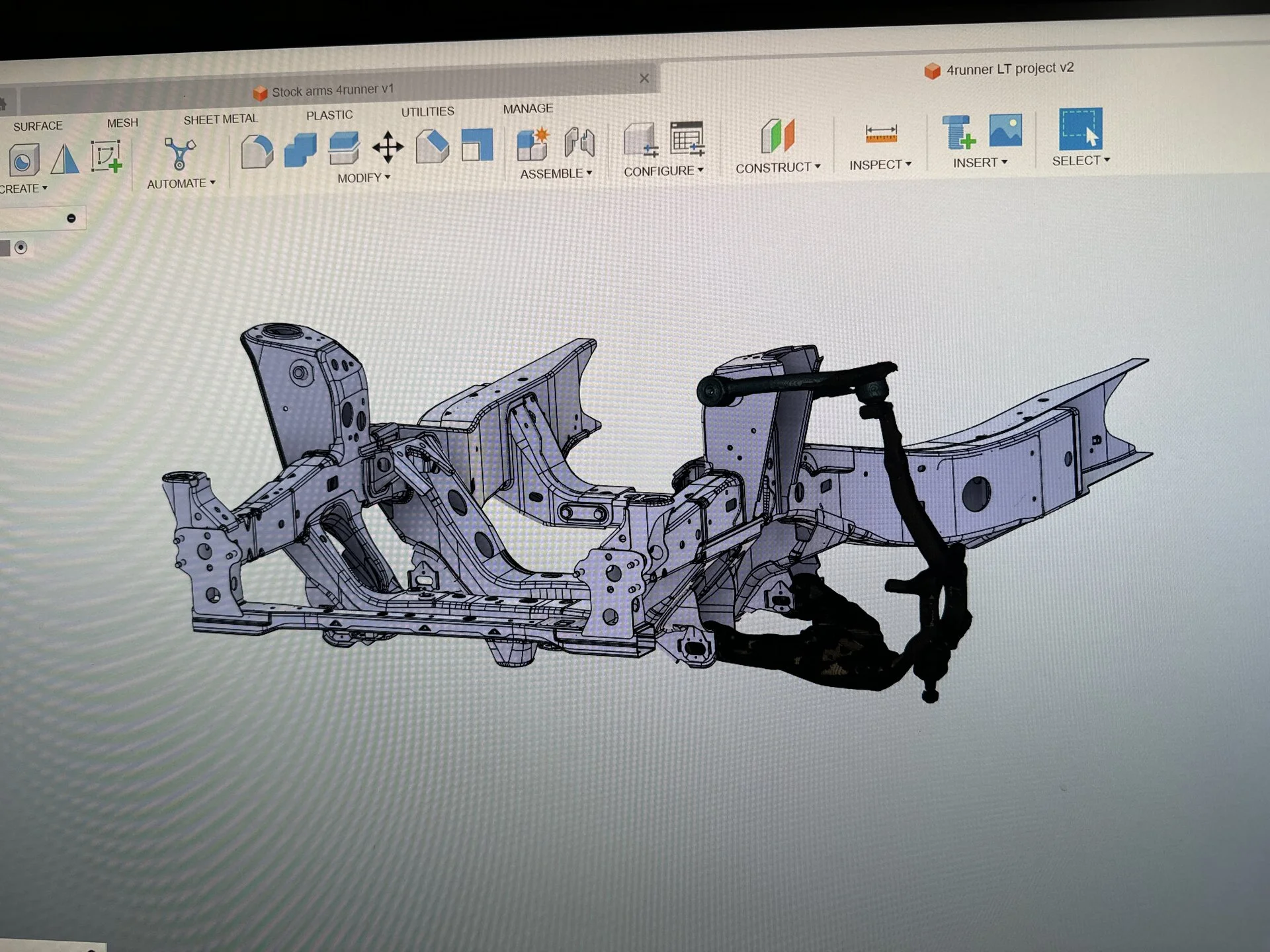

Also for those interested I’m making some long travel for the 4runner.
