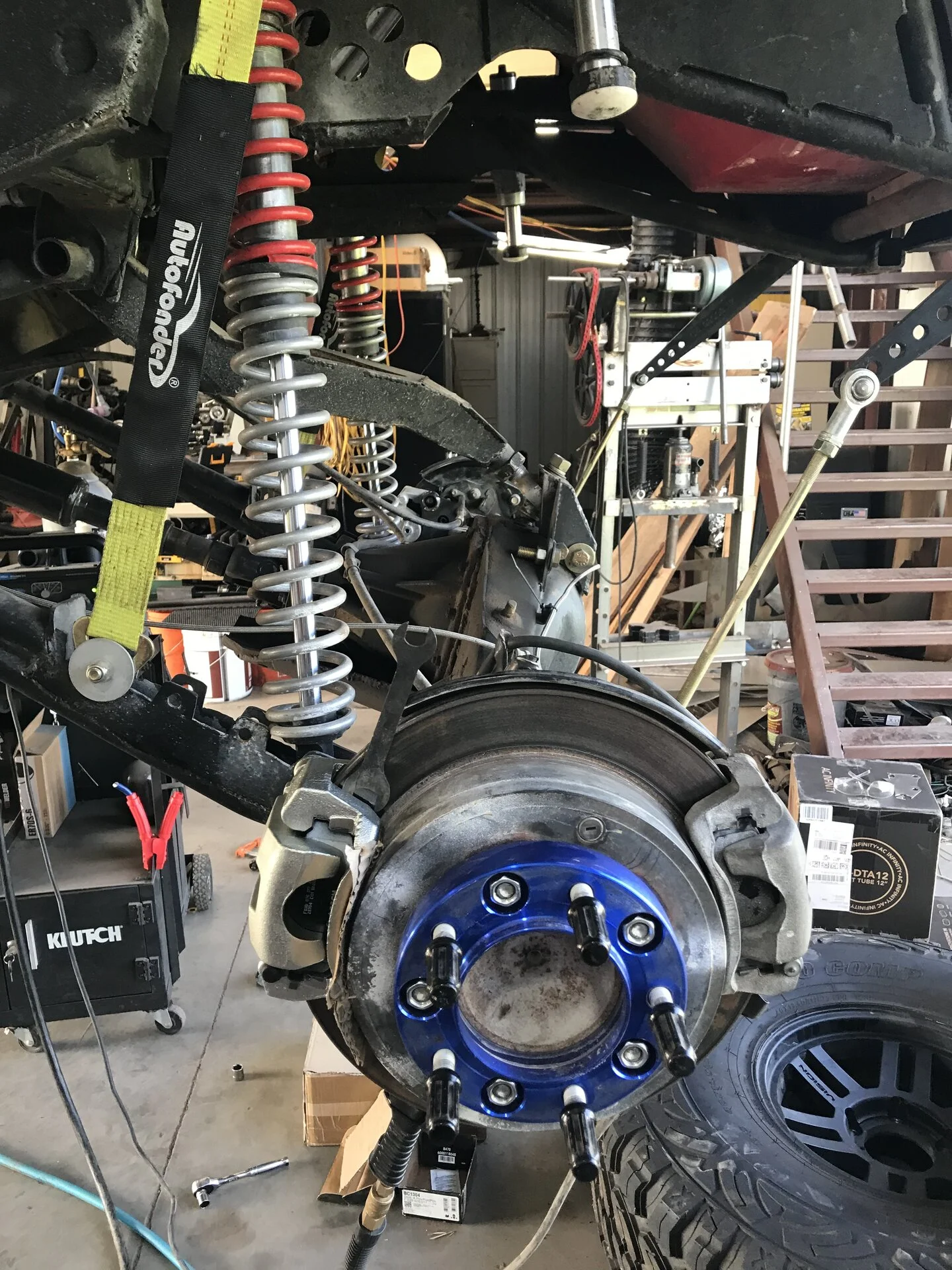

Updates. Just going to order some shafts
Hopefully I found the grinding noise
Went ahead and did both sides.

Axle shafts have been ordered
Will have to do a little machining on my end but no big deal
fj40 axles 28” and some change long have 4.75” splines on one side so I can easily take off 2” and run them
The fit on these aftermarket tundra cv axle stars to the reg Toyota 30 spline is close enough for now
I’d recon the joint to explode before the splines give out.

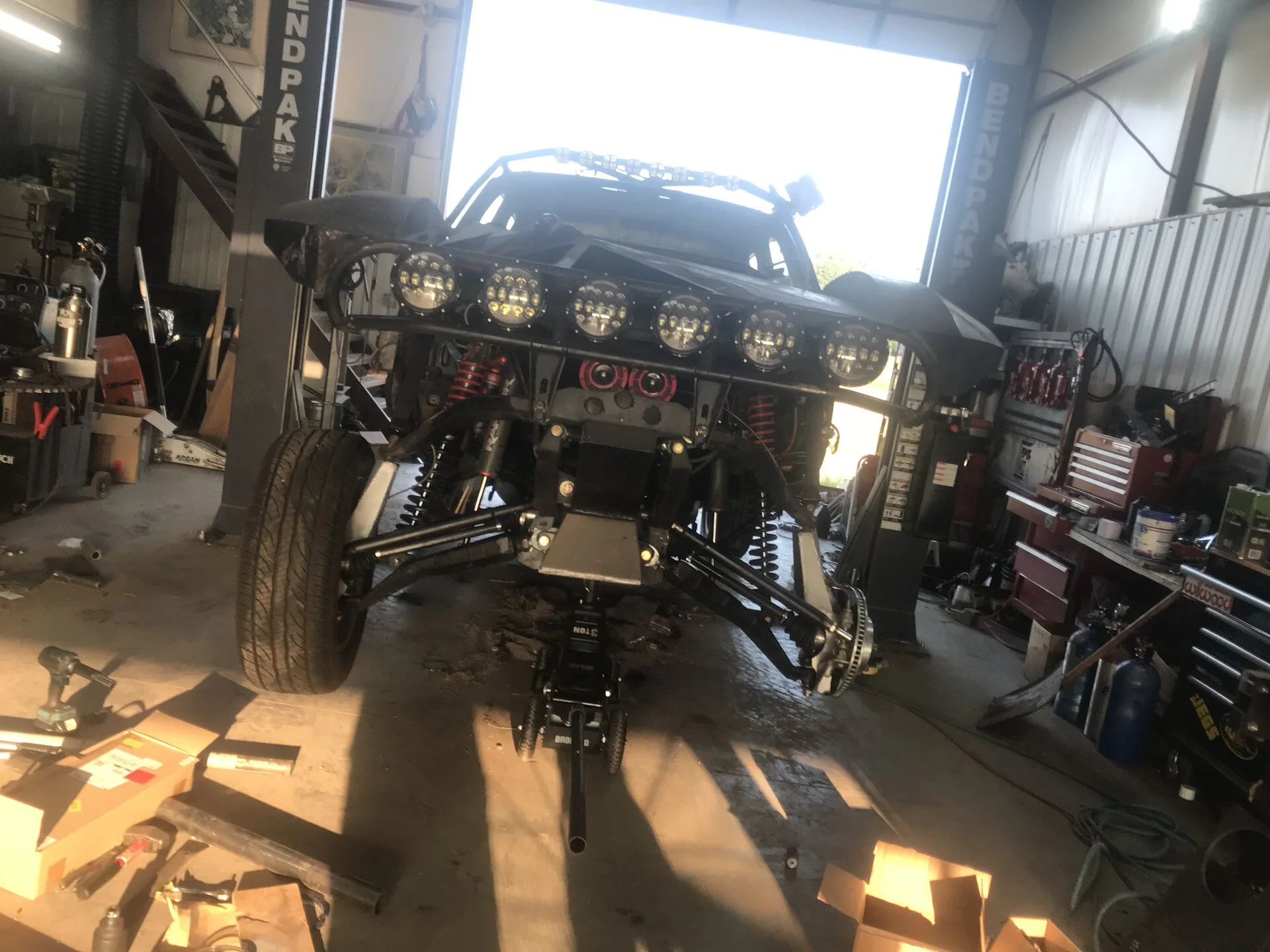

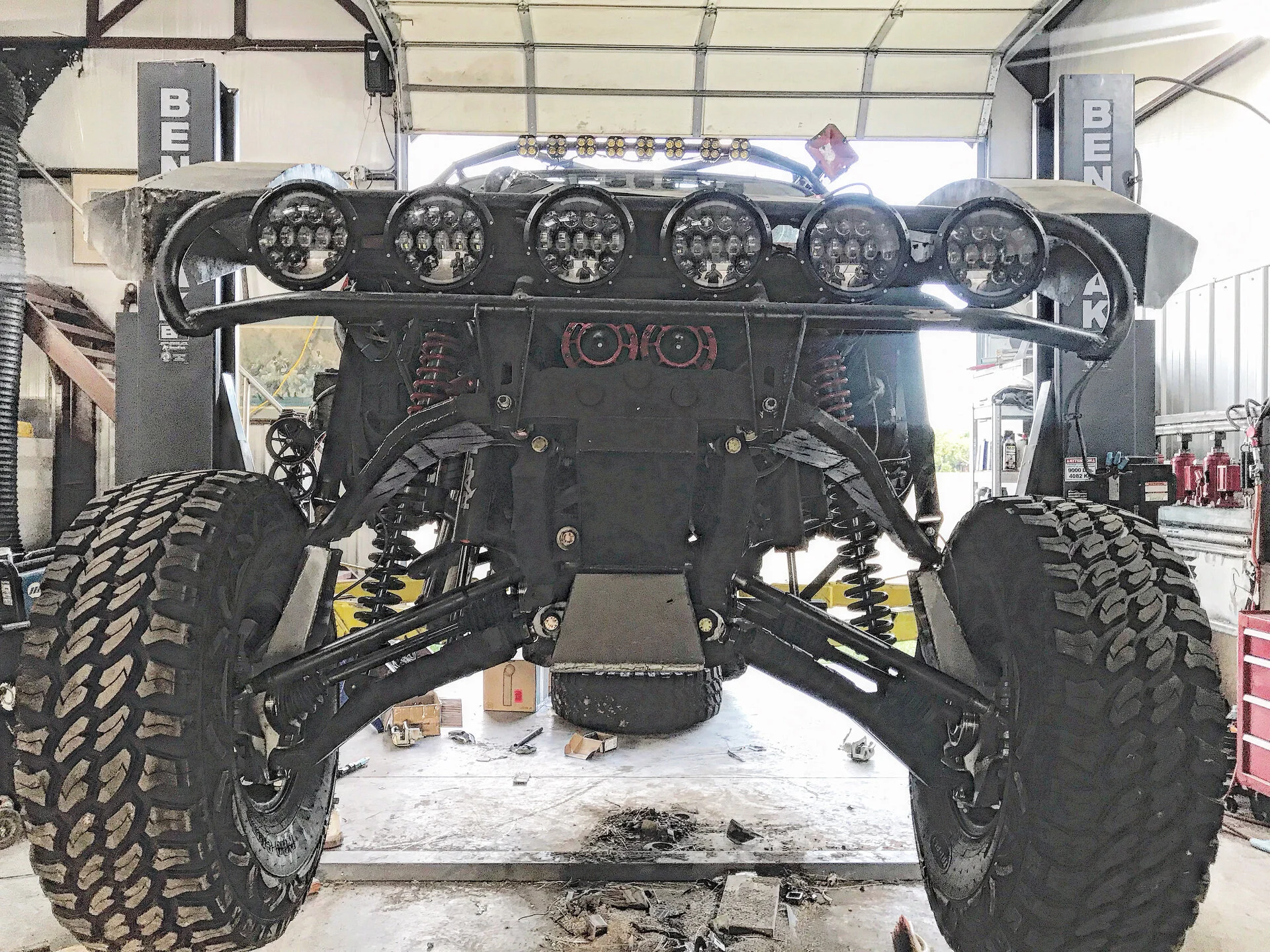

Axles are in
Sacrificed an inch of downtravel to make these fit but oh well I think I have some to spare.

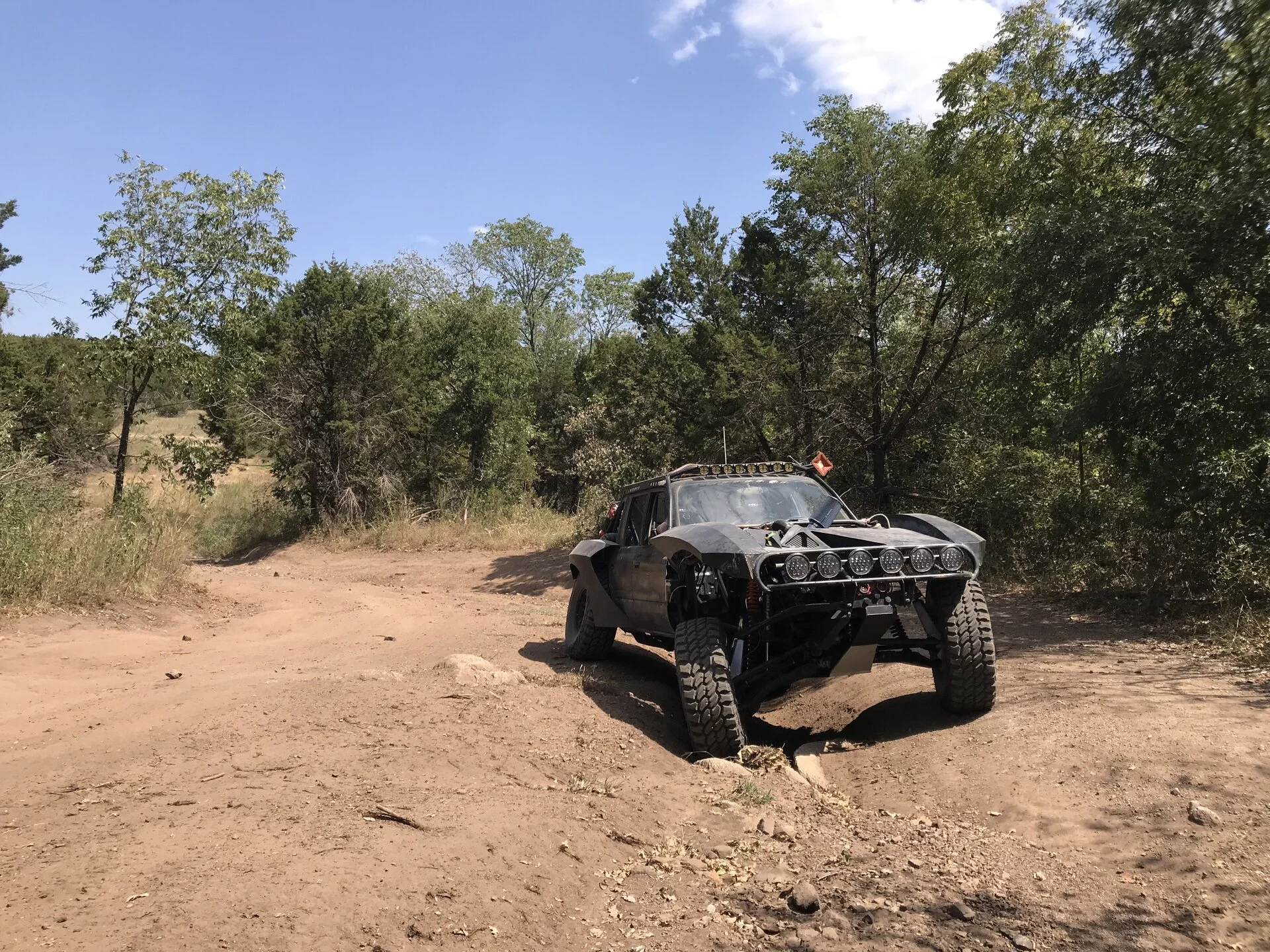

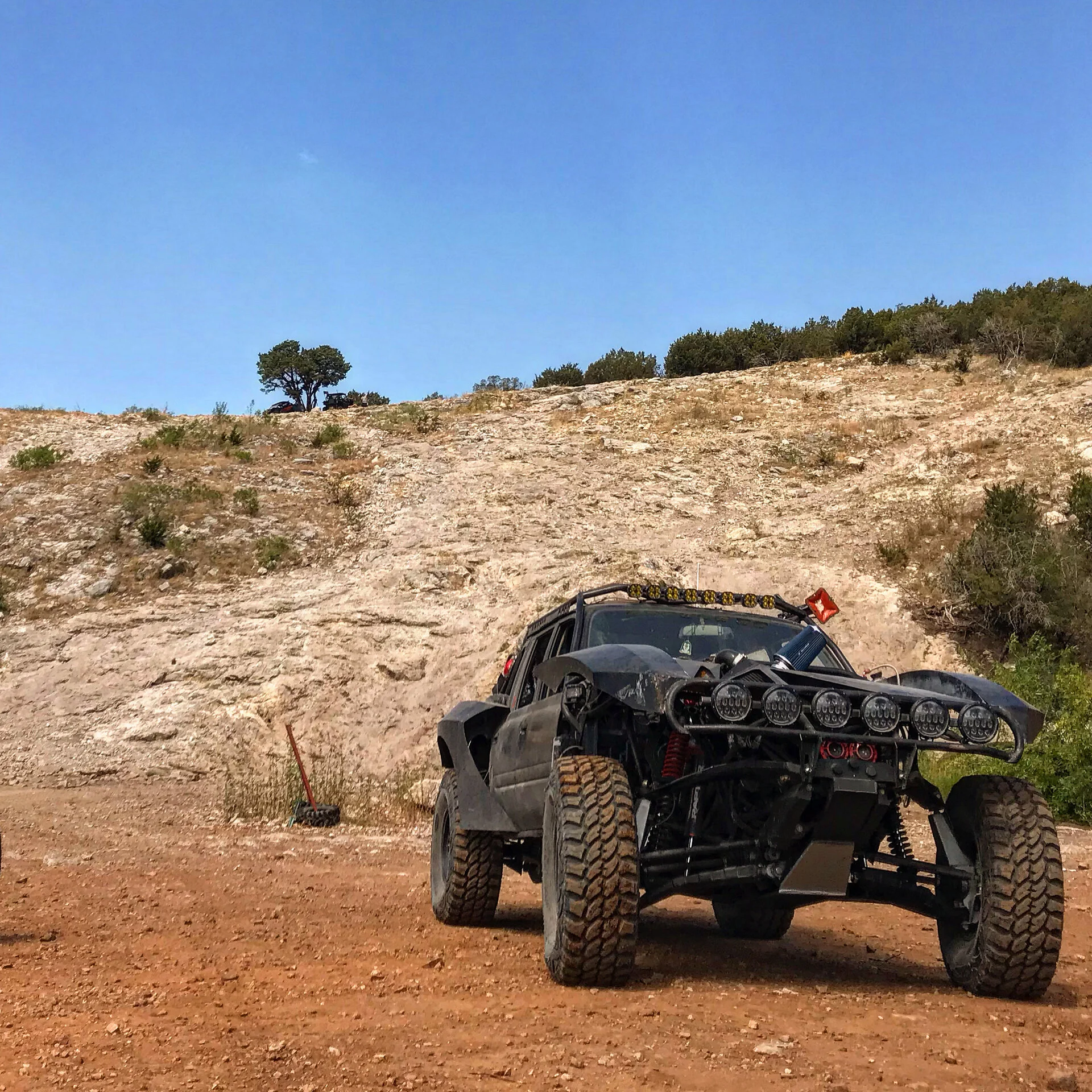

Some trip pics
Quick run
Figured out I have too much flex in the front diff mount
It’ll get fixed but kept me from really crawling out there
Also truck was running hot
Might need to do a more powerful fan

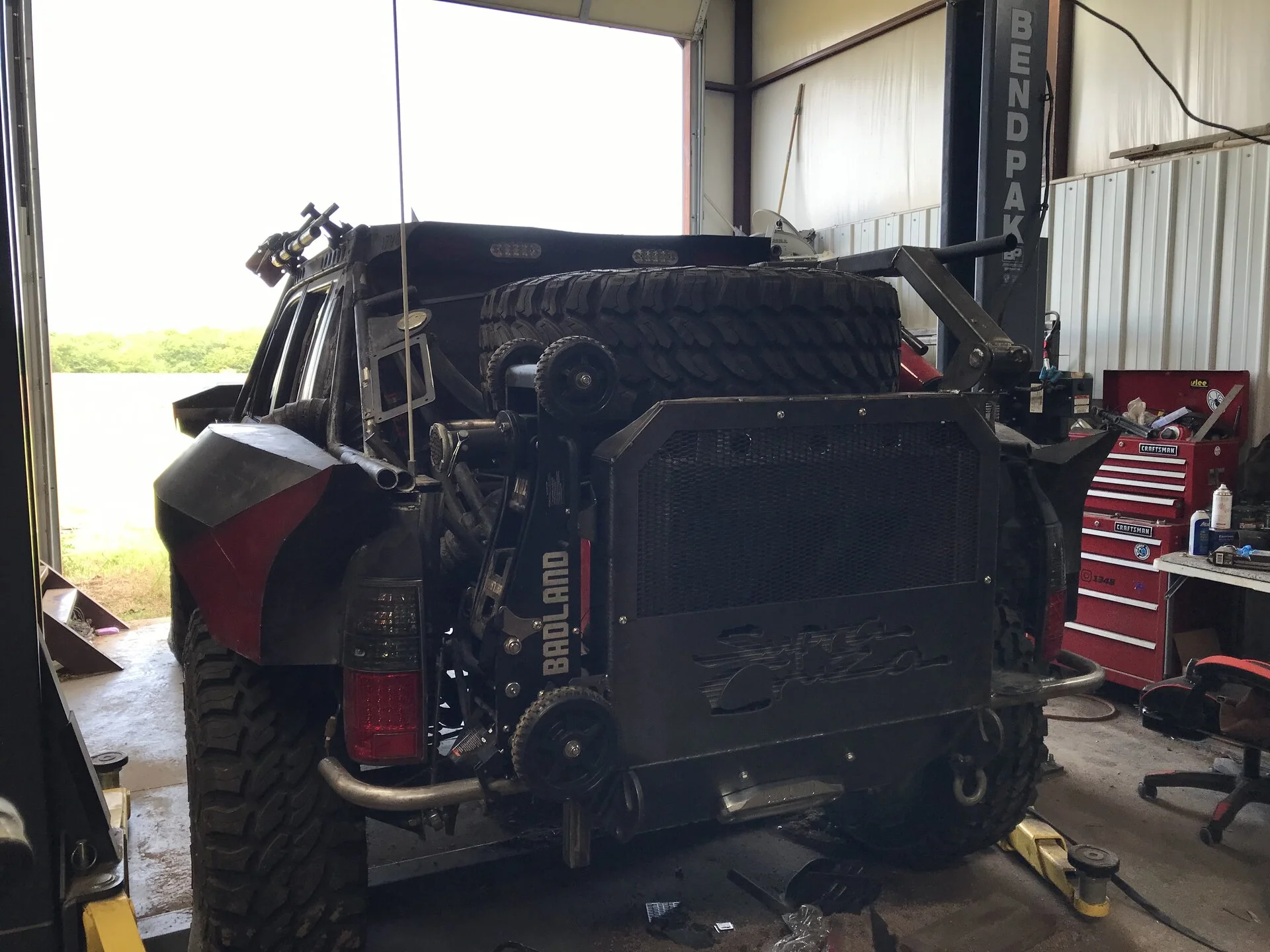

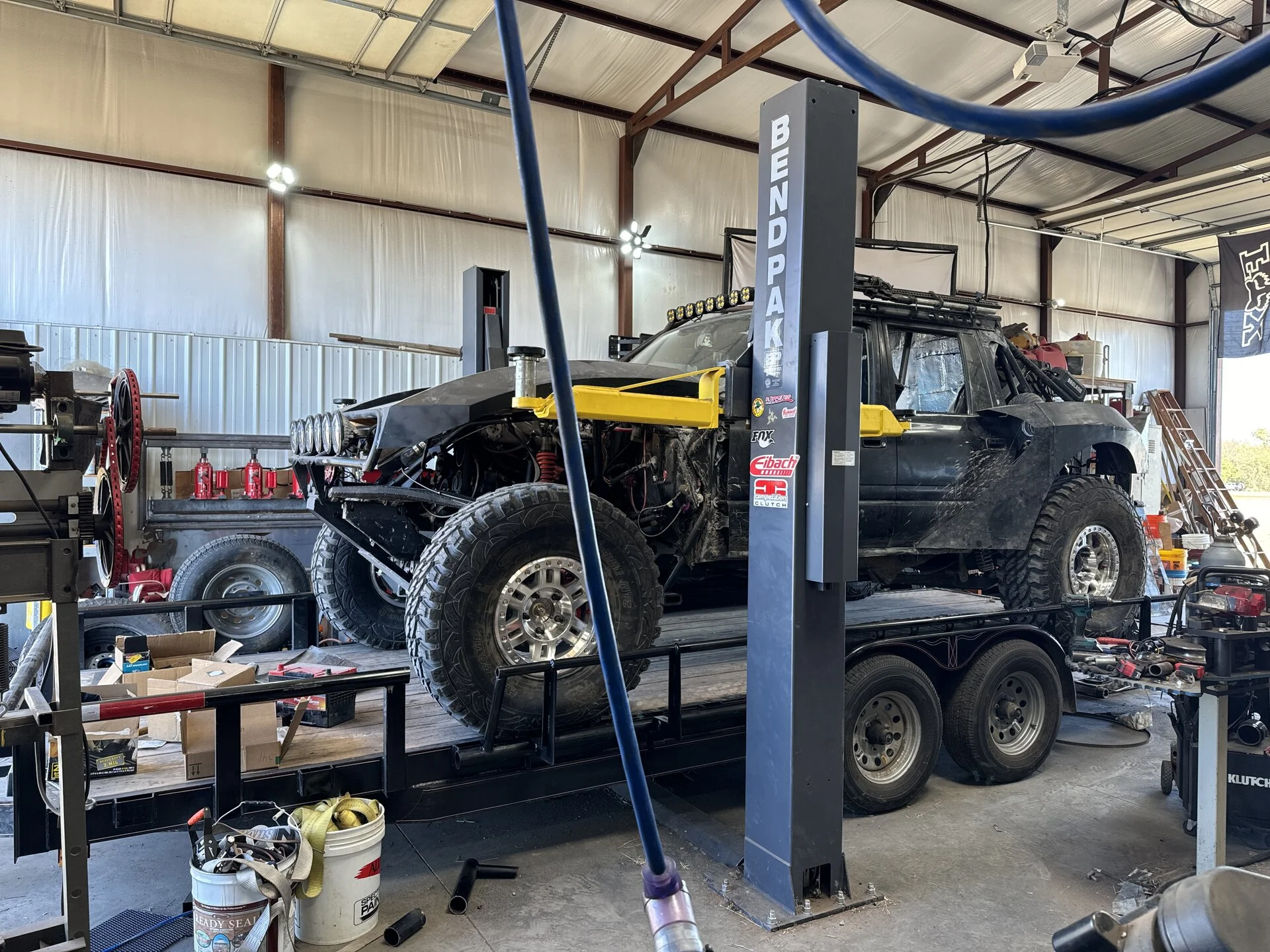

Another clutch died. Time to build the trans with the parts I have had laying around. Thinking about just going auto to be honest😂
Trailer is wider now, no more taking off tires to go wheel life changing to be honest
Update I’m an idiot. As per usual. New China calipers I used for the hydro hand brake are sticking. Enough that I noticed on flat ground. Probably why the clutch it already dead.
Not sure if it is a problem with them or the hand brake yet.
