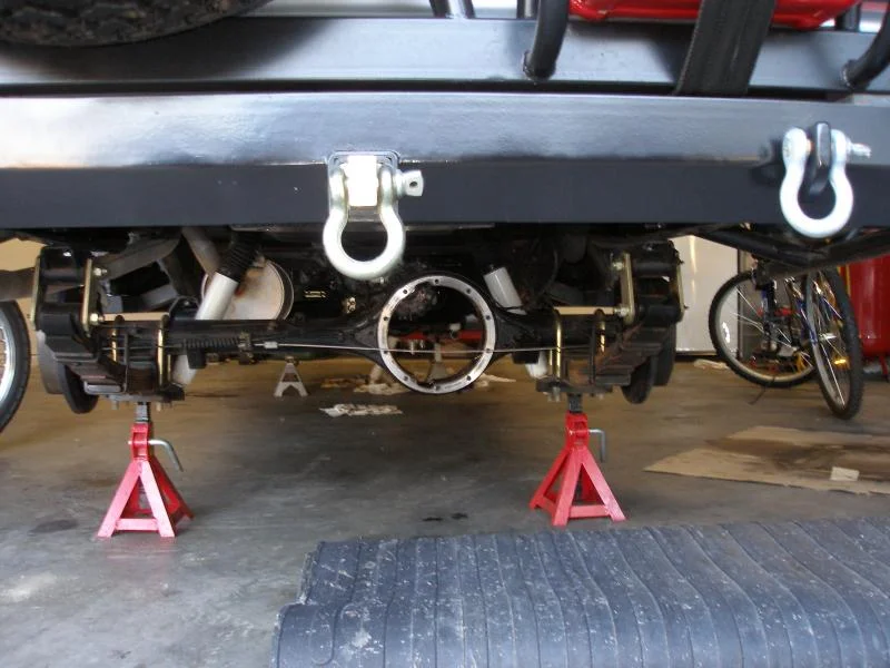

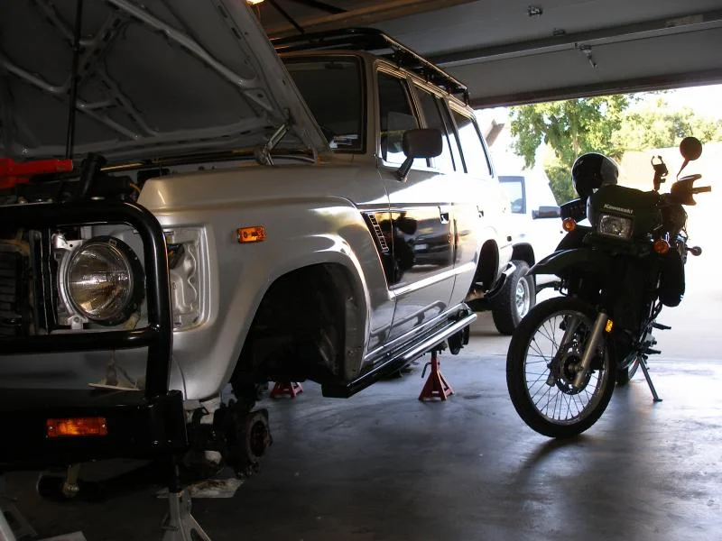

Well, I've started my summer upgrades with the help of Exrsa1. After acquiring all my parts over the winter and a healthy dose of Uncle Sams Tax return I'm conducting the next phase of improvements on my 60.
Here's a list of items/projects for 2009:
Front ARB Locker - Currently being installed
Rear ARB Locker - Currently being installed
HD ARB compressor
4.56 gears in front and rear - currently being installed
New front and rear seals
Front knuckle rebuild
Front and rear bearing inspection
New rear brakes and cylinder
Rear drums turned
New Front brakes and calipers
New Front discs
Flush brake lines
Stainless Steel lines front and rear
Remove, clean, test and boil out radiator
New rubber hoses on entire engine
Replace all vacuum lines with silicone lines
New belts
New timing cover gasket and seal
Clean, inspect and paint all front end brackets
New tie rod ends
Rust proof all interior seams on doors and body panels

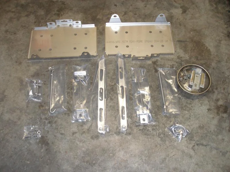

Dual Stainless Steel battery holders
New Dual Batteries
New custom cut dual battery harness with rear harness for Engel fridge and front jumper cable quick plugs
Delete rear heater and engine bay hoses
Carb rebuild - Still need to locate and schedule with Jim C.
Fab up rear utility light bracket on SROR bumper
Re-do the field tool kit
And a bunch of misc. stuff.
An added note, I'm keeping the 60 smogged for as long as possible since it runs great even with 235K on the meter.
I'm hoping to have this stuff completed by August due to a planned trip to Colorado in September!

Truck is looking great as usual! Keep us posted ( pun, ha! )
Thanks.
Yep, someone got my front ones and axles aswell!
Have always loved that truck.
Keep us updated!

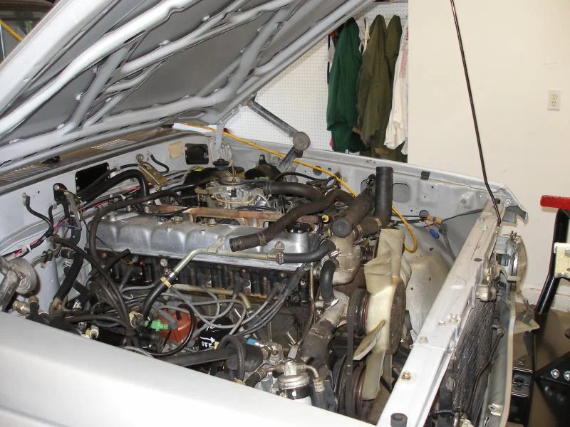

Radiator Update-
I originally had planned on purchasing a new radiator for this update but I went ahead and took the rad. to the local rad shop (I love these shops that are 50+ years old and still run by the original owner that knows everything about their operation...) They inspected it, boiled it out, pressure checked it, straightened the bent fines and repainted it for $49.00! They indicated it's still a strong rad! So I guess that saves $289 for a new one!
I'll be picking up the entire hose kick this week from Toyota, so the weekend will be fun filled!
