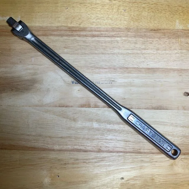

6 point wrench and a cheater bar and you will get it, good luck. …..For a cheater bar you might try 8 or 10 inch piece of pipe to go over the end of the wrench.
Use a 1/2” drive breaker bar with an adapter if needed.
There’s nothing on the cruiser that that bar can’t loosen.
Long breaker bar, deep 6 point socket or regular 6 point socket with a short extension and push or pull. If you just cannot seem to get enough force on the breaker bar (in can be awkward under the truck) place a jack under the end of the breaker bar and use that to apply force.

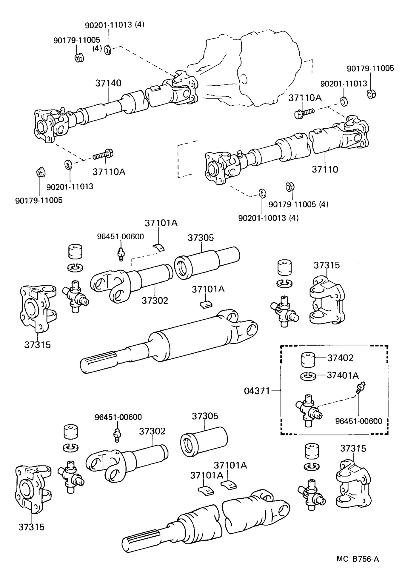

- and i prove that in this Link below , as i enter the unknown on my rear full floating axle , 1st ever Rodeo 🤣
- there are a PILE of good current rear drive shaft hardware anything toyota oem part numbers below , in my FSM step by step attempt to reach my version of Manifest Bliss , Rear Drive Shaft Everything included .......
i just read over your thread post last night and was puzzled a bit thats all ?
posting photos here in TECH, section of any questions you have in any way , shape or form . is a 99.9% positive topic in itself all the time ...
TOYOTA does use the Term retainer , and also retaining on the microfiche to br clear ,
perhaps this below parts diagram will assist you and help also ....
going by your AVATAR i chose a FJ60 , NOT a FJ62 to be klear here , also this is the later rivised style rear drive shaft parts diagram 4/85 - Later ....
i did not see a modle year mentioned above ?
hope this helps
matt
Thanks @ToyotaMatt, yup that is what I'm working with. The manufacture date on my 60 is 8/85.
