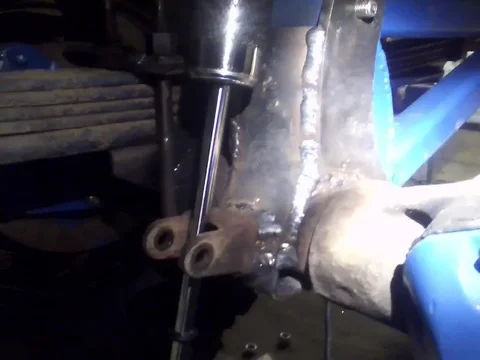

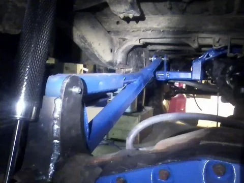

I was able to box in the mount on the axle for the traction bar today and got the shock mounts in for the rear axle as well.
I will wait for some forklift flexing before I get the bumpstops and limit straps in on the rear axle.

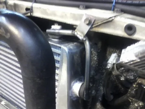

Last night I was able to get the intercooler mounted.
I just need to cut some holes in the front of the engine bay and run my piping.
The lower tubing will help locate and secure the bottom of the intercooler.
I also started on the driver side fender but realized I needed to bring the sawzall.
