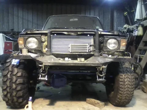

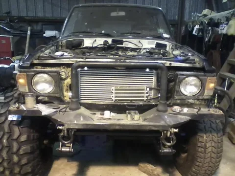

Took a picture of the new rear shocks and also took some pictures of the truck with the intercooler and light bezels in place.
I will get those shocks installed after getting the traction bar completed. I will probably grab some limit straps too just in case.
I also wanted to see what the truck would like with the intercooler installed. If I install it I won't be able to reinstall the grille, but I think it looks pretty good without it.
I do really need to get that last fender trimmed and tire mounted.
You'll need the grill man, it looks funky without.
There has to be a way to keep the intercooler with the grill. There has to.

I like the look of the intercooler with the way your bumper is built. Kind of fits the frame. Maybe you can fab some sheet metal to go around your bezels to finish out to the intercooler.
I don't have my snorkel plumbed to the intake any more (yet) but my filter sits right where the snorkel comes through the fender. I assume that at speed I do get a little bit of cool air boost from it. There is also a a place that has fairly inexpensive intake tubing like cobra heads that I have looked at to try to make that work. www.intaketubing.com I think.
Dude! You are the king of fab, fab a custom grill. Or, fab custom brackets to make your grill work. Not that it doesn't look good that way (not that it looks great), but you need something between that intercooler and rocks and things.
Yeah, thinking about it, I do need something to protect it from branches.
I will probably get some flat stock and perforated steel to make some sort of grille.
I will most likely reincorporate the stock toyota emblem too.

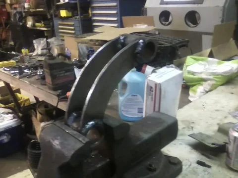

What I do have pictures of is the bushing holder that will be used to mount the bar to the axle.
Most people would feel comfortable just welding these up like so, and running them as is.
I decided I wanted something a little bit stronger:

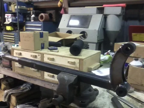

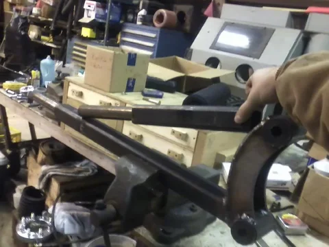

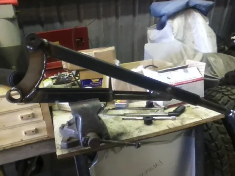

More work was done on the anti-wrap setup.
I matched the angle of the shackle on the frame to the pinion angle and burned in the lower length of the bar.
I was stalling out the drill press in the shop drilling the 7/8th holes for rosette welds to mate the 2" .250" wall square tube stock to the 1.5" dia .250" wall round tube.
Here is what the bar looks like at this point.
This traction bar should be plenty strong and hold up to quite a bit of abuse.
Here is what it will look like once I tie the other bar into the setup.
