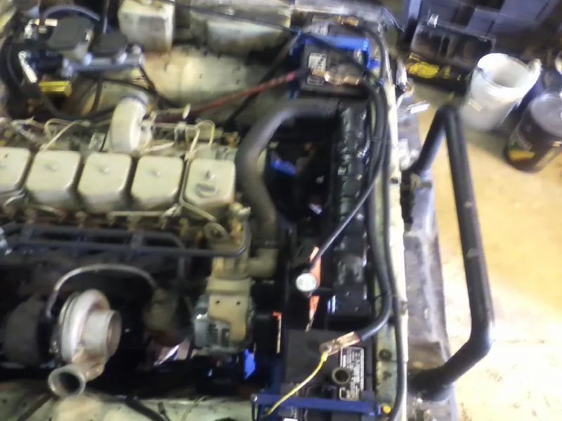

Yesterday I focused on wiring for the motor and systems and completed about 95% of it.
I was able to tie everything into the old wiring harness.
I am now able to start the motor up using the Toyota key and I have to say it feels really good. :D
I fabbed up another battery tray and tie down and installed the second battery.

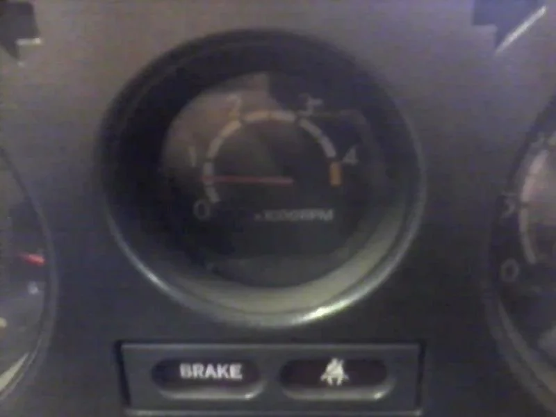

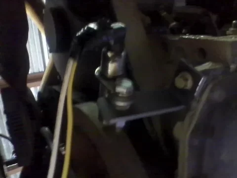

I also wired up the ABS sensor and tested out the connection to my tachometer. It works!!! Its so cool that this worked out so well.
Sorry about the super crappy cell phone pictures.
The tach is cool. I didn't even run mine long enough last weekend before we shut it down to look at the tach. I'm still waiting on turbo parts for my wh1c. I ended up ordering a core for it. I got the rebuild kit but upon further inspection I found a couple of burrs on the shaft and decided not to risk it. Everything else is pretty much in place. Like you, chasing the rest of my electrical, even have backup lights right now! and like you wired the solenoid to work.

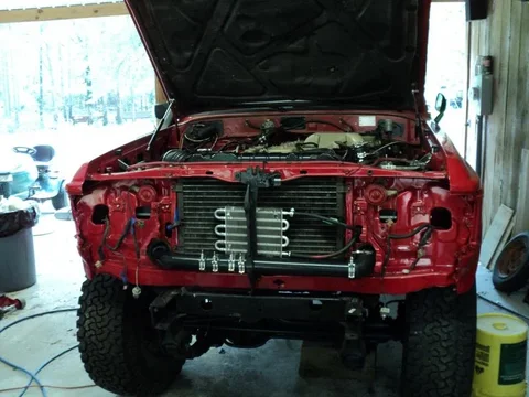

I also have my intercooler piping in place. No intercooler but I think It will all be fine. I have fit the grill over this and it will work with just a little plastic trimming on the back of the grill.
Just used a four inch hole saw and cut the radiator wall. Also changed the radiator support brackets. Had to cut off the little rubber mounts and weld it up a little different to make the room for the piping. Also a little wheel well trim right at the front right. If you you need any 2.5 inch intercooler tubing I have several pieces left over. Advance has the 3-2.5 adaptors on the shelf.
Looks good.
I could use some intercooler tubing, PM me with what you have and what you want for it.

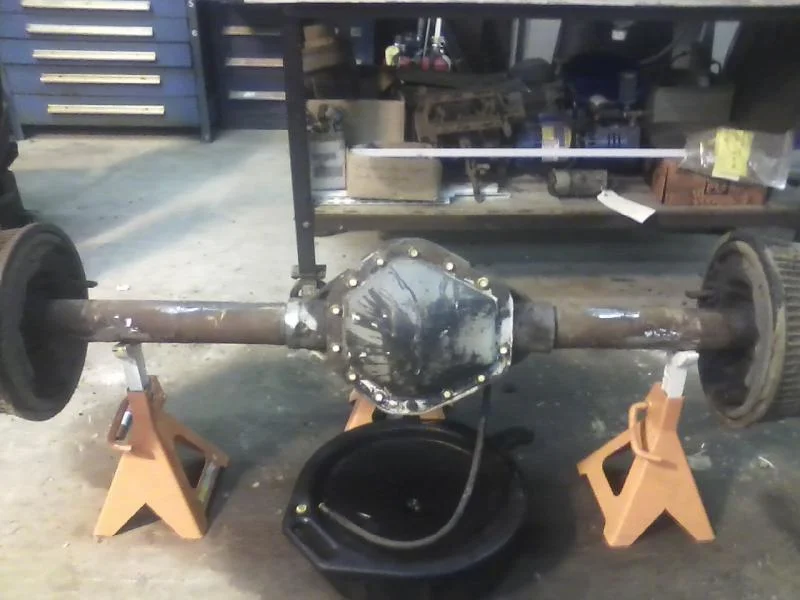

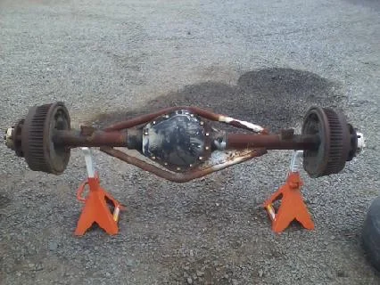

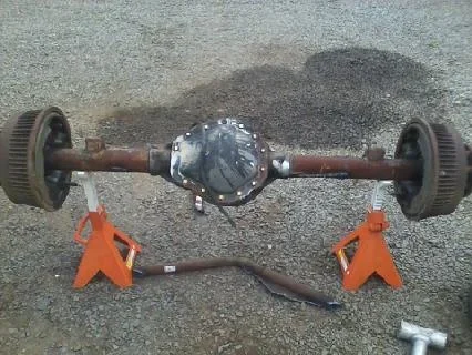

I tore into the 14 Bolt last night and was able to get a bunch of things completed on it.
Old Stupid metal truss welded on the axle.
Looking better:
Ready for new perches and shock tabs.
I still need to pick up some flap wheels to get it nice and smooth. But to get it to this point only took 2 hours or so. I wanted to make sure there was plenty of time to cool so it wouldn't get heat soaked and warp while I was torching the old brackets and truss off.

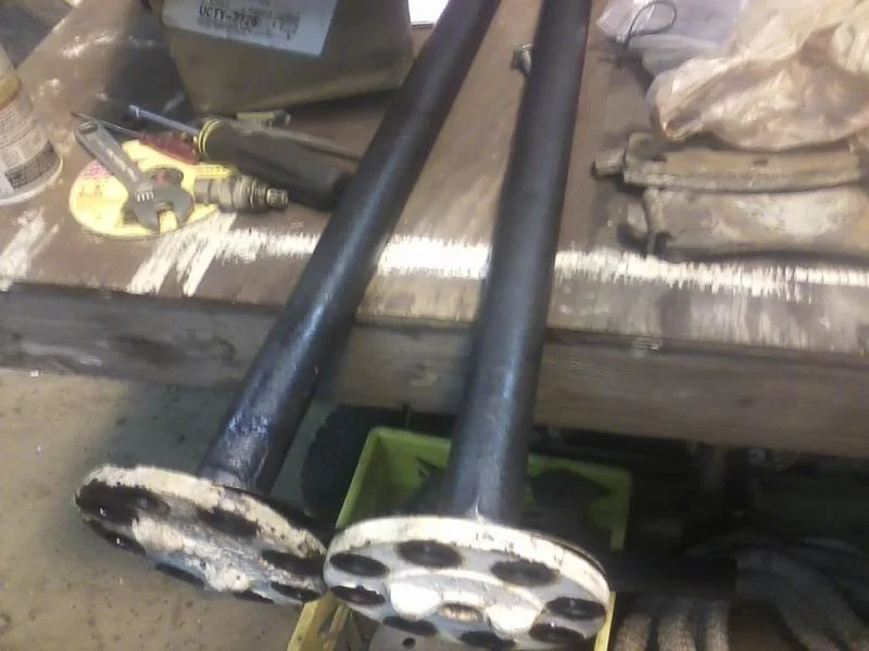

I pulled off the old drum brakes and have to say these axleshafts are STOUT!!!
I also marked up where I will shave the axle to. (Axle is flipped upside down)

I think so, I attached both to the positive post on the alt. You are running a external regulator right?
Man, I LOVE that tach setup. I think I will have to do the same thing :grinpimp:
