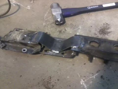

Some more time in the shop allowed me to modify the transmission crossmember to get the front driveshaft in. I unfortunately didn't have any small tubing laying around so I made use of some spare metal I had in the shop.
It turns out a leaf spring plate and some flat stock worked pretty well for what I needed.

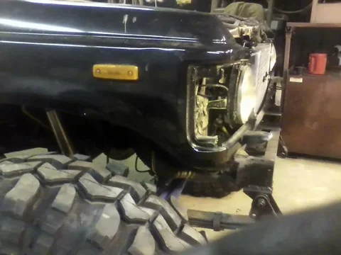

I finished up the fenders last night.
They're not quite "show truck" but they aren't terrible for a wheeling truck.

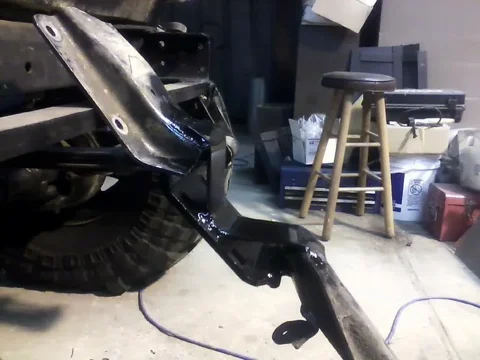

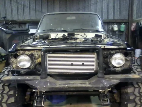

I also reinstalled the front bumper after getting some paint on the fenders.
