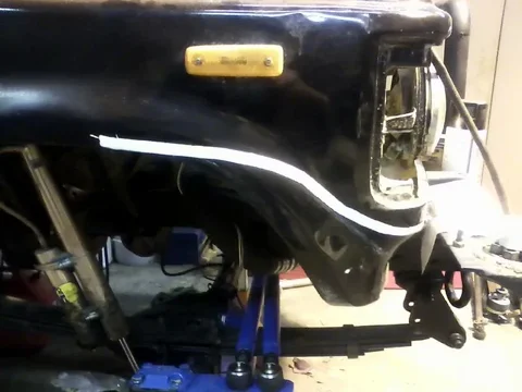

I started cutting up my front fenders tonight so I will have at least 4" of uptravel on my front suspension.
The bottom of the tape is the line I am going for:
Started cutting so there is no going back now.

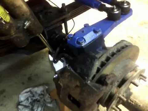

I also plumbed the brakes for the front axle to the frame, once I box in the rear framerails I will go ahead and do the rear axle.

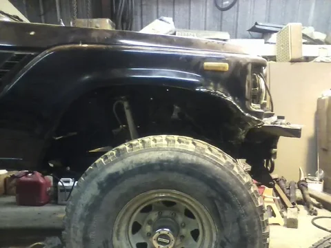

I used some 5/16th steel rod to give the new edge some strength and ended up with this at the end of the night.
The rod getting welded in:

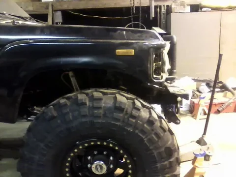

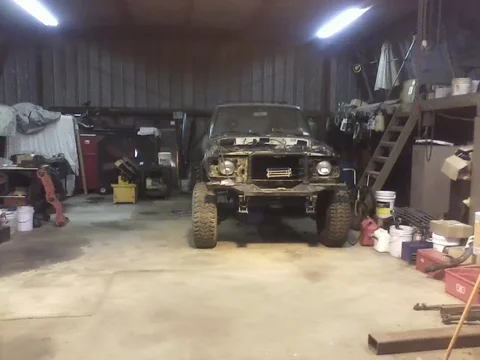

Here it is with the 43's installed. Just around 5" of clearance. Considering I will be limiting my uptravel to 4" it should work out ok:
Plenty of room for the 37's:

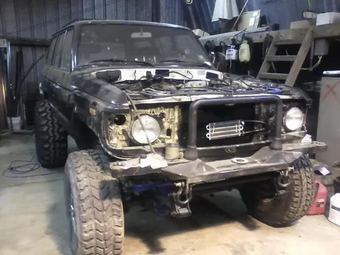

I had to install the 37's to roll the truck to the back of the shop.
I have to admit though its doesn't look too bad with them on. I also cleaned up the shop a bit so we will have some room to pull a tractor in to get worked on.
This thing is getting savage!!!
I am so amped to get this thing finished.

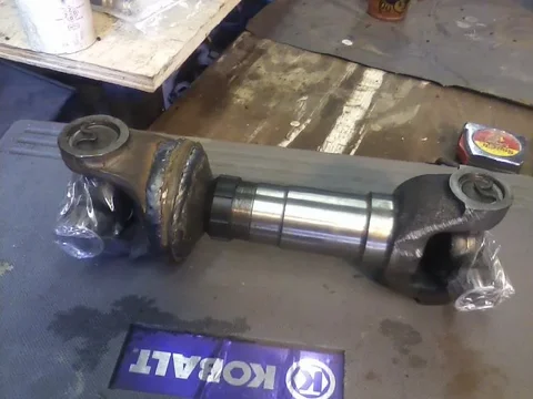

Midshaft:
12.5" long, 1480 Series U-Joint at transmission, 1410 at TC
Rear shaft:
20.5" long, 1350 Series DC Joint at TC, 1410 at 14 Bolt

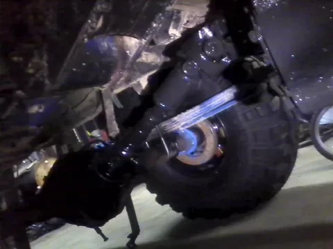

Here is the midshaft, it goes between the transmission and the transfercase. It has a 1480 joint at the transmission end, and 1410 joint on the transfercase end.
And here it is installed. I will get a better picture sometime this week.

Got a few hours in on the truck today, I got the passenger fender to an acceptable point for now.
I will probably get it looking nicer in the future but it will work well for now.
I also installed the spacer for that side and mounted up another 43.
I now have 3 of the 4 tires mounted and installed.
The truck is gonna sit pretty wide up front. but that will be nice and stable.
