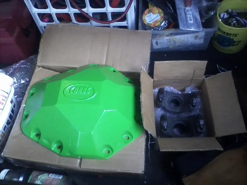

Well I got some moer upgrades for the truck in the mail. The axles get this round. I recieved a 13 Bolt Cover from Crane and 1410 ubolt yokes for the 14 Bolt and Dana 60.
This cover is super beefy, and will help with clearance under the 14 bolt. I didn't want to go crazy with extra work like turning the ring gear down so this should be good enough.

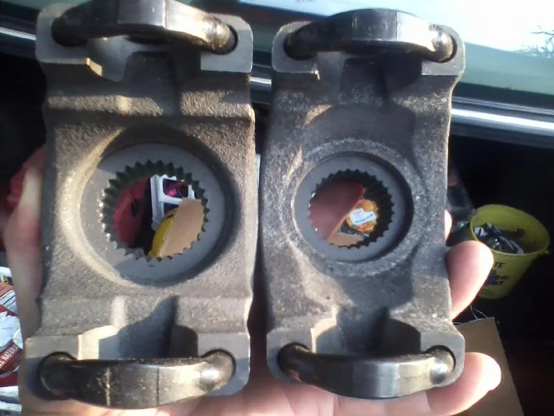

Also here are some comparison shots between the yokes for the 14 bolt vs a Dana 60, the 14 bolt is on the left and Dana 60 is on the right.

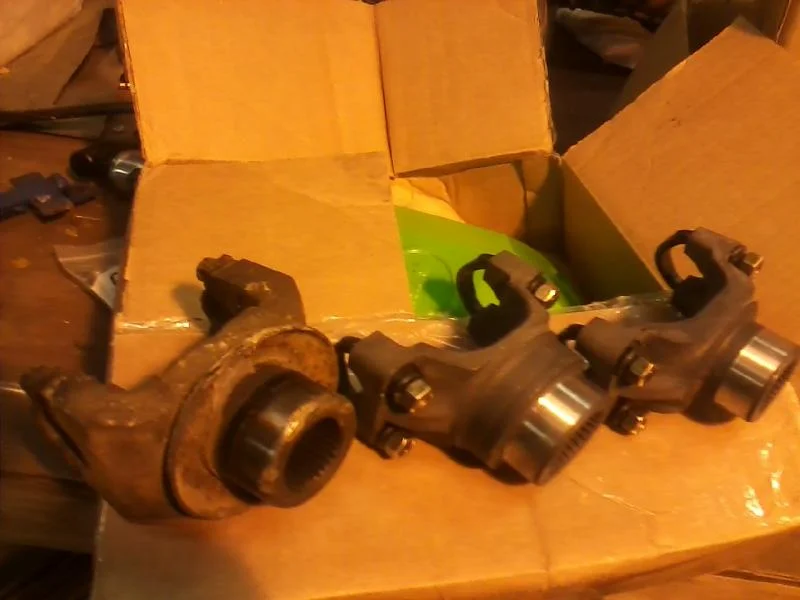

And here is a comparison of all of the yokes I'll have on the driveline. From left to right, NP205 1410, 14 bolt, Dana 60.

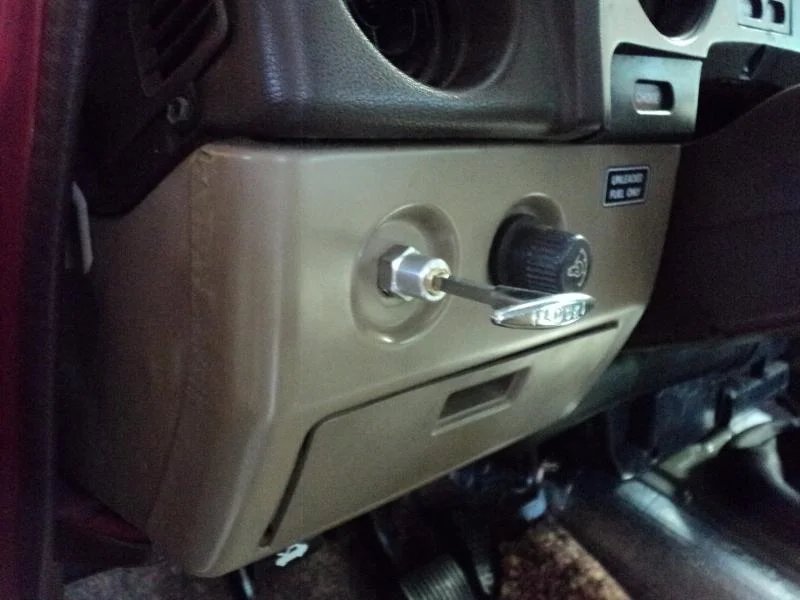

Fuel solenoid delete
Stevo,
Check this out! Found this last week and thought it would be cool. Took off the fuel shutoff solenoid and replaced it with a pull and lock cable. Have to pull on and lock to crank and run, unlock and push for engine shutdown.
The cable link at the pump is kind of rough right now. I have to find some better or smaller cable locks. The bracket for the cable support is the choke cable mount from my old 2f with some mods.
Sweet, I just used my choke cable attached to my fuel cutoff.
