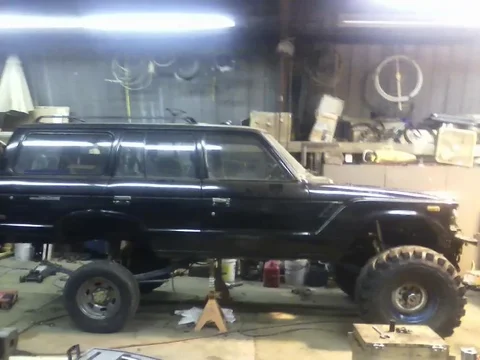

I did a little bit of shop rearranging today to have more room to work around the back of the truck.

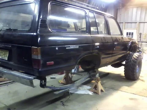

I put the back of the truck up on some jackstands and as it sits now is about an inch and a half short of its final ride height.
I pulled the rear axle tonight too.
With the old axle out of the way I shouldn't have any issue with dropping the gas tank.

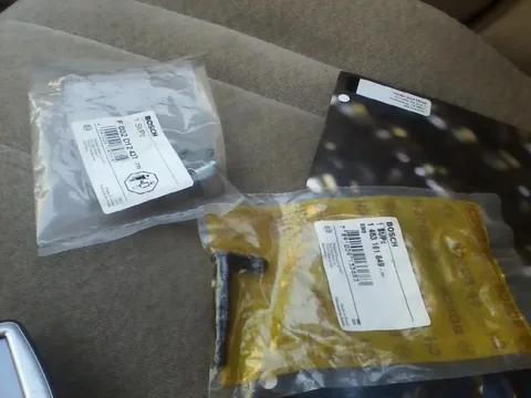

I did pick up some parts for the motor, a new index shaft and control lever for the injection pump.

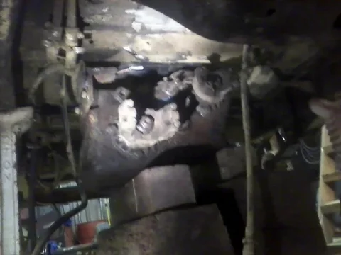

I did have some time yesterday to work on getting the transfercase set into the truck. I have the mounting brace finished as well as the mounts welded to the frame. I just need to find a buddy to help me position it under the truck.

Yeah the case is about 150-200 lbs and I will definitely need a buddy to get it installed.
There will need to be a short driveshaft to connect the trans to the tcase.
The only real advantages are that I can easily pull the engine and transmission in one shot.
I can also go to a local truck yard and grab any engine/manual trans combo from a medium duty truck that has is 2wd and all I would need to do to make it work is possibly modify the midshaft.
I'm not planning on having this motor blow up, but just in case I want to make the process as easy as possible.

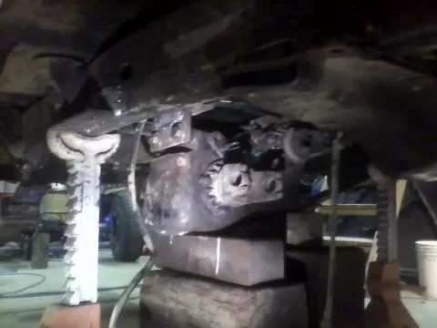

I had a friend stop over and we managed to get the transfercase up on some blocks.
Now that its up where I want it I can build the crossmember to make locate it.
I measured and from the bottom of the case to the floor will be 23" with the 43" tires so that should be plenty. It is also set to the back of the frame a bit so it won't be an issue.

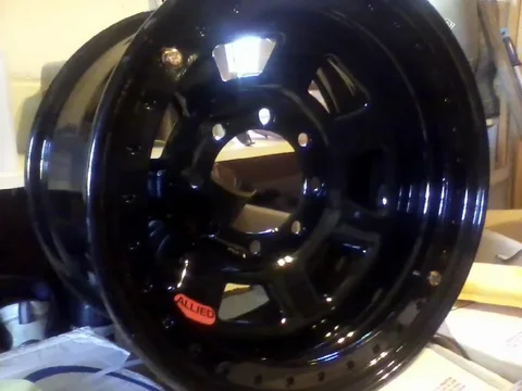

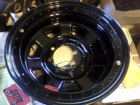

Today I came home to find these guys waiting for me.
I can't wait to get them all mounted up, hopefully tomorrow night.
