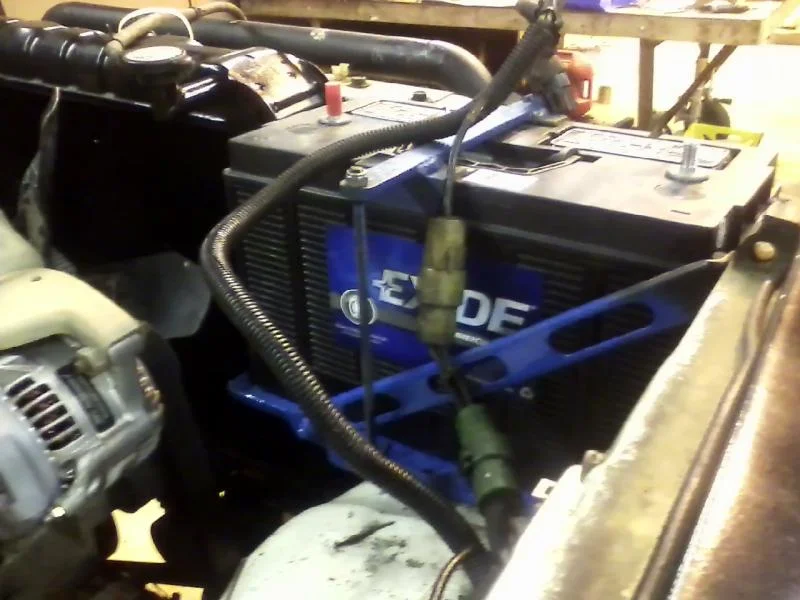

I gotta say I love the sound, I turned the idle down a bit so it sounds just about perfect. I love how easy it is to adjust a mechanical diesel. I can pretty much adjust and tune the everything with a small screwdriver.
And in terms of updates, I have been going over the wiring and should be able to incorporate the motor into the stock wiring harness with minimal hassle.
The 6BT is literally a 3 wire motor and I love it. One 000 cable runs from the battery to the starter, a small wire runs to the fuel shutoff solenoid, and a sensor wire runs to the starter to activate it.
I have one battery installed in the stock location and plan on placing its compliment mirrored on the other side of the engine. I figure with both batteries providing 925 CCA each and them being wired in parallel supplies me with 1850 amps for starting the motor.

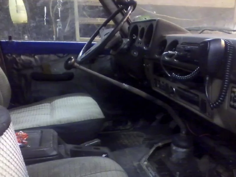

I also wanted to sit in the driver seat and see how it felt to shift through the gears. So I cut down the massive shifter on the clark transmission to a more reasonable and comfortable height.
I will probably make a custom shifter knob at work to enable me to more comfortably shift into reverse and first.
Also a buddy dropped off a 40" tire so I can get a pretty good visual of what the truck will look like as well as give me some input into the fender trimming that will be needed.

I have ben working on the wiring too. I completely did away with the fuel solenoid wire and have a manual pull for fuel on and off. The rest of the wiring is super easy, I spent part of last night wiring the oil pressure, tach sensor (hope it works) and putting in a new stainless battery tray for battery No. 2. I really like the idea of having all those cranking amps available. Have you seen the guy that makes the stainless battery trays? They are a great deal in my opinion, cheaper than SOR stock ones! Stainless Steel Battery Trays for TOYOTA LANDCRUISER Shipping is usually supuer quick too.
The nv4500 shifter is pretty big too but I havn't modified it yet. I'm going to try to drive it a little before I figure out where I would really like it to be. I am supposed to pick up my radiator today and some intercooler tubing is suppoed to be here this afternoon as well. Let's see what happens over the weekend.

I have seen those battery trays, they look well made and I really like them, however I have a hard time justifying an additional $70 on something when I could fab a basic one up for free, and a bit of time.

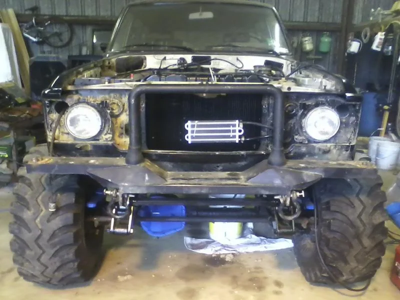

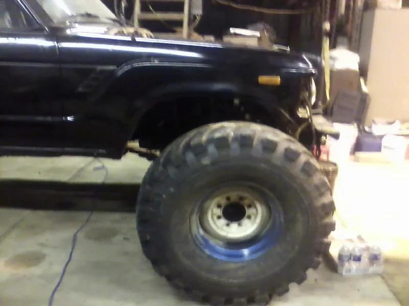

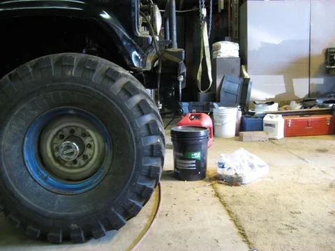

Got some time to slap a 40" tire on the dana 60 and I have to say I like the way that it looks.
I will probably end up getting some 43" Interco TSL SX tires.
So they will be taller but not as wide.
I am really liking my approach angle too.
I will definitely need to cut the front fenders a tad.
And plenty of room to turn the big tires as well.

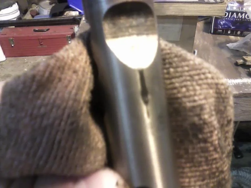

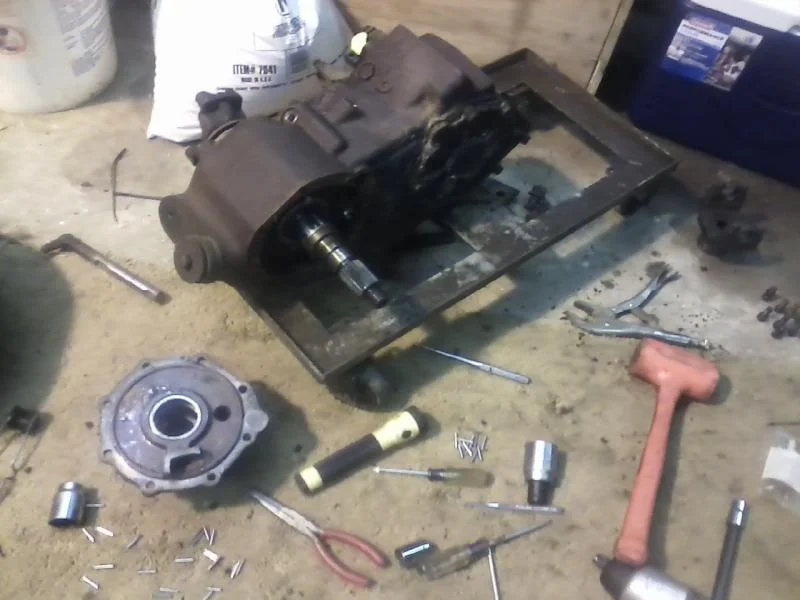

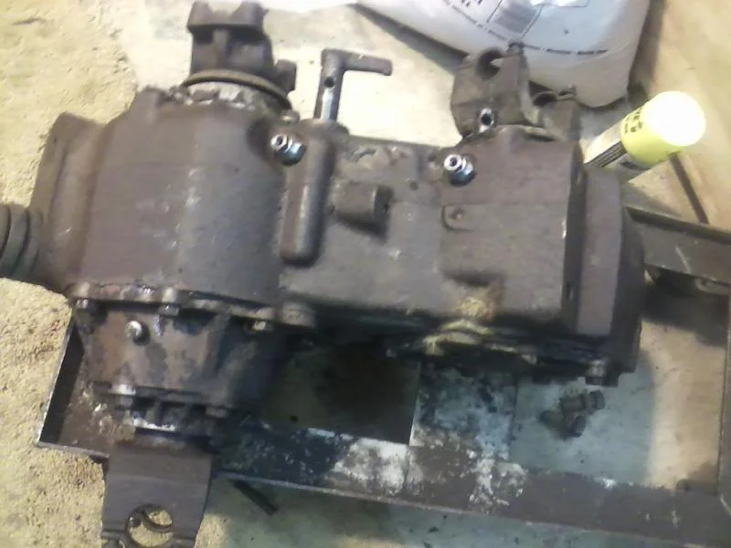

Well I modified my np205 for twin sticking last night and have to say it turned into much more of a teardown then I had planned.
I found this thread on pirate and have to say the guy did a great job explaining the process.
How to: NP 205 twin stick CHEAP! - Pirate4x4.Com
There was a visible amount of wear on the shift rail I pulled out, fortunately I would be grinding that off anyway.
So what went wrong while I was working on it?
I accidentally let the shifter fork drop down, so I needed to pull one of the covers of the case. I was greeted by a needle bearing that decided to spill its guts out everywhere.
Then I let the tool i was using to try and lift it back up with slip into the case and I couldn't retrieve it from the cover I had pulled off.
So I ended up pulling off the rear output assembly and was greeted by two sets of needle bearings which decided to explode and fall everywhere. :mad:
I eventually got everything back together and installed the adjustable detent springs.
Thanks for the idea Brokenparts, they work great.
