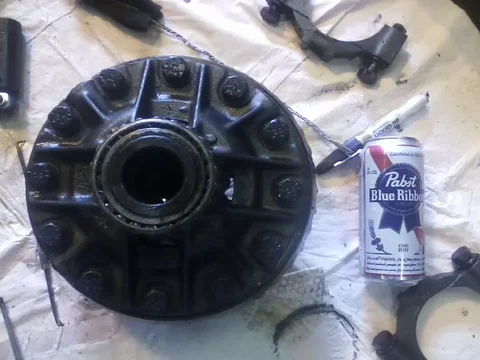

I tore into the 14 bolt a little bit today along with some steering issues.
The carrier on this axle is huge, here is a shot with some perspective.

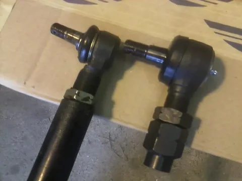

I also brought my hy-steer arms to work today and drilled and reamed them to fit my new 1 ton TREs.
Here is a Toyota FJ80 TRE on the left compared to a GM 1 ton TRE on the right.
I cut and welded my new tie rod and got that installed as well today. I will need to pull the pitman arm an ream that out to fit a gm TRE, or I will need to fab up a new pitman arm.

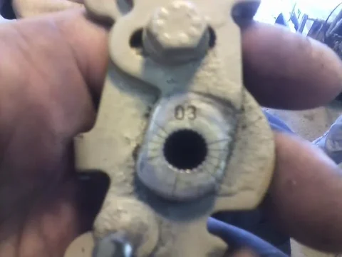

I also need to source a new control plate or whatever for my injection pump. Mine has rounded inner grooves which allow the throttle indexing shaft to slip an cause my motor to run like garbage.
Its the little guy with all of the index marks on it. If anyone knows of a good source for one let me know. Or if you have an extra one laying around Pm me with what you want for it.
This guy:

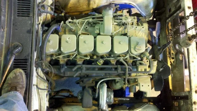

Well as fate would have it, didn't get to go look at the 6BT today. However, I did start work on the 60 Sunday. Took the whole front end apart and ready to pull out the old tired 2F. If anyone would be interested in this motor let me know. Still trying to find out how to post pictures. Steve, thanks for the measurement. Think this will get me started in the right direction. Thanks Klinedog, will take a look at those sites for sure.

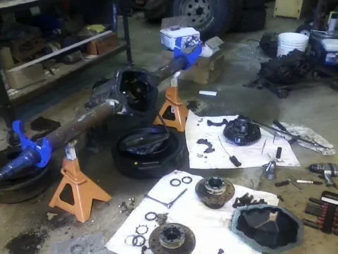

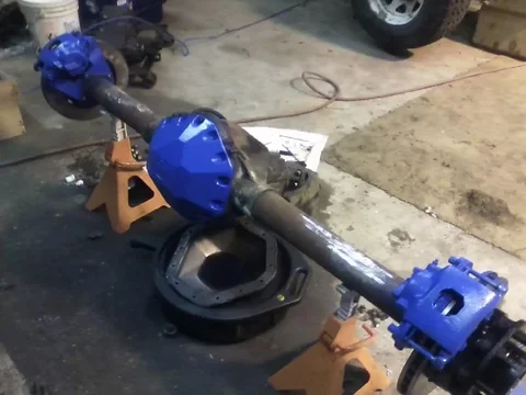

Over the weekend I worked on the 14 Bolt and now it is ready to get put under the cruiser.
Here is a list of the things I did to it:
Shaved it for clearance
Installed Grizzly lockers
Removed Drum brakes
Reinstalled Disc brakes
checked bearings for wear
installed 1410 ubolt yoke for the driveshaft
painted and reassembled
Heres some pictures of the shave job. I ended up removing around 1.5" from the bottom of the axle.
I just cut the chunk off with a sawzall and flap wheeled it smooth.
The cut:
Smoothed out:
All painted up and ready to get put under the cruiser:

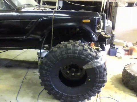

I am glad I went with these tires, I originally had my heart set on some Trepadors, but was disappointed to find out that they only have bias Treps in the competition compound and only sell them to Maxxis team trucks.
Sooo, after some more research I came across these and here they are. 43/14.5/17 TSL SX.
I think I might be at the "Go big or go home" point of my build.:D
I really like the fact that there is plenty of side lugs to give traction and the amount of Void in the tread should help with the sticky muddy trails that are common around me.
And here is a nice comparison shot between my old 35" KM2 and my new 43" TSL SX.

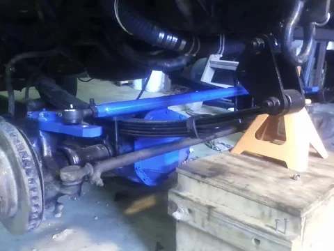

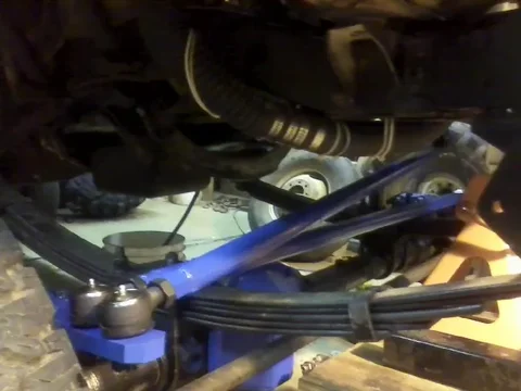

I was also able to get the steering linkages connected up.
Getting the steering hooked up was very easy, I picked up a crossover steering kit from ruffstuff.
http://www.ruffstuffspecialties.com/catalog/XOGMSTE.html
I was able to ream the stock drop pitman arm on the FJ60 steering box to accept a GM 1 ton TRE's
Then it was just making a couple measurements, welding the bungs in, and painting the tubes.
