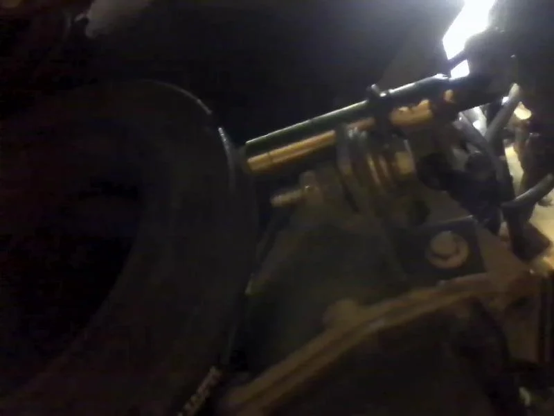

here is what the crank sensor looked like before i removed it and added the abs sensor.
Found this pic of just before I put the sensor on. You can see the way the notches are different from the last picture I posted and where how the bracket can work.
Did you cut extra notches in the 6BT harmonic balancer?
Also what ABS sensor did you use?
Yep, cut an extra notch to have three total. Local scrap yard had a trashed 6bt so I used that balancer to practice on with the notches. i think it is critical to have a decent gap for the sensor to pick up. Not depth, width. I think i used a ford explorer abs sensor. it is a 2 wire sensor. The dodge crank is a 3 wire. I didn't want to try to figure out what was what so i just ebayed the explorer sensor. All of my assumptions are based on the link I sent before. Let me know what happens if I don't get there first!

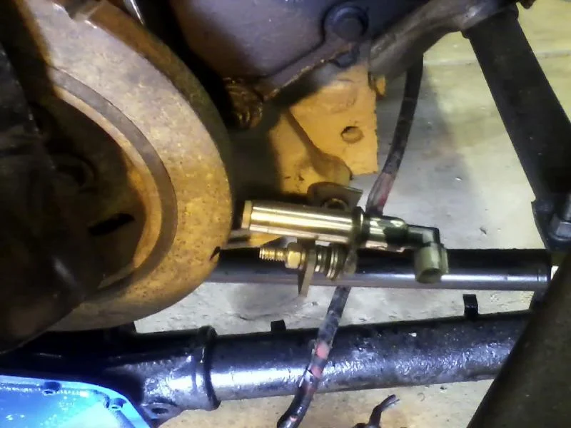

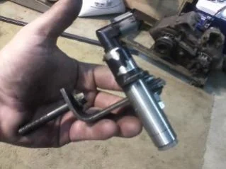

I also have been thinking about the tach situation, and I really would like to know what RPM the motor is turning so I called a buddy to see if he still had the ABS sensors from the FZJ80 axle I swapped into my truck.
He fortunately did, and with some time and scrap metal I came up with this.
Hopefully It will work.
Looks good. that's about what I started with for my abs mount then I just ended up using the original crank sensor mount and drillilling, tapping a mounting hole in the center of it. Can't wait to see it work. You know we are going to have to post a youtube of them rollin coal!

I can't wait for that. Hopefully I will be able to get some footage of the engine firing up this friday. Here is my tach setup from a different angle.

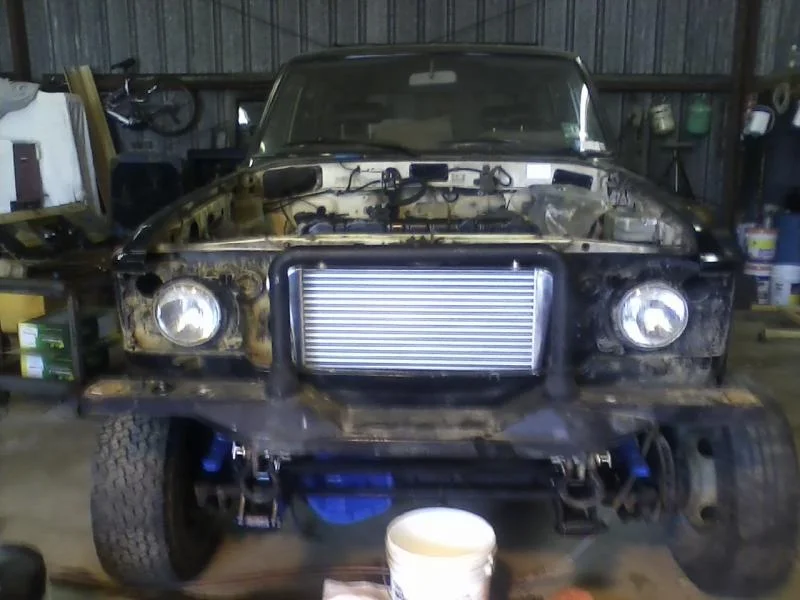

My intercooler came in and fits nice right over the opening for the radiator. I figure the best way to attack the piping is to make a run to lowes and grab some pvc to mock up.

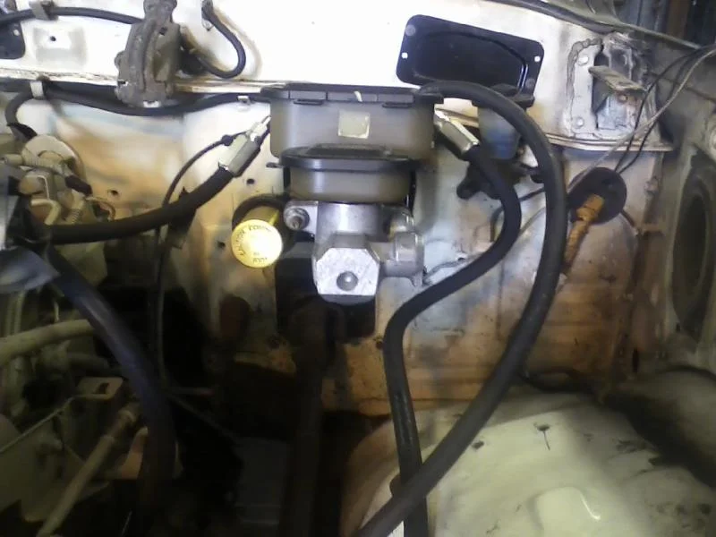

I also finished up the plumbing on my power steering and hydroboost setup. The cooler will be reinstalled once the radiator gets back.
Making up the lines was a breeze. Much less trouble than I figured it would be.
You might want to look at the gap setting on your abs sensor. I am thinking that you might need to be as close as the old cigarette celophane trick to get it to pick up the gaps correctly. Probably something you have to play with 'cause i thought I could see various washers you used for spacers.
