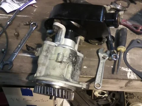

Well today was much better than monday, I made a run to advance auto last night and thankfully they still had my old alternator. So I brought it back to the shop, got the old pulley off and installed on the new ALT.

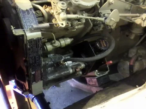

I also sacrificed one of my old extended brake lines to fulfill the role of the damaged oil line. With that mated to the vacuum pump and new power steering pump I finished installing that today as well.
The last thing I worked on today was getting the coolant lines completed. For the time being I will bypass the rear heater in favor of a simpler system. I have the upper hose buttoned up, the lower hose is 98% finished and the remaining heater hoses are almost completed as well.
