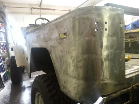

more patching on the rear of the tub. almost got all the rust out. lots of welding in my future.

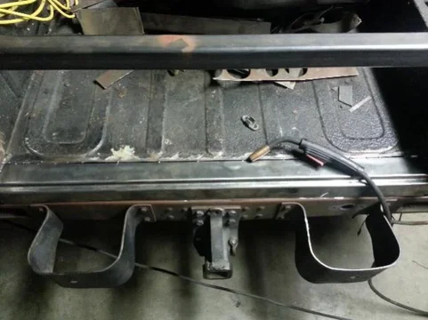

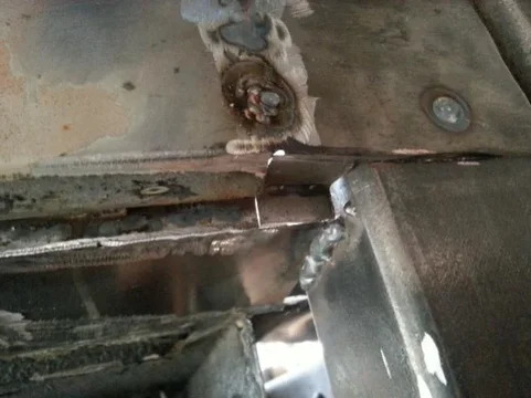

What are you going to do about that little gap between the sill and the bed floor? I'm doing this now too. The sill is suppossed to overlap the bed floor by about 3/4" and they were spot welded.
My bed floor is rusty, but I'm not going to replace it. I'm not sure it's good enough to weld to. I was thinking about adding some tabs under the sill brace piece for the floor to sit on, then weld through it to those tabs.
I was debating whether or not to include the overlap. I made the cut just ahead of it because it was rusted out. Im just gimg to weld the two pieves flush. That way protecting it from rust will be easier. Also. The guy i had make the replacement panel didnt have enough material to make the piece long enough to overlap so that pretty much made my mind up for me. He did it for free and didnt even charge me for material so i wasnt about to nitpick. And its hard to see in the picture. But he nailed the weird bend in the piece that has two different lengths. Over all im very happy with it.

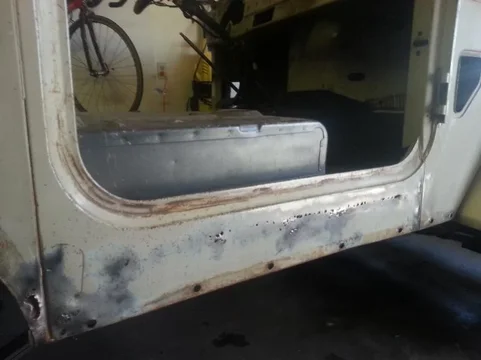

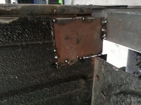

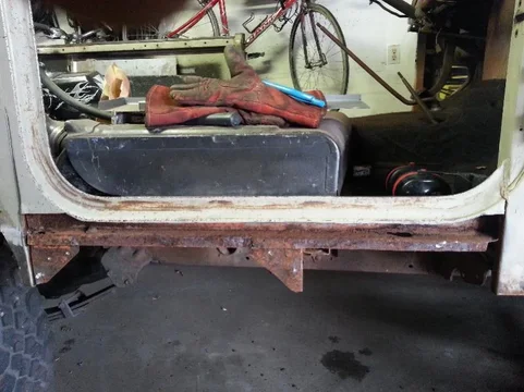

Started on removing the under door section. Cancer was way worse than i thought. I decided to cut out all the rust and build a new support structure for the sheet metal. It doesnt really show in the pictures but the sheet metal under there is completely uncoated/unprotected from rust. No wonder it has disintegrated over the years. I will probably use either angle iron or square tubing for support. Leaning towards angle iron for rust prevention. I have the replacement panels trimmedup and ready to weld in but still need to finalize the support
