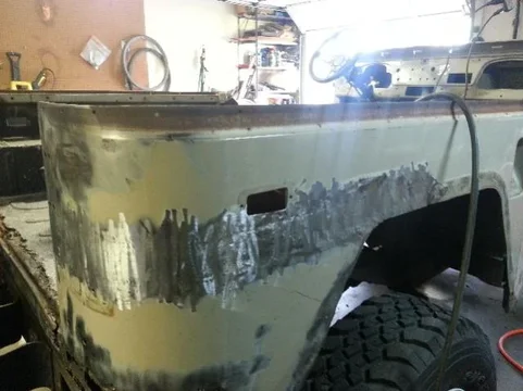

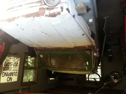

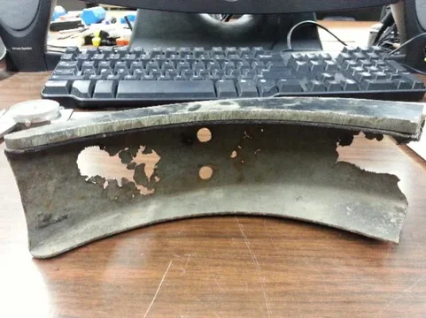

my first try at making the replacement curved sheet on the back. had lots of fun today.

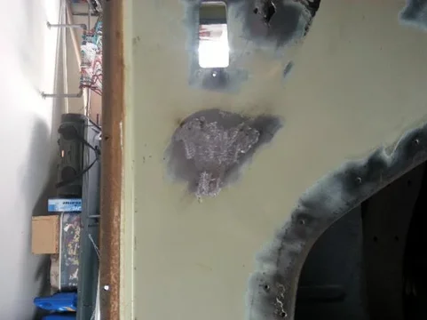

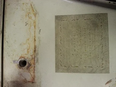

the cb antenna hole. decided to leave the dealer option antenna holes. I will probably buy a new antenna and use it there.

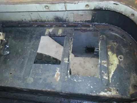

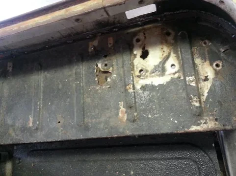

Still havent gotten the square tubing for the sill so tonight i patched skme more rust.
these are some of the panels i made before installation.

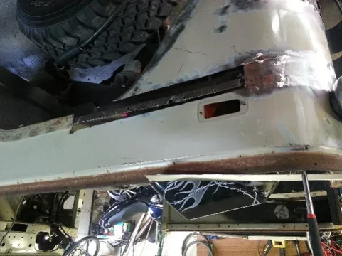

tonights work. got em tacked up.

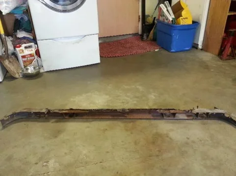

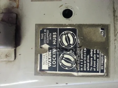

got the tubing for the sill on friday. im not going to re-use the old horns in the picture, those are going to be my templates. i will have to wait until i get some free time at work to cut those out with the plasma cutter. i took a picture of those old stickers i thought were cool. hopefully my next post will be of a finished rear sill and tub metal work.

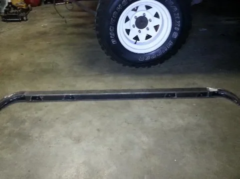

made the sill corners tonight. not complete yet but almost.
first i traced one of the pieces i cut off 4 times onto some 3/16" plate, then i cut out the rough shape using the band saw. after that i clamped them together with the pliers and used a belt sander and angle grinder to make them all the same and smooth out the corners.

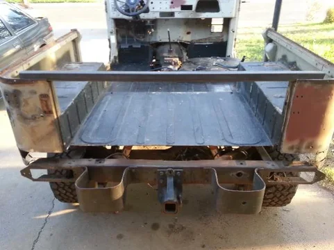

finished the rear sill and got the rest of the body panels i need done. now just need to install those panels and fix a few more spots. also need to finish up welding, i have just been tacking the pieces in since my argon/c02 is almost empty.
using the old body mounts to mock up the sill, still debating welding the sill closed

that piece was my first attempt at making a replacement panel, it was thelast of the 16ga. sheet i bought and came up a little short so ill prob end up using that elsewhere. i would like to re create the factory lip out of some more sheet. still havent completely figured it out.

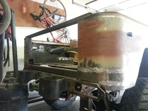

finishing up the right rear corner
cutting out more rust
