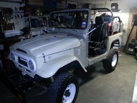

Some more pictures of the fender and then one of it bolted up.

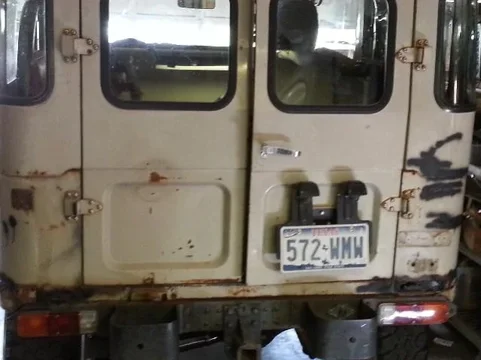

So today i got home from work and started wire wheeling some rust. I got to the top of the back doors and thought the channel that goes on top of the doors looks pretty bad, i should probably take it off and repair it. Then it snowballed into this
I love it, i may have to keep her naked for a while after i fix the rust. And transfer case....

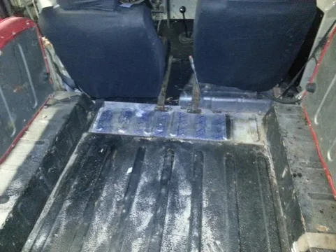

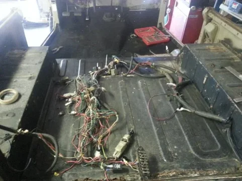

I was really happy with how easy it was to remove the fat-mat sound deadening, I thought all the tar was going to stick to the metal. It wasn't easy, but the majority of it pulled off clean. Next step is removing the brake and clutch pedals, then starting on metal work. I will have to pull the t-case off eventually to fix the crack in it. I plan on doing all the body work before I start with the engine, and I'm not sure if I am going to take the tub off the frame yet, I will decide after/during bodywork.

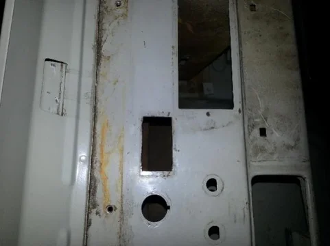

Tonight i did the first patch on the fj. I did the dash, it had a square cut out for a large switch long before I owned it, the switch has never been there. I believe that is the only non-factory hole in the dash.
here is the hole
fitting the patch piece
welding it
end result

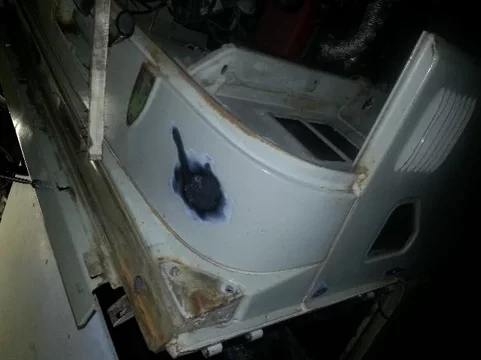

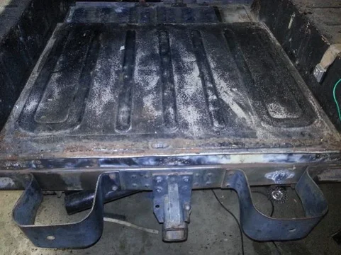

more patching. goal is to get most if not all metal work on the main tub fininshed this weekend. tall order but i think its do-able
not sure if I am going to keep the original antenna holes or not. what do you guys think? obviously im not doing a bone stock resto since my truck already has a v8, and as i understand, the antenna was a dealemr installed option, not factory. hmmmm
