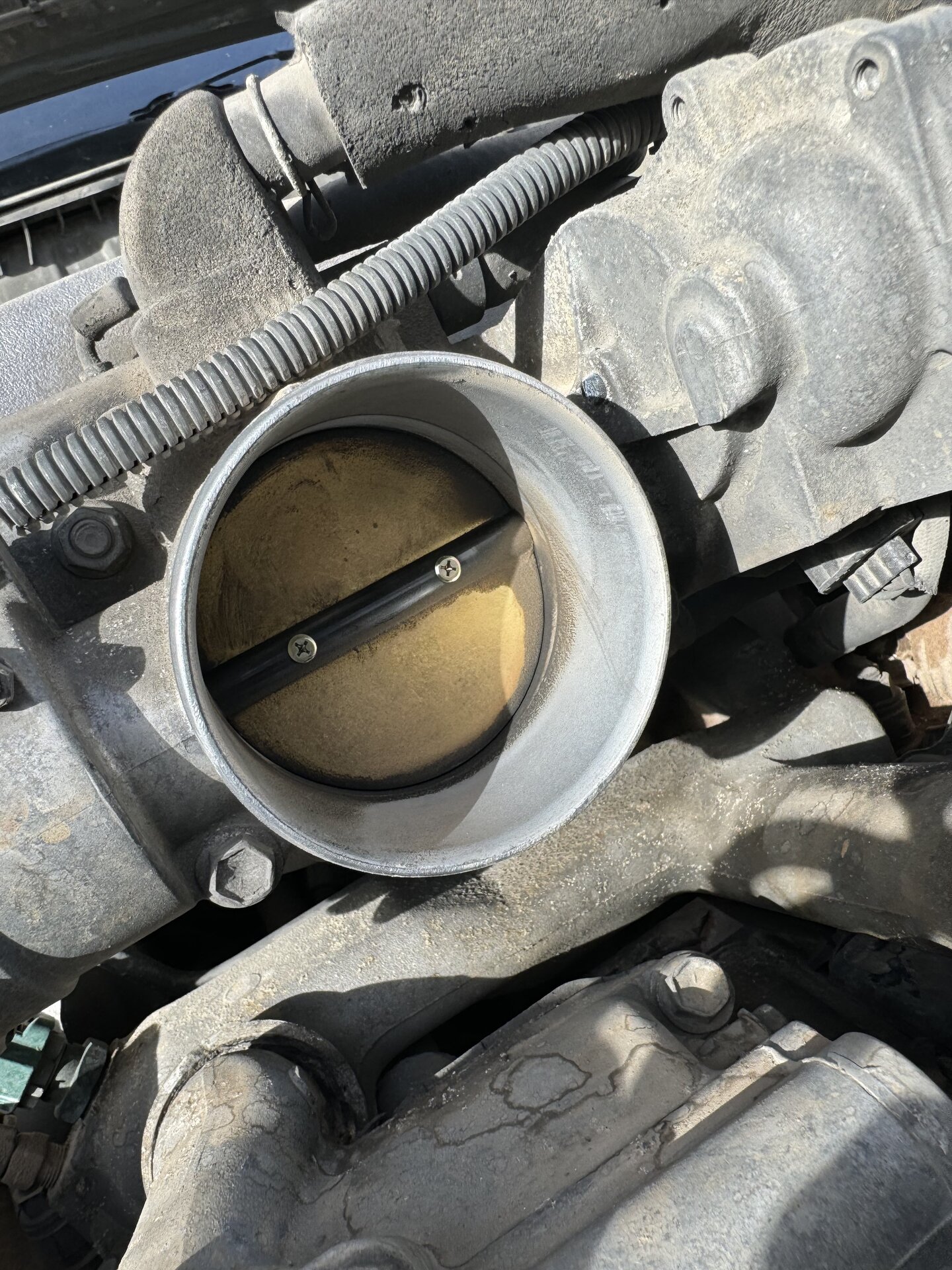

I head it up to the sun when I put in the new one and not much light was getting through. The cruiser does drive better with the new air filter and the idle is back to a good level. I might stop and get some MAF cleaner and clean the throttle body if its dirty which I suspect it is.
I'm not a pro mechanic but I'm 99% sure this is a fuel issue, I would replace the fuel filter (takes 15 minutes and its in the engine bay) and the fuel pump. I have a 2003 Honda Pilot as well as an LC100. In the Honda Pilot it did the same thing multiple times, would stall on the highway and sometimes wouldnt start, I eventually replaced the Fuel Pump at 250k miles and it hasnt stalled or failed to start in the last 15k miles or so.Unfortunately, the air filter was not the cause of the stalling. It happened again on the freeway today. Luckily I had a safe place to pull over. I'll have this whole weekend to diagnose the issue. I was able to get good readings from the MAF so I'm going to try testing the trottle position sensor next

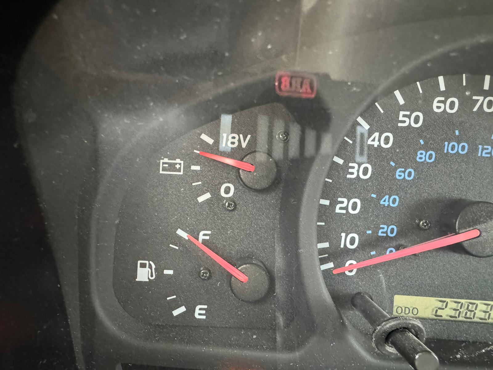

What is the gauge reading?replaced the battery and it seemed to drive perfect again, but now my battery gauge seems a little low when charging. I’m going to see if autozone can test my alternator for me. Fuel pump should be here today so I’ll replace that either way.

Well, to my knowledge, that's where it's supposed to be...mine's just a tad lower actually.View attachment 3574446
This is where it is now, but this morning it was between the middle and 3/4 mark. It didn't change when I rev'd the engine either.
