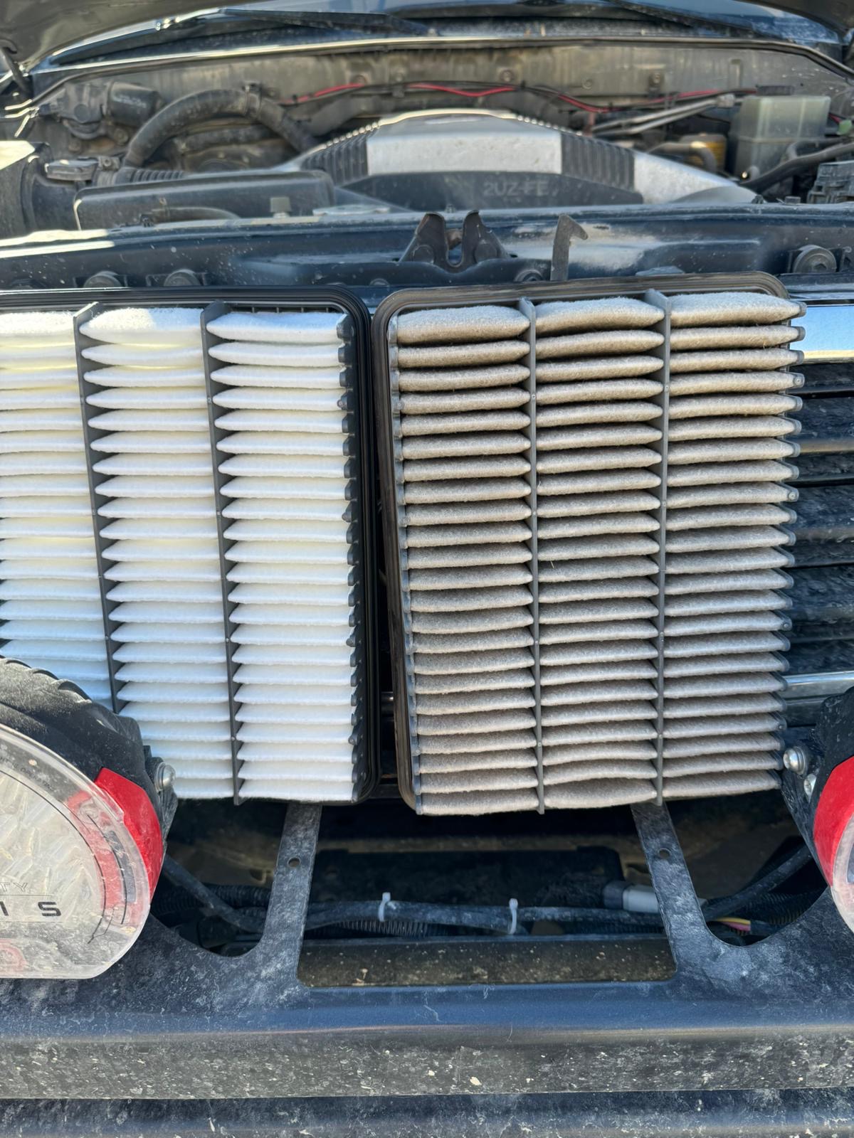

Made it home just fine, it was idling fairly low on my way to cruiser outfitters to pick up an air filter. I think it was a bit overdue for replacement…

There was a noticeable increase in power after replacing the filter, as well as it idling better. Seems to be fine for now, I’ll update the thread if it stalls again

Could be the lighting but is that just dirt or is there a fluid/oil residue in that as well?

That air filter looks fine, I was wondering if your problem would be back. In the future, hold it up to the sun or shine a light through it to really see what's going on.

I head it up to the sun when I put in the new one and not much light was getting through. The cruiser does drive better with the new air filter and the idle is back to a good level. I might stop and get some MAF cleaner and clean the throttle body if its dirty which I suspect it is.
