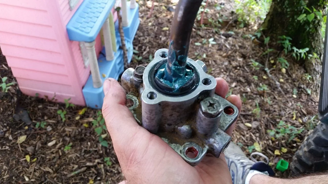

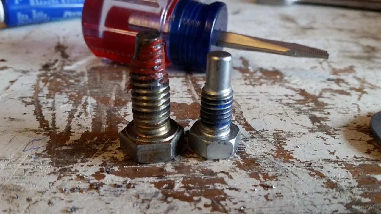

Well I jumped in and rebuilt the shifter this morning. Somewhere in its history somebody broke the shifter bolt and did a jack-leg repair.
Left is the bolt that ended up locking up the shifter at the ACC ride. Right is what the bolt is supposed to look like.

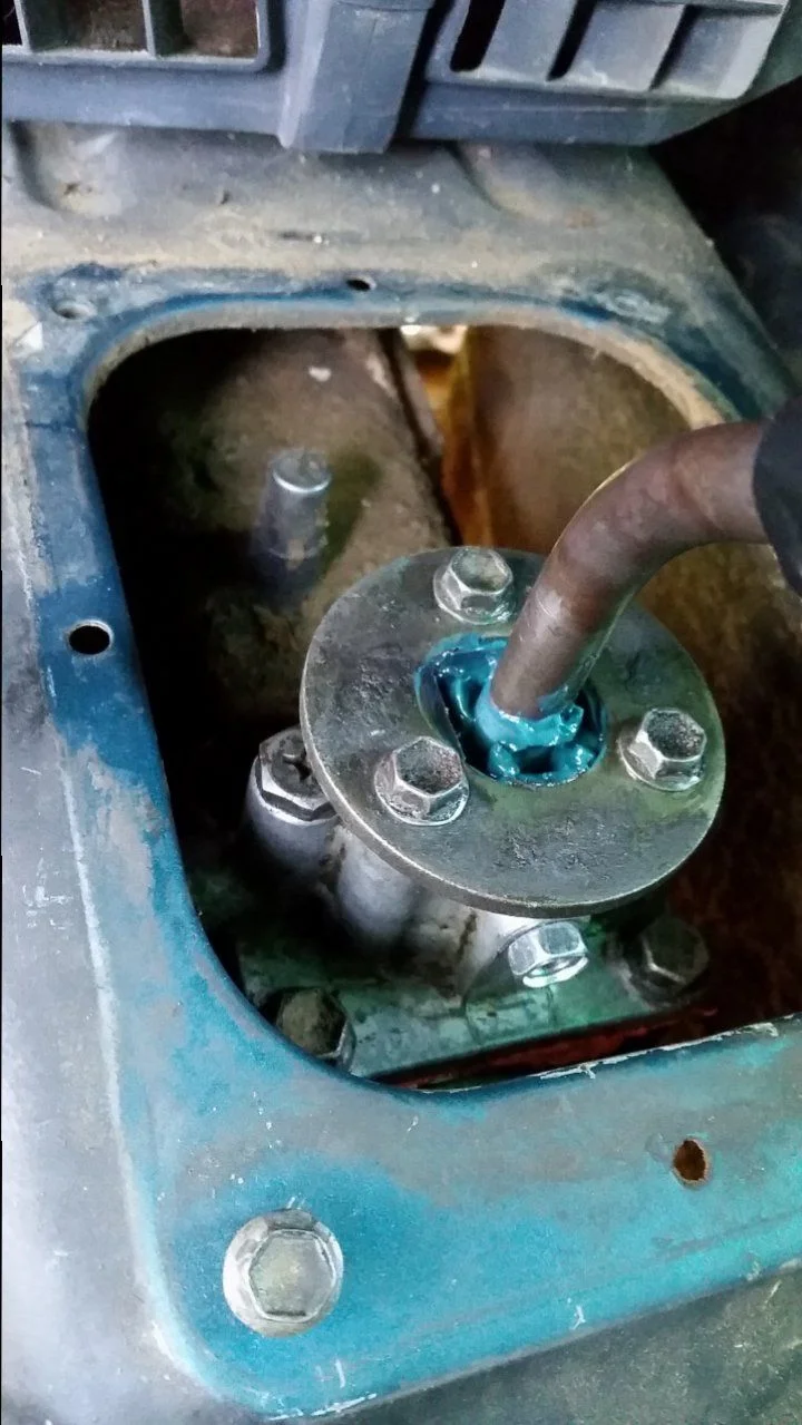

I didn't get any pictures of the process, but as you can see the bolt was much larger and the wrong pitch, so I drilled it out and Helicoiled the hole to accept the correct bolt. Then I deburred the shifter ball, greased everything and installed the new bushing and bolted the assembly back together.
Then bolted everything back into the rig.
It is amazing how much better it shifts when all the right parts are in the right places...

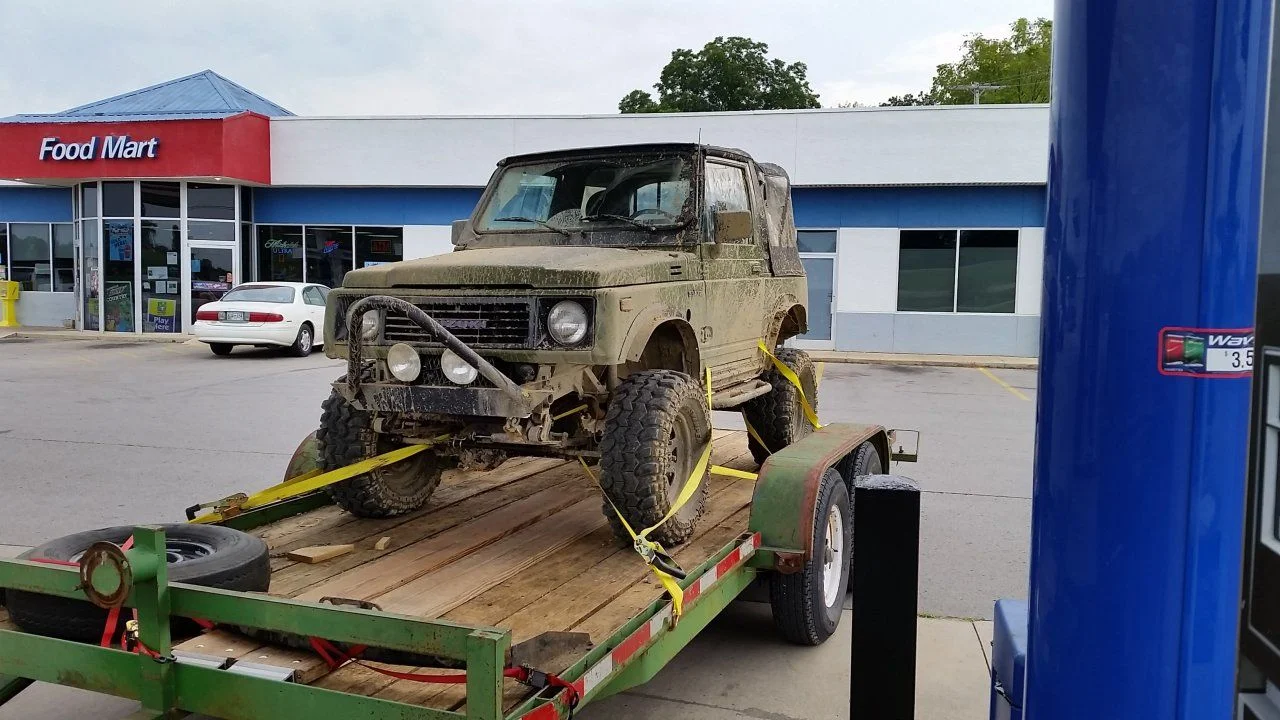

Only picture I got of it all weekend. Hoping to find a few more floating around on the interwebs in a day or two.
It went everywhere we pointed it and the only downfall was the mud run on 43? I think at the end of the day on Saturday. Deep ruts and 30" tires don't mix. Thanks to @BMThiker for dragging us out, of course his winch did more than one recovery at that little spot.
Overall, great weekend at OTMT. Now that we have the trailer, not going to be much excuse to not make more events and let this little heifer earn it's keep.

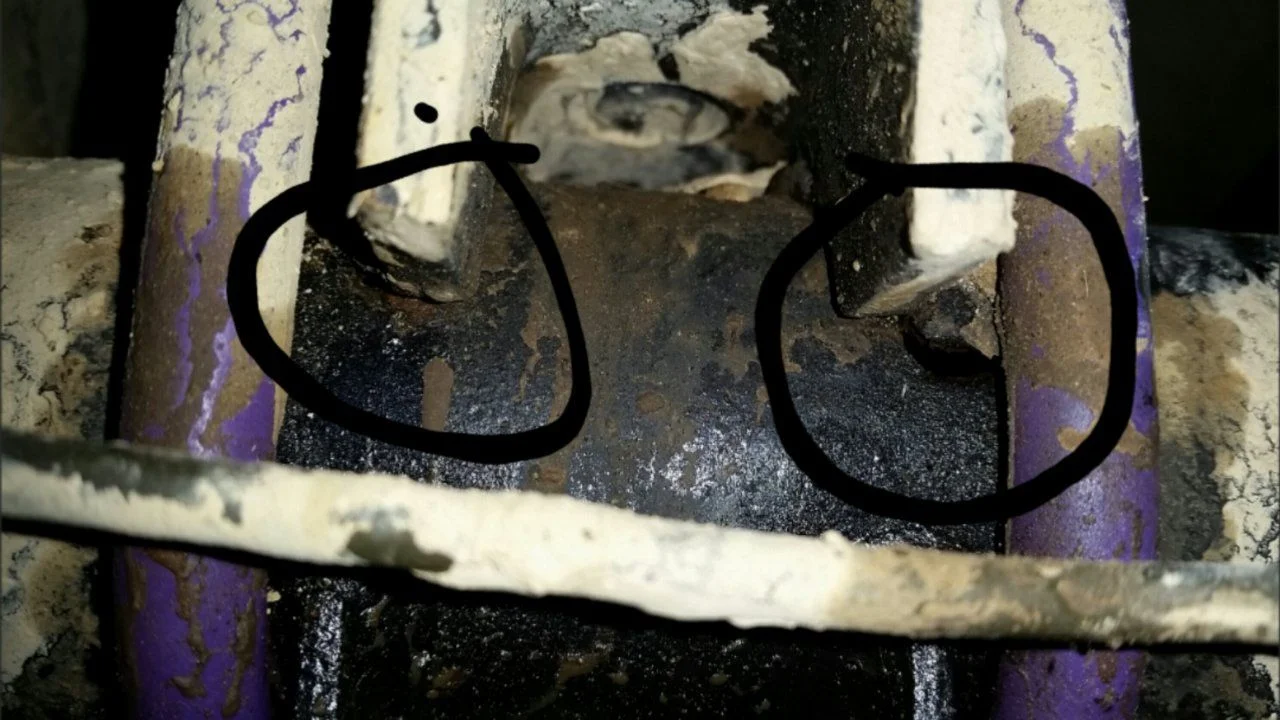

You can see the hole on the right pretty clearly, there is one on the left side as well but it is harder to see from that angle. I think it is a pretty easy fix. When I do new lower shock mounts I can weld them up and make sure there aren't any cracks or other bad news under there. Also need to reinforce the open ends while I'm at it too.

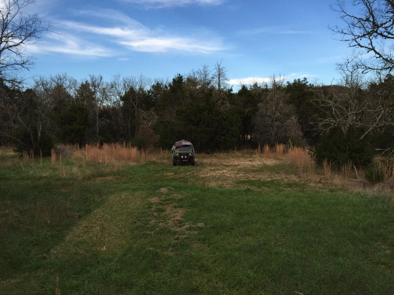

Well, bringing this one back from the dead, we spent the afternoon clearing the route for the water line, About 400 feet thru the woods. And after we finished that we decided to air up the tires and relocate the squirt. First time it has moved in over a year and it kinda bumped it up the list, so I may see about getting some parts ordered for a tune-up on both the motor and the cooling system since it blew some lines on its last ride.
Grabbed this shot while we were moving it.
And it's new parking spot.
Looks kind lonely over there, need to drag the deuce over there to keep it company.
