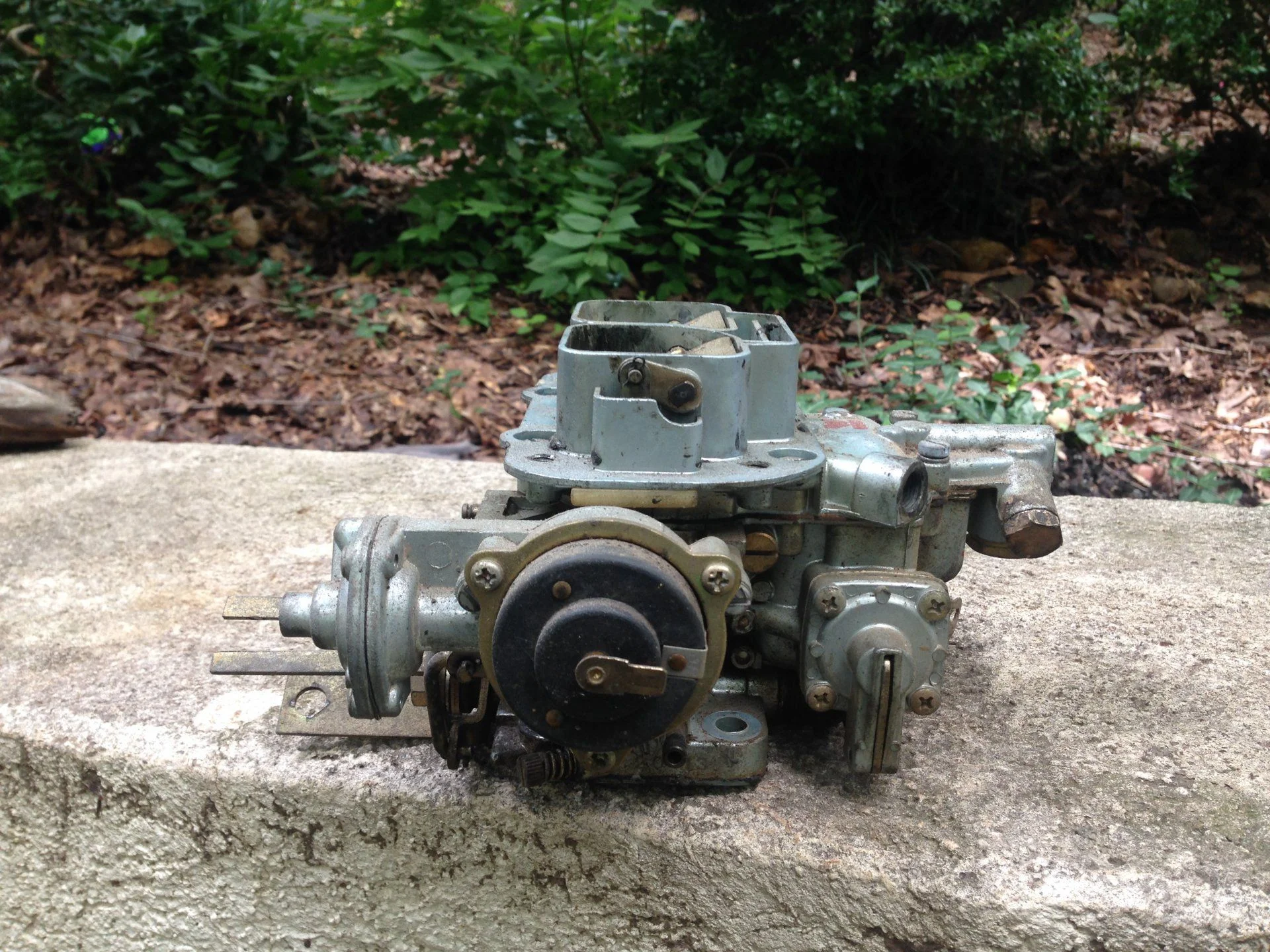

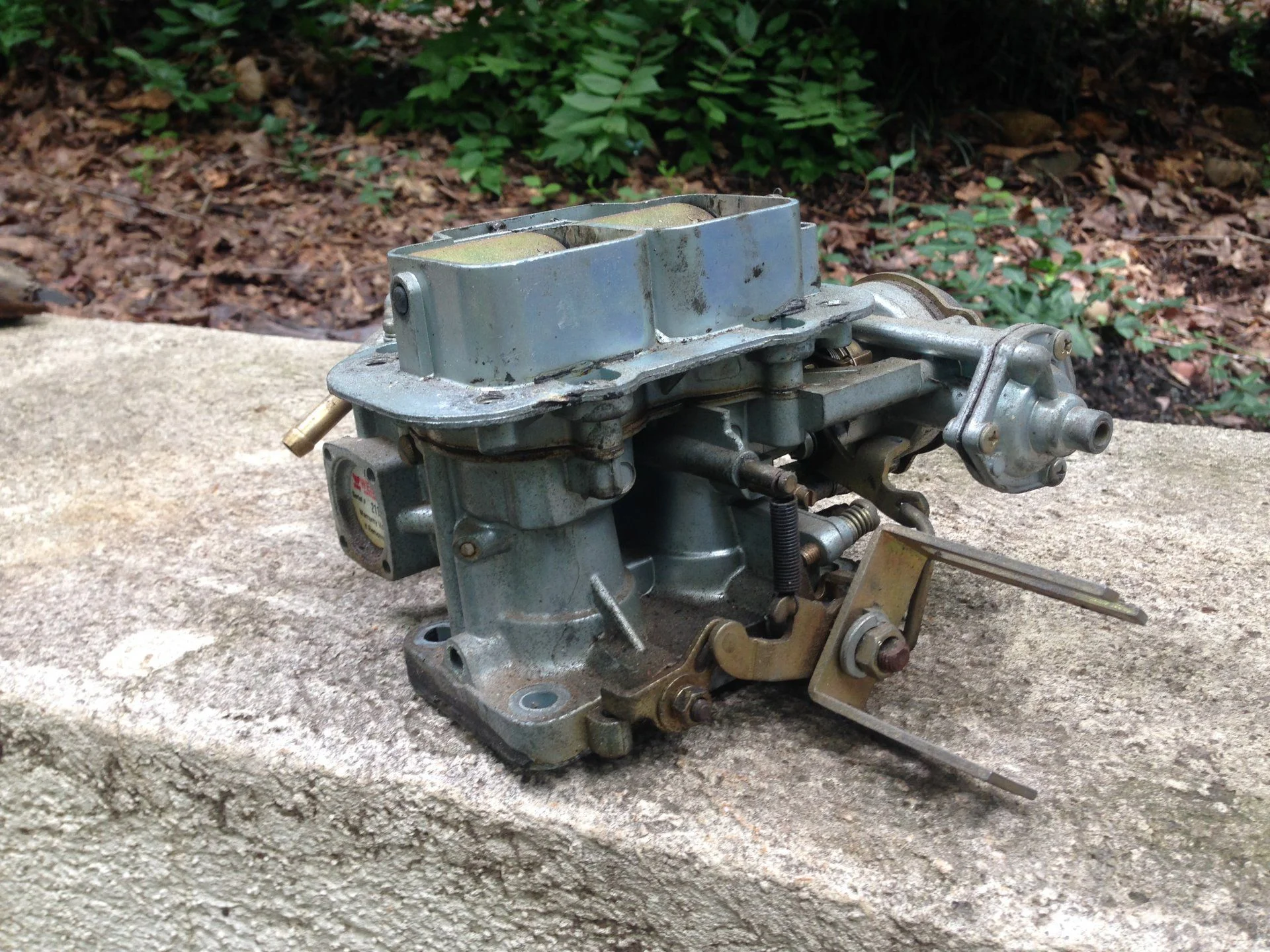

I've got a few year old 32/36 I pulled off my 22r that is just sitting collecting dust. You'd have to source the adapter plate as I needed that for the propane swap, but you could have the rest of the carb for free.
It'd be cheap to ship if you're interested.
I will PM you, but I'm definitely your huckleberry on that deal. Is it a manual choke or electric. I need a 2 piece adapter to bolt it to the sami intake anyway so that isn't a problem.

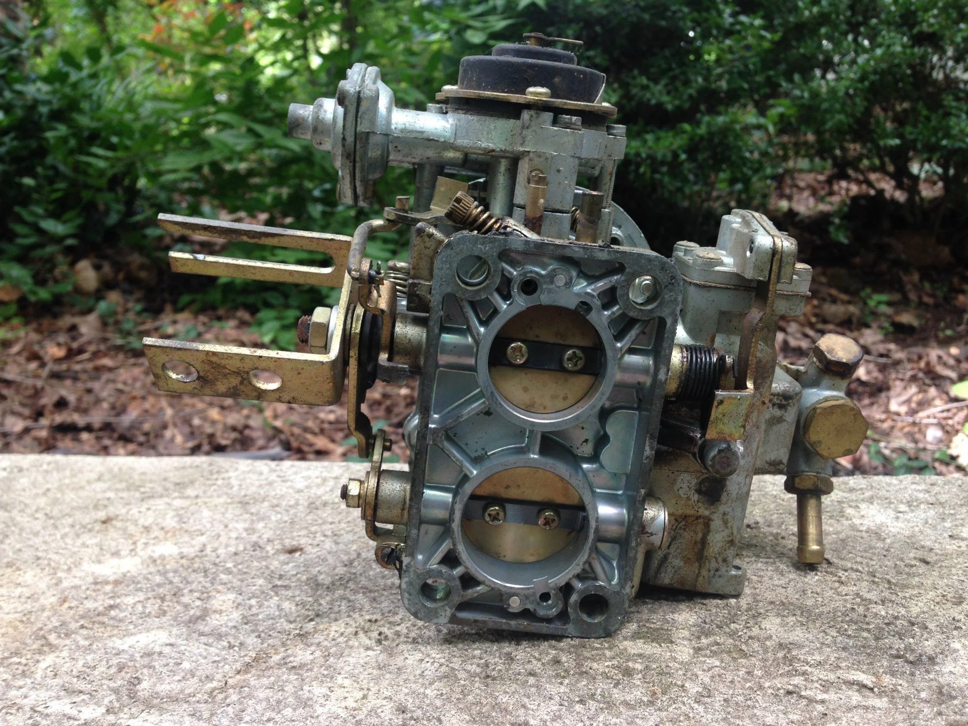

Couldn't figure out how to pm these but here are pics of the carb to make sure you think it'll work.
@tgreco looks like most of the ones ive seen on the net. I guess a 32/36 is a 32/36. Drop it in the mail and I will see if I can get the needed adapter for the intake and linkage sorted out. I will keep an eye out for any GA fellas getting close and see if I cant get these cylinders headed your way.
Out of curiosity, and I think I caught this in your build thread, but the carb works fine, just not the best for the bouncing and angles of off-roaring, that sound about right. If so, then it should suit our needs perfectly.

I don't know much about these carbs but that is my understanding. I think the only question mark would be the throttle linkage, but that may be able to be fabricated off the Sami's carb.
The carb was fine during normal driving and wheeling, it only sucked when going up steep hills (side to side angles were fine) and/or bouncing.

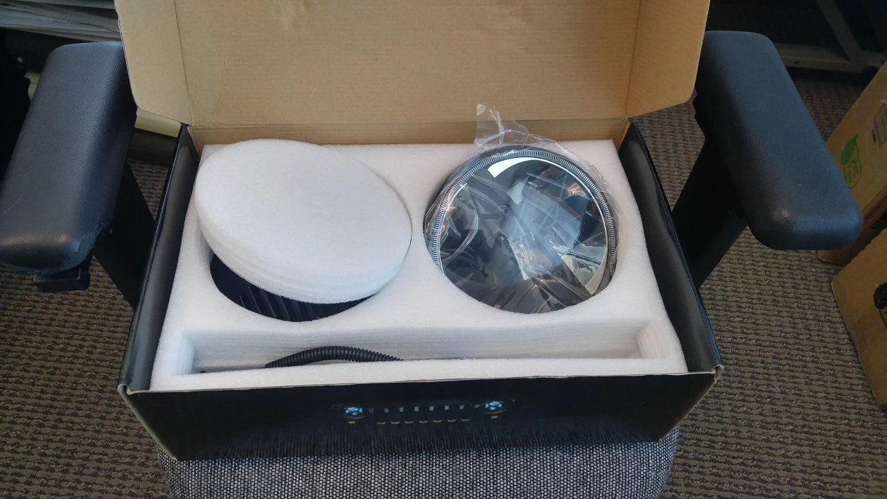

I forgot I had these puppies
Set of CityRacer LED headlights that I got for the 40 project. Well they arent going to be lighting the way for the 40 for many many moons unless something major happens, so they will be donating their services to samurai duty for the foreseeable future.

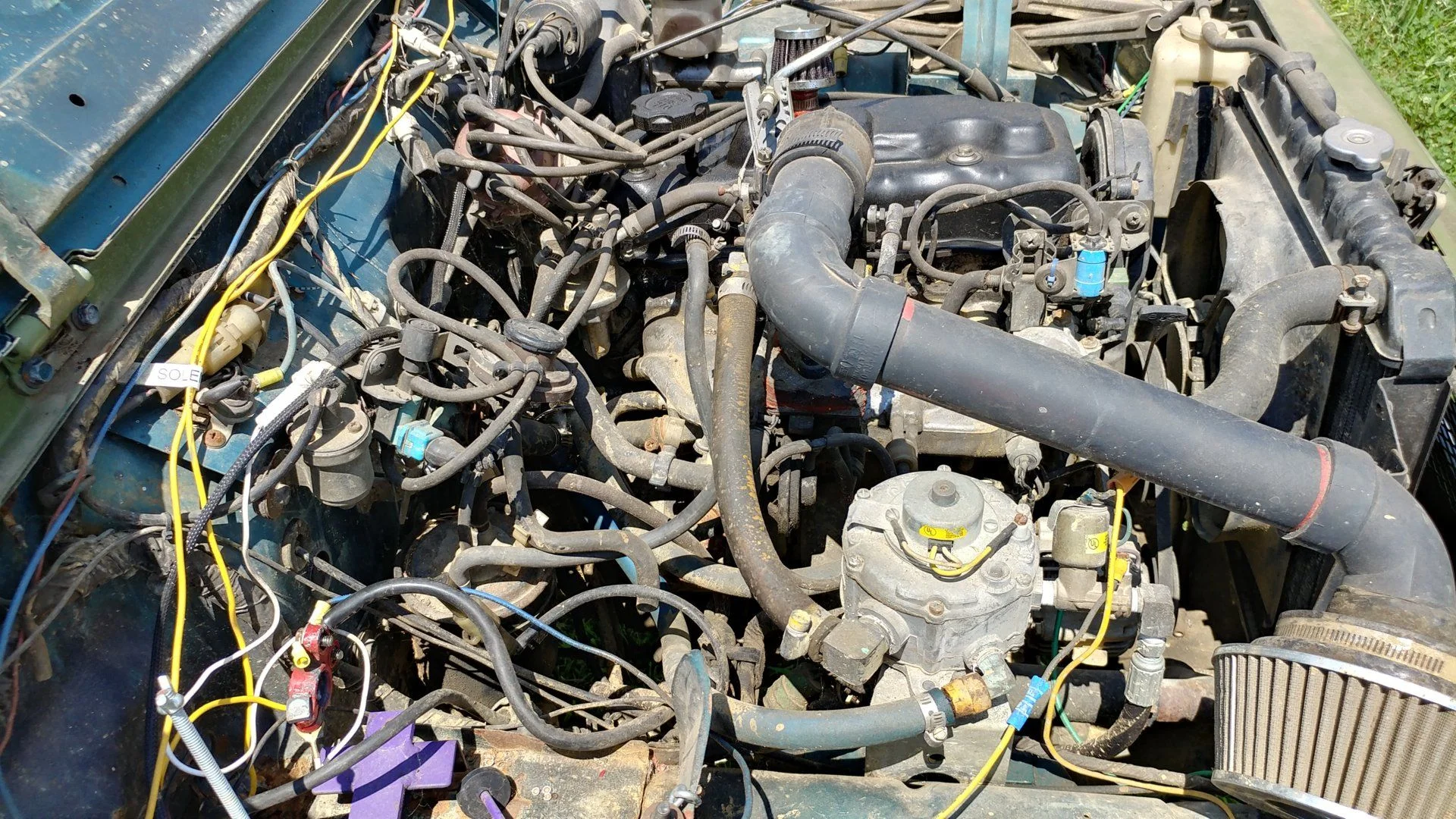

Well I finally got a minute to work on squirt. We spent the better half of the day clearing/ cleaning out a spot in the barn for future work to commence, but ran into a small problem, well as small as a complete 3FE/A440f combo is. I need to find a place to relocate it to or a new home for it, or strip it down for spare parts. Regardless, it was more than the little green tractor wanted so it is still blocking up the back. Left my hoist down in Mississippi when we got the pile because there was no place for it to ride home on the trailer.... So that kind of ended the barn session. We broke for lunch, and took the little :princess: to get some fire works for later tonight and when we got back I commenced the teardown.
We started here:
And I left it here
Biggest issue is the PO just jammed the propane setup in there and left a bunch of the wiring, solenoids and vacuum lines in there too, so I am going to have to see if I can find some vacuum and wiring diagrams for a sami so I can see what I can 86. From a lot of the pictures I have found online, I believe I can junk a large portion of this madness, but want to make sure before I go to yanking.

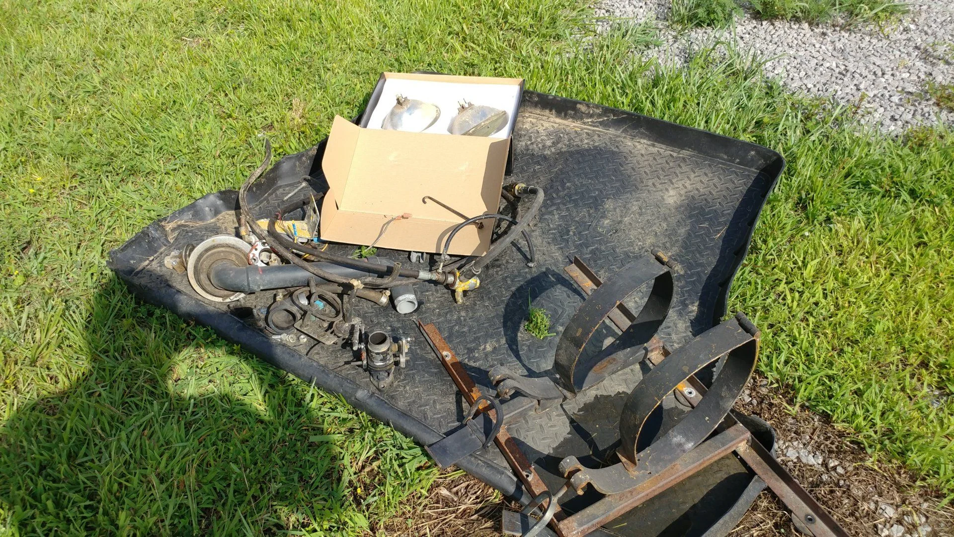

Erin was busy cleaning the tank mount and other misc junk out of the bed. This is the pile of stuff that was removed.

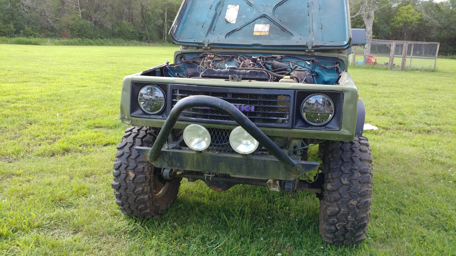

Once we had most of that stuff in a good state of limbo we went ahead and dug out the LED headlights and got those installed. They sure do change the looks of the front end on her.

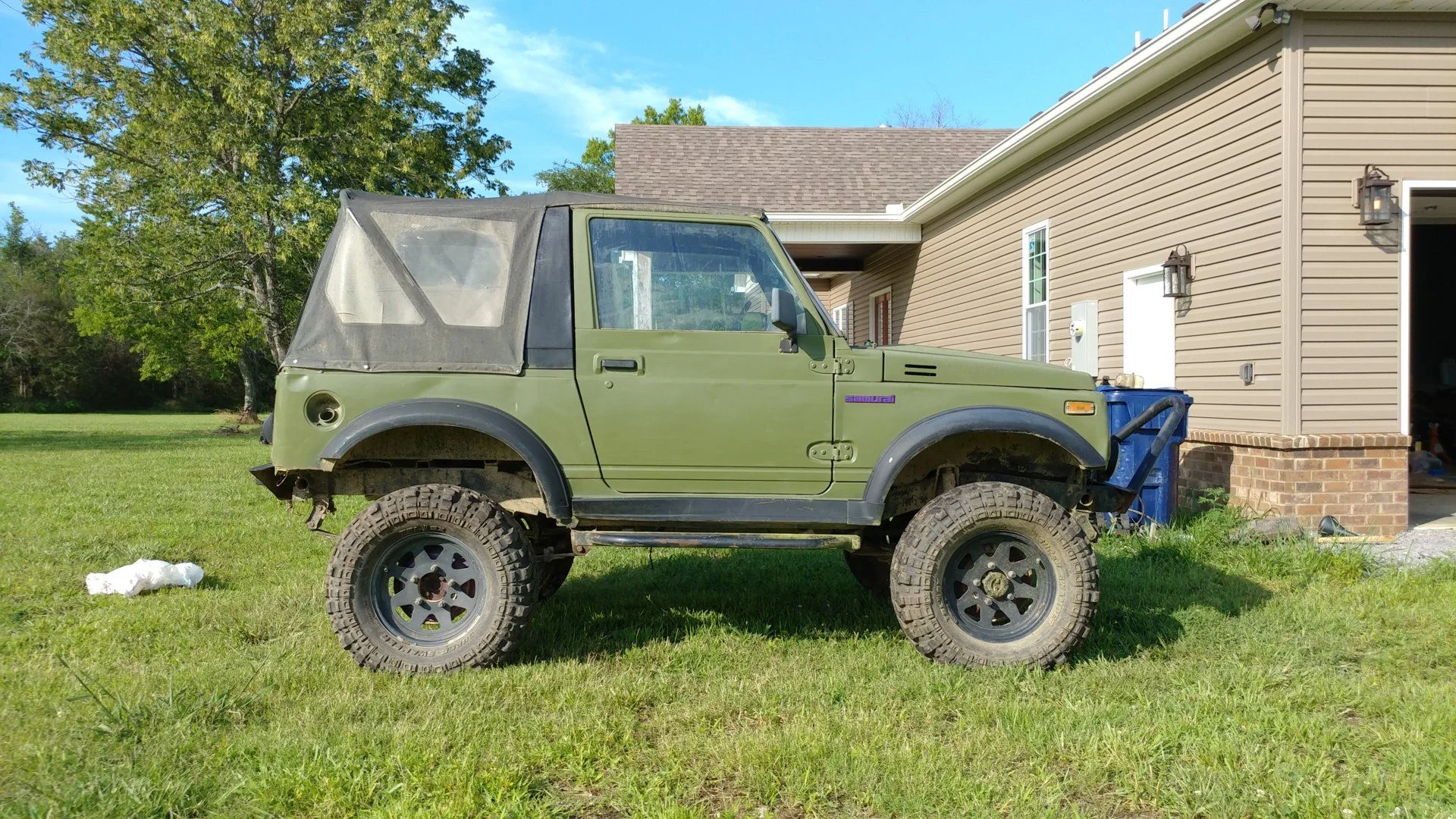

And a parting shot

Couldn't seem to get them fancy ass headlights to work and after some research I found out that the sami is very similar to the Toyotas and switches the ground to power alternate from low to high beams and these new fangled lights dont like that at all, so the new harness will fix me up.

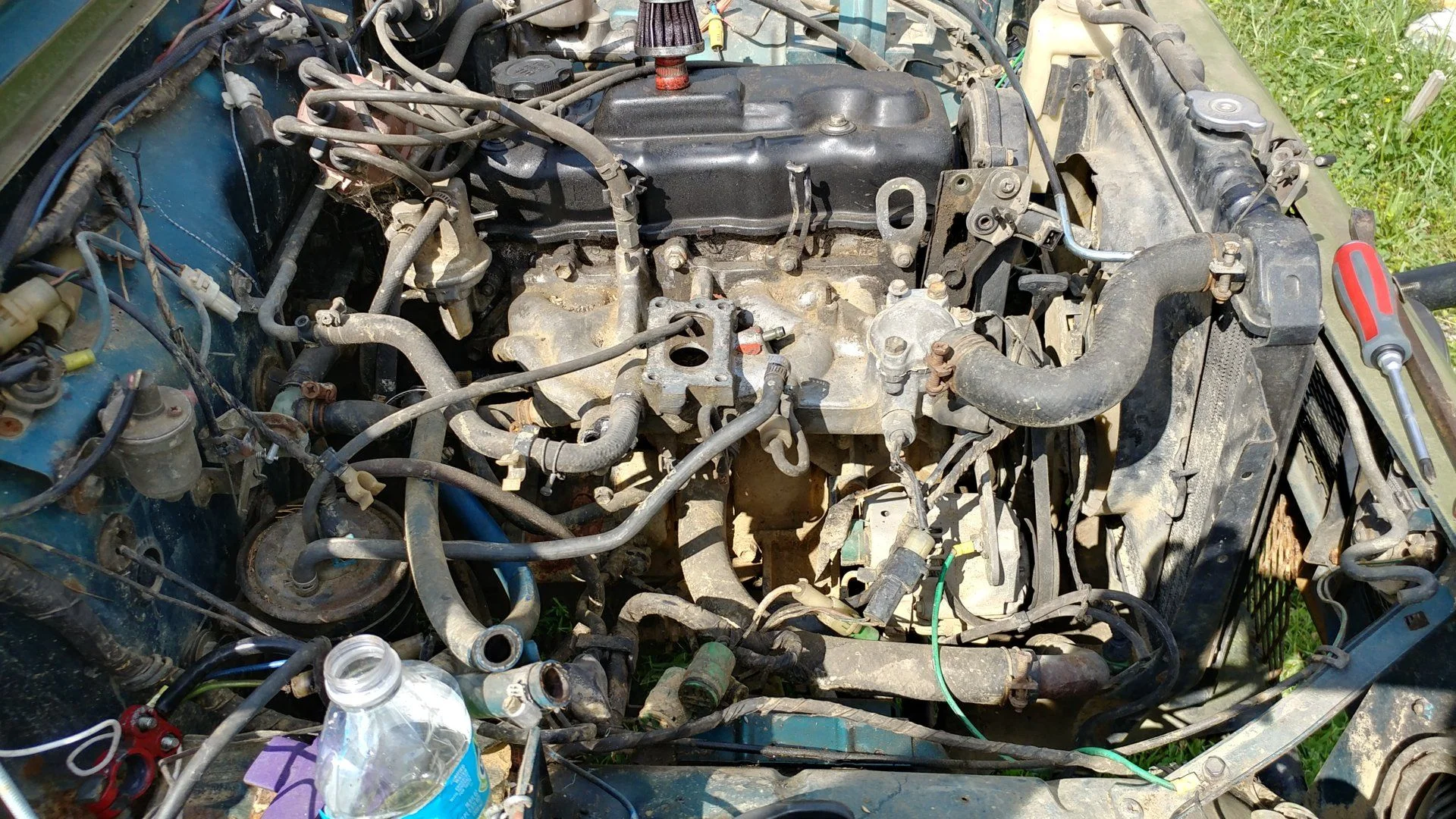

Got the rest of my tune-up parts and adapters today and I downloaded a wiring diagram and some vacuum drawings so going to see what kind of mess I can make tomorrow.
