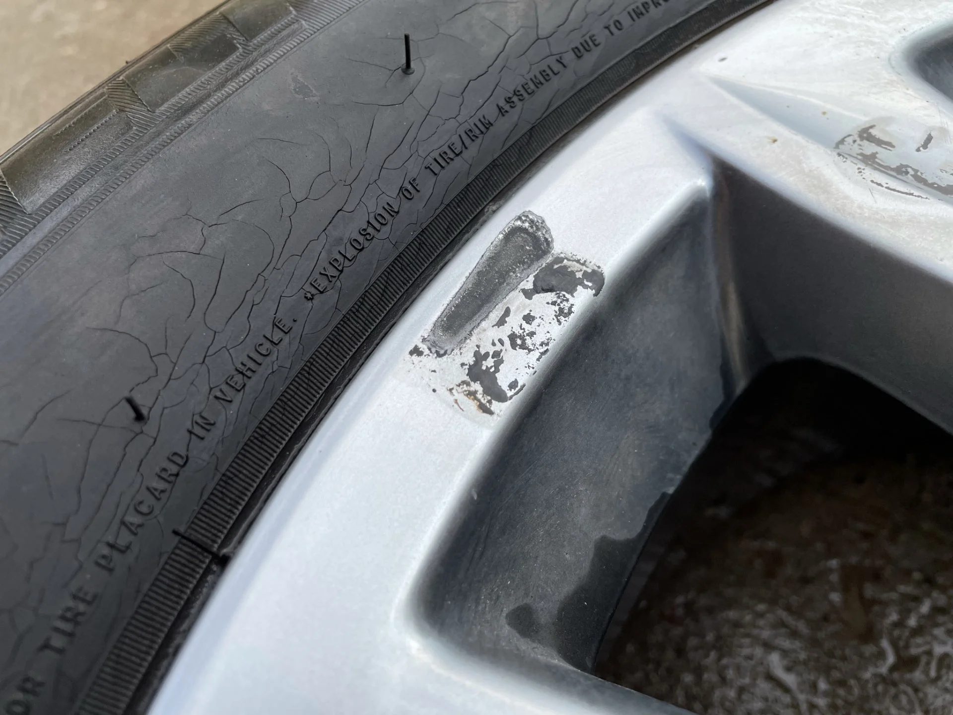

I'm getting a new spare wheel and tire but when I removed the old spare I noticed that the wheel had a spot worn into the metal from rubbing. Am I missing some padding between the wheel and the frame or otherwise doing something wrong.
...yes, I know the tire is toast. Getting a new one today!

I'd speculate that it wasn't cranked tight, so the some road grit and vibration caused it to wear through the paint where it makes contact. Nether of the spares on my 13 or 16 looked like this. My 16 had a plastic cover that fit into the lug holes but I don't think it went out that far, so I don't think it would help.

My LX definitely had rub marks there as well.. I didn't bother cleaning it up enough to see if it was worn through (I was replacing wheels), but I wouldn't be surprised. I think it's a "feature" of 20" wheels and tires that doesn't stick out past the rim much. I think somewhat of an oversite on Lexus/Toyota's part. My 17" wheels don't have the same issue because now the part that hits the carrier frame is the tire instead of the wheel.
I suspect that is the case. Fortunately I'm replacing with an 18" wheel today.
Same on LC with 18", there is a round rubber piece that is molded to fit into the wheel lug holes and extends about half way up the rim, but it doesn't extend that far out to the edge. When it's cranked tight, tire/wheel should not move.

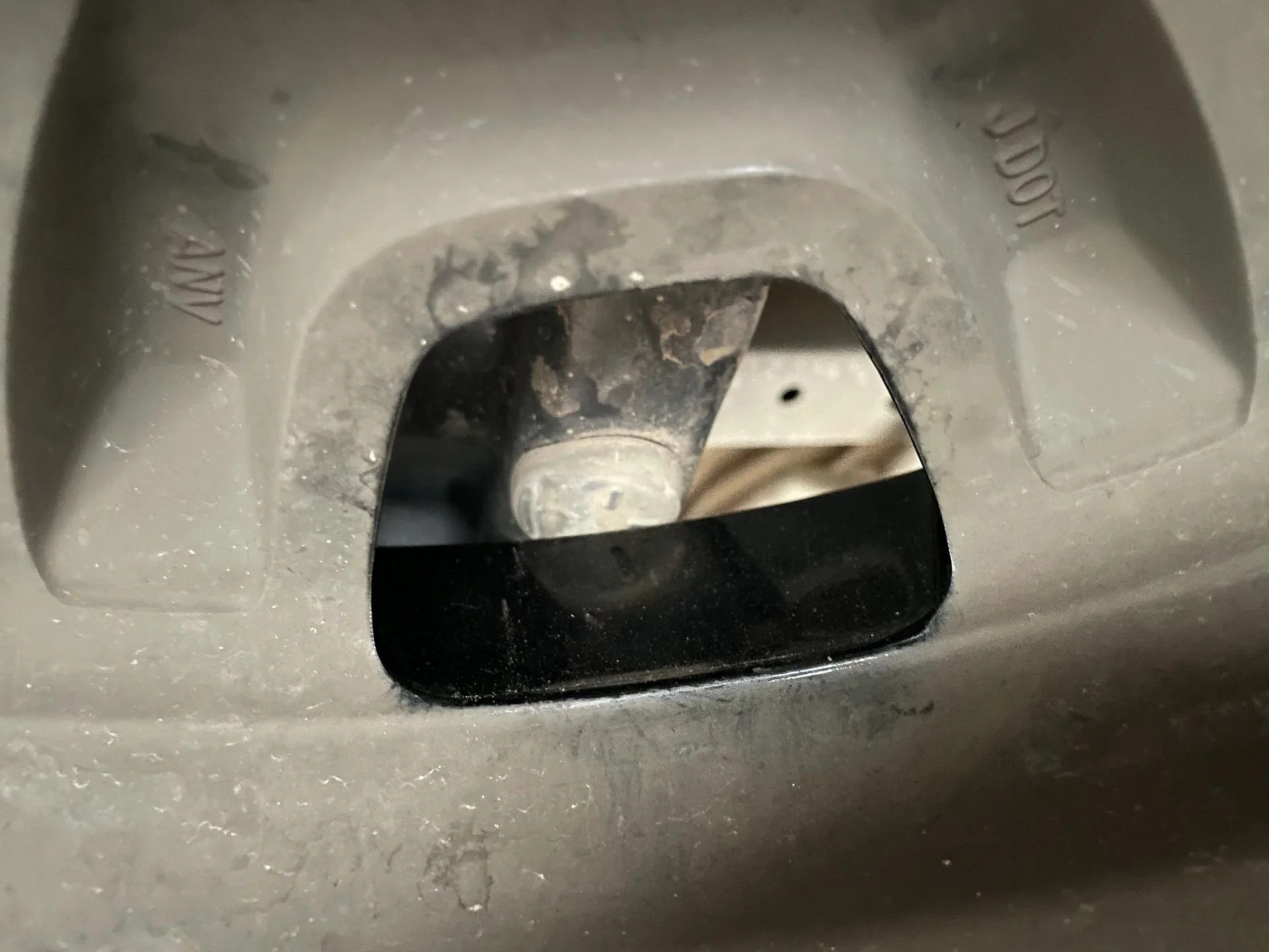

Here's the culprit. These rubber bumpers are what the wheel is supposed to rest on when snugged up (viewed from below). They are surprisingly thin rubber. I just rotated it 180 degrees, but it probably won't match up with the 18" wheels anyway. The slot makes me wonder if it is adjustable.
OK, I couldn't stand it, so I crawled underneath again to see what was going on. I always thought that the tire itself rested against the crossmember, but the tire does not touch. The wheel rim is the only thing that touches these rubber pieces. I removed the two middle ones (they are slotted but not adjustable) and the remaining ones sit OK on my Tundra wheels (YMMV). If you look at my original post photo you can see the rubber stuck on the rim next to the worn spot.
Again, I am surprised at how soft the rubber is and I will probably replace them. Anyone got a part number?
