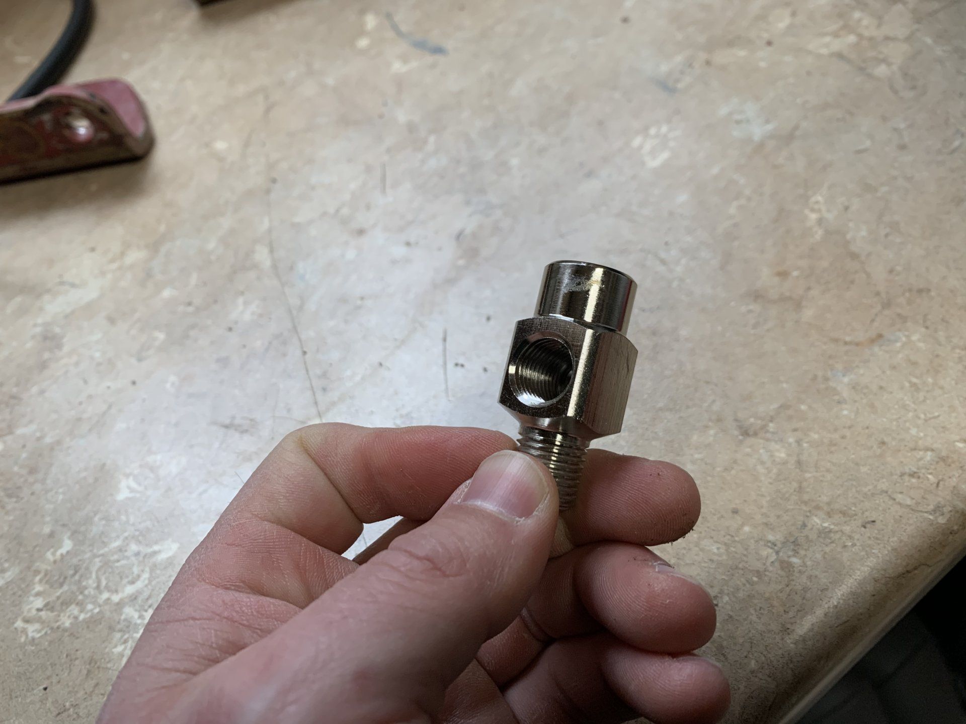

Cleaning off my work bench and found the fitting for the pressure switch for my ARB compressor. I must have tossed the switch because I can’t find it.
My compressor runs fine. Why do I need it? I don’t have lockers or an air tank.
When I get out to air up, I turn the pump on and let it run to pressure cutoff. Then I don't have to come back into the cabin. Simply connect the hose and air is ready.
Without the switch, what prevents the pump from exceeding it's rating if dead headed?
I defiantly shuts off at some cutoff. My local 4 wheel parts has the switch for $12. Easy choice so I can stop worrying about It.
Thanks 🙏

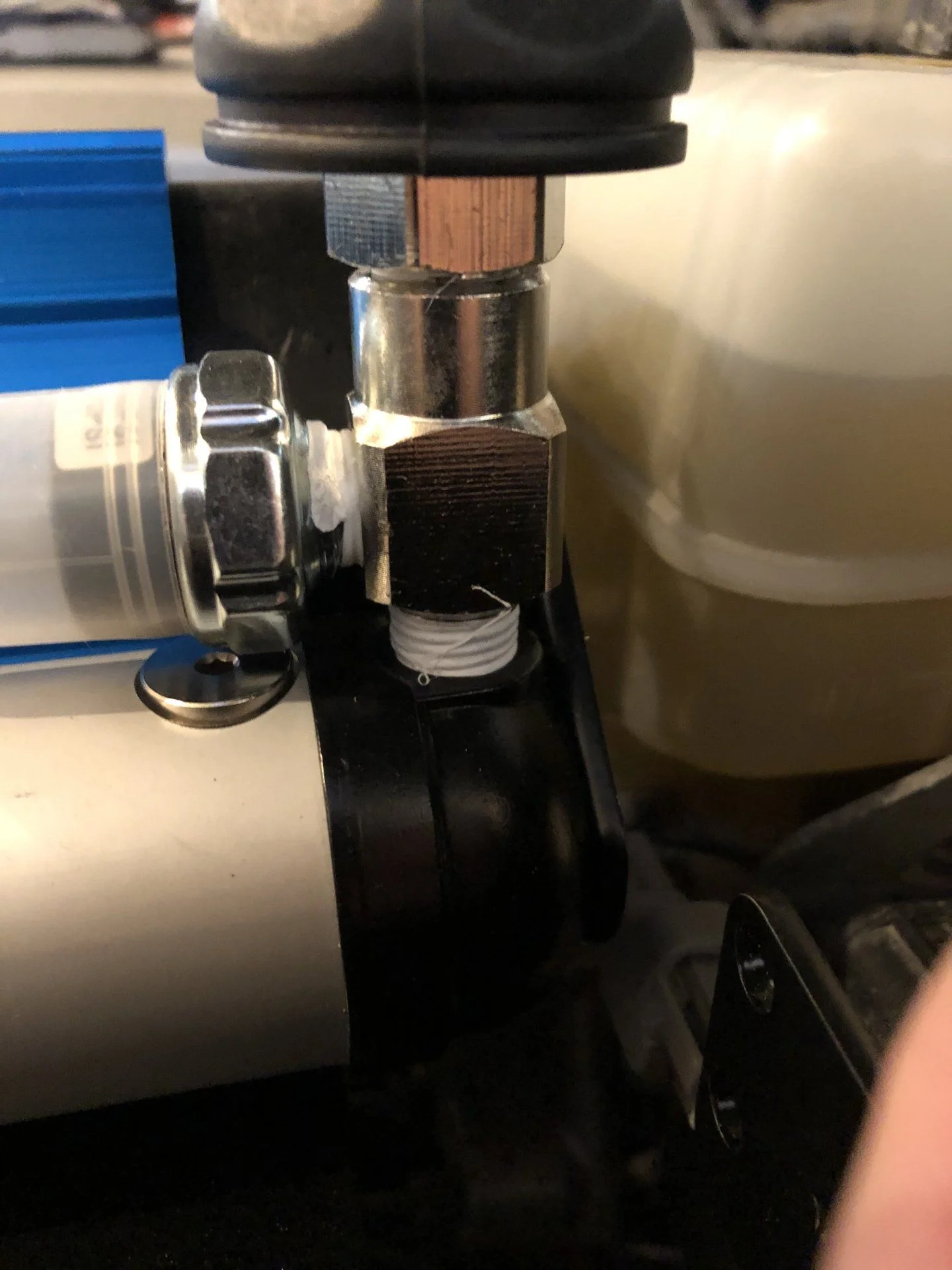

I just installed an ARB single compressor with the air up kit, and it had one of those in it so you could install both the pressure switch and the air hose quick attach coupling in the single port on the compressor.
^^ This. Your pressure switch is probably just on the second port. If it's turning off then it's working.

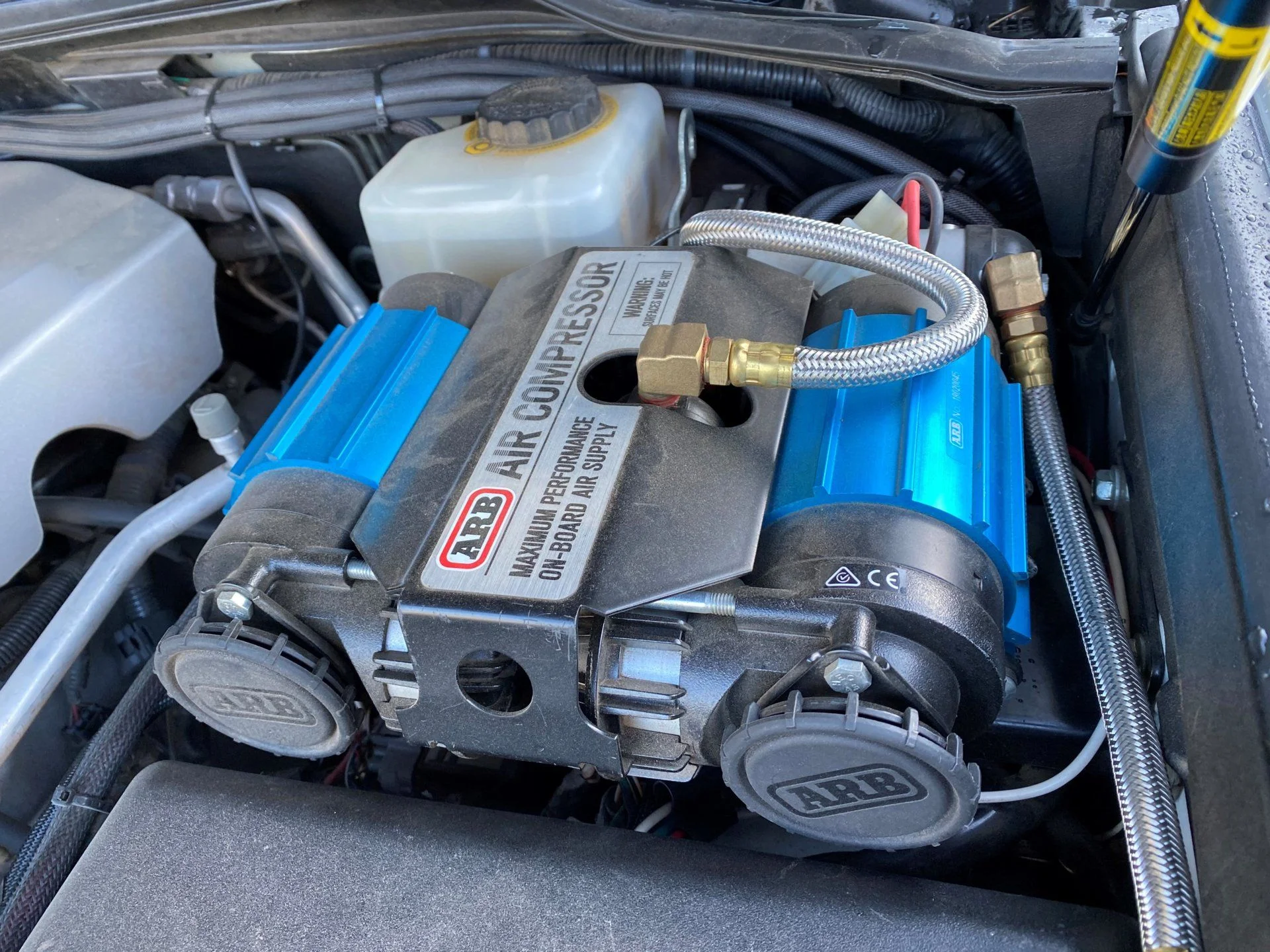

it’s defiantly not since I didn’t install the fitting. The chick is connected right to the manifold.

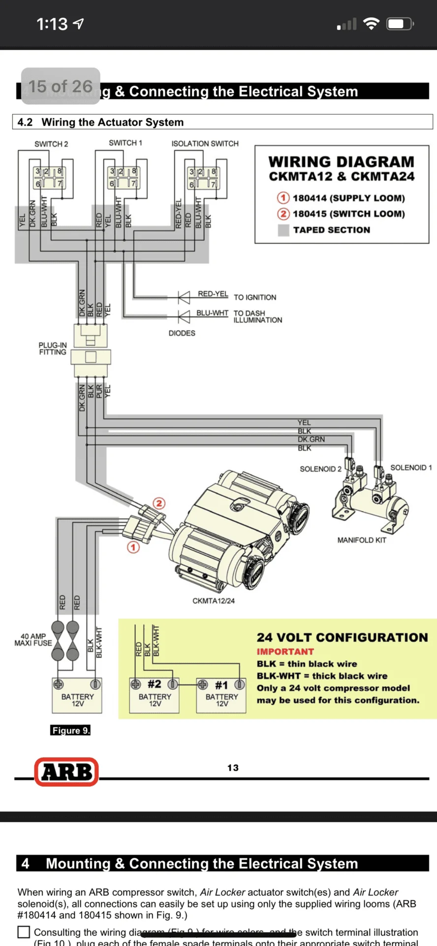

I remember being confused because the install guide makes no mention of it.
I believe the pic from @CharlieS is a single compressor. If you have a twin then it's pressure switch under the shroud. Just checked mine and I don't have a visible pressure switch.
