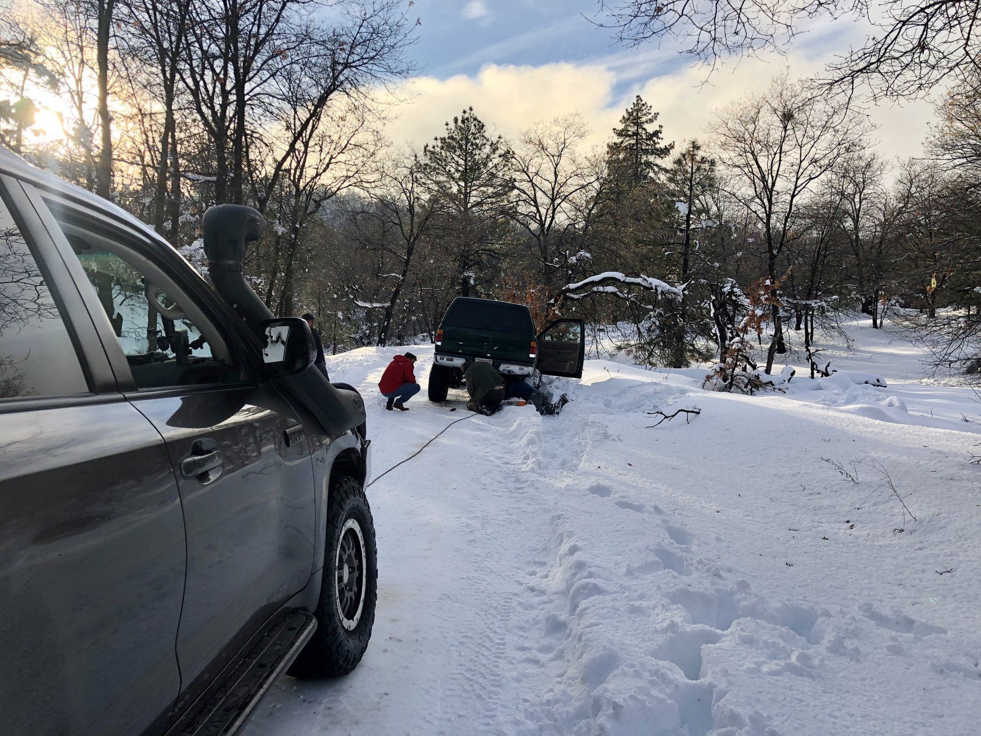

Not picking on KO2. They are great tires. Just really scary on ice. Discovered 2 weeks ago that Ridge Grapplers don’t do well with icy stuff either, (and pretty much no ATs do). In our local mountains recently, while recovering one truck...truck after after additional truck hit a small partially icy bit above where we were helping the first...and they slid & got stuck immediately exactly the same way. Lucky for them, it was a slow, access road at low speed. We did 5 recoveries that looked ridiculous there...because it was a very tame looking stretch.

***If your shoes/boots slip anywhere on the road, your tires will too...and tires can be worse, because they can push through a top powder to find ice just below. So have a look
Here a very tame looking spot from 2 weeks ago:
-Mostly grippy snow...but just one strip of it got icy-slick in narrow strips and boom...
-5 separate trucks couldn’t get out without Maxtrax or winch. My ATs were slipping too:
Tame:
Another time in Wyoming, I nearly rear-ended a Sheriff vehicle in Jackson’s Hole. -Not snow covered streets or chains required. -Just enough icy sheen so I couldn’t stop even at super low speed...with KOs. Just be careful and don’t rely on whether they say no chains. If it’s cold enough for ice.
