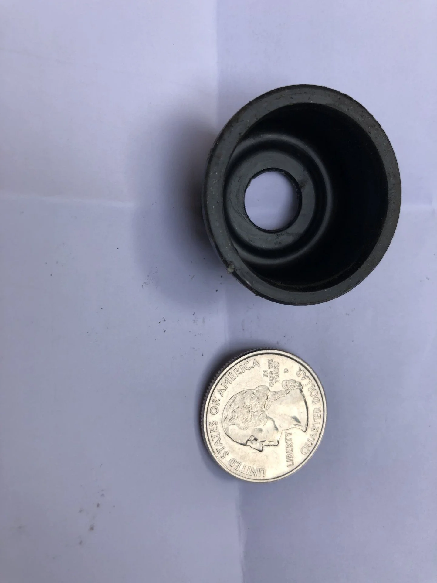

Removed one of the bottom shields and found this item lying on it. I have put a quarter next to it for a size reference. Does anyone know what it is and where it goes?
Is that a rubber boot, or a metal guard or something along those lines?

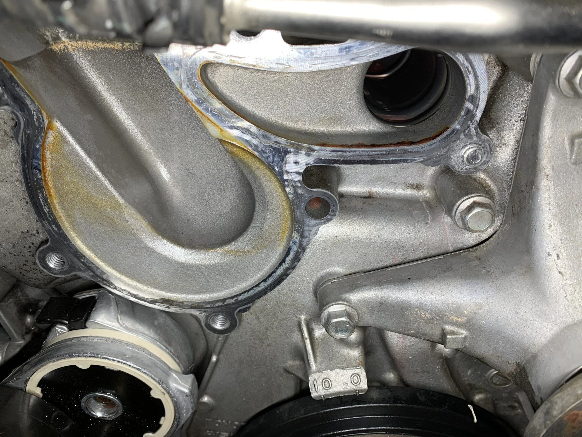

Thanks everyone for the help. I was able to finally get the broken bolt out with some vise grips on the one thread that was still sticking out. My local Toyota dealer was not helpful in sourcing the bolts so I matched the original bolts at a hardware store. I’m not sure of the correct grade, but I bought grade 10.9. I can confirm the correct thread pitch on all three is 1.25.
Before I reinstall the water pump, I’m wondering if I should address the metal surface that the gasket attaches to in the photo below? It feels a bit rough and uneven. I also noticed a bit of rust. Maybe a light polish with a dremel?
