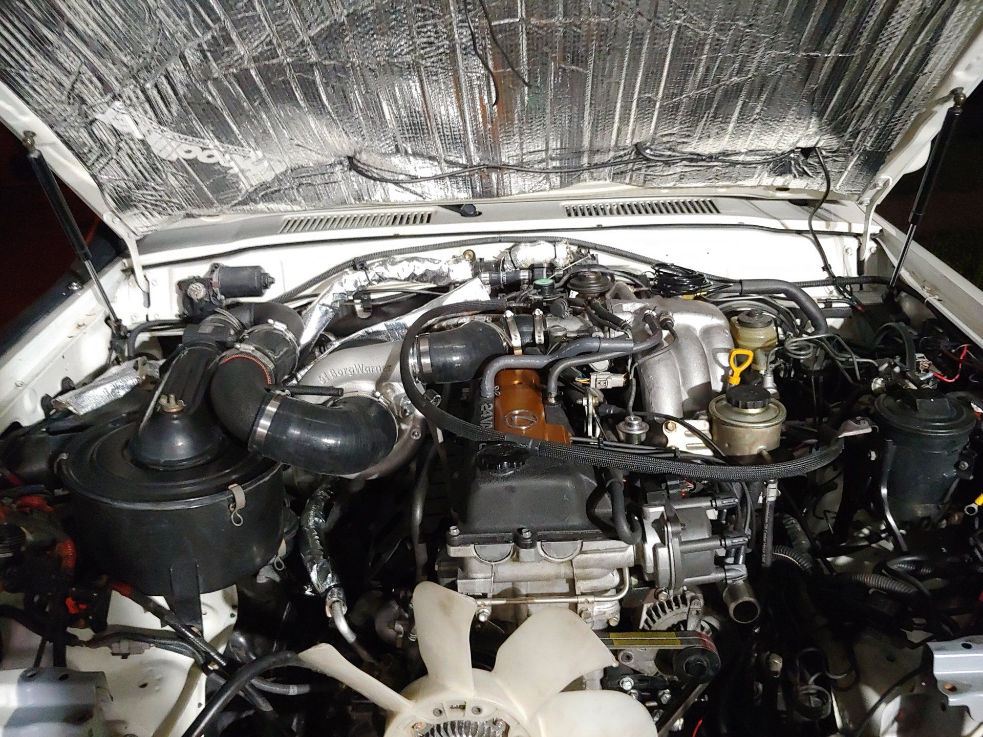

Photo- chair quarterback:
Is the air intake hose to the turbo touching the air filter chamber? You want a 1/2” space or it will rattle in reverse/ low rpm.
I clocked my turbo another 1/2” towards the engine, gained a bit more space for the throttle cable.
Not sure if it's touching but I will check tomorrow to make sure there's a little bit of a gap. Might need to trim more if it's going to rattle. My Turbo is clocked as far as it will go. I placed the turbo on the J pipe and snugged the bolts down. Then I put all the hoses and applied pressure downward and tighten the turbine housing bolts. It won't clock further down at this point.

Attached the down pipe, waste gate, turbo blanket, exhaust bracket and all the intake hoses. I need to tweak the hoses a bit more for better fitment.
Changed out the power steering hoses too since they look 20+ years old.
