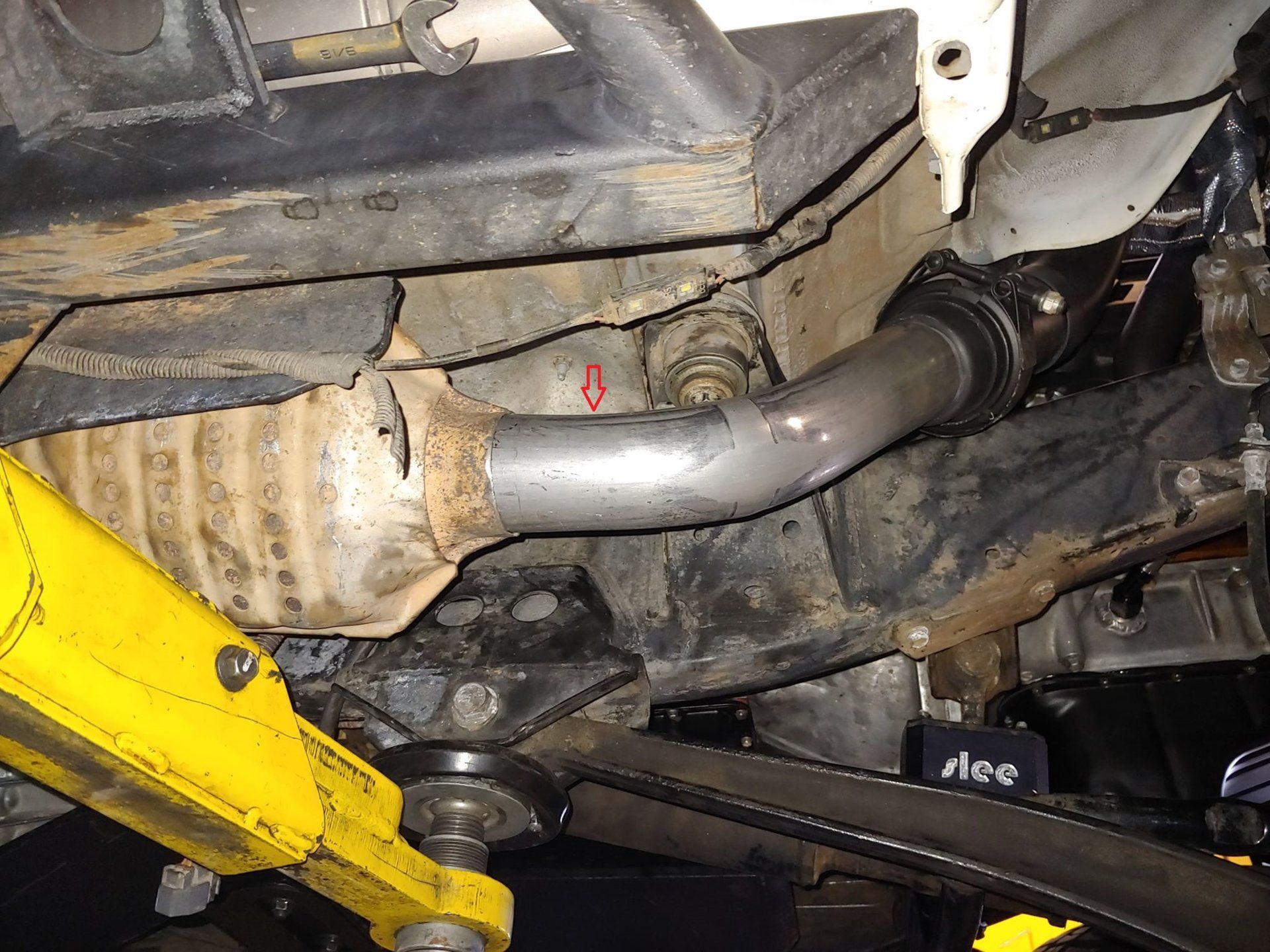

Finished my exhaust at my buddies shop. The bend from the factory to the new shorty downpipe was way off. Not even close to bend it to meet together. So we cut the original pipe right at the factory weld in front of the first cat. My buddy is a wizard when it comes to bending custom exhausts. He had one shot to bend it 60 degrees and knocked it out the first try. It fit snug in Joey's shorty DP and into the original cat. Originally we were going to go full custom exhaust and we bought a new muffler (Allied StreetMax https://team-allied.com/rt-4064-team-allied-street-series.html) and the delivered it to the shop. Only problem is they sent the wrong one and sent the small 14" body muffler and not the 18" one. I wasn't waiting till Wednesday to drive my truck. M,W,F are the only days they go to their smaller warehouse for a restock.
So I went back to my old plan on using a good used OEM muffler. Cut, fit, weld and it's almost as good as new. I replaced all OEM exhaust hanger bushings since they were all completely cracked which is what cracked my muffler and cat at the welds.

Is there a reason you relocated the upstream O2 sensor?
Notice the pipe. It's not factory. we cut it completely off. I cut out the bung off the original and rewelded it in. I put it in as close to the original location as possible. slightly further over since it was so close to the firewall. if I were to do it again, I would move it down closer to the front of the cat. The upstream o2 harness is right behind that body mount.
Is this the O2? If you are concerned about passing smog legally with presumed turbo CARB approval, O2 sensors must stay in original location and orentation. (I understand not everyone cares. Just sharing info.)
Ok I just realized I accidently put it in the wrong spot. Wtf. Oh well. It's staying there for now. If I have problems I'll have another pipe bent.
Either that or I'll weld in another bung and buy a block off plate for the one i put in the wrong spot.

Maybe just cut and flip the pipe?
Won't work. pipe was bent specifically for that position. Plus it's easier to just drill a new hole and weld on a bung. I can do that myself at home in less than 30mins and cap off the other bung.
Or I weld on a wide bang bung ontop of the wrong one and install this EGT sensor. I wanted one of these anyway, but I really don't need to know temp of the exhaust. EGT Exhaust Gas Temperature Sensor Module Combo Kit
