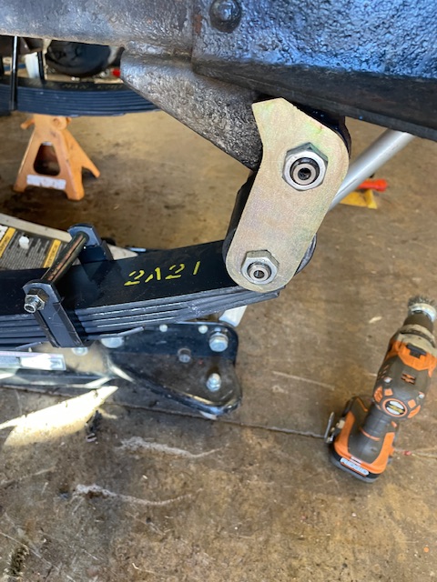

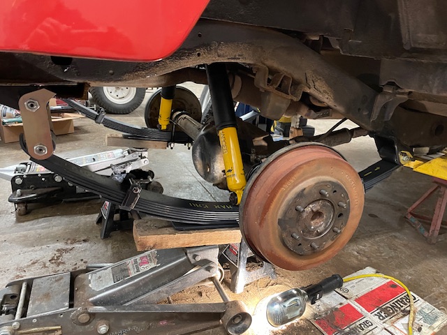

I have done quite a bit of work to get these SOR Heavy Duty 2” over stock height springs to articulate. Here is a test I did with and without the ProComp Explorer ES 3000 shocks. My concern was/is that the stock shackles are too short. I like the ride height with the stock shackles.
Is the shackle angle okay, and is this decent flex.
I weight 230 lbs and I am bouncing up and down on the tow hitch.
33 x 9.5 on stock 15’s.

Your shackle angle looks great. You'll get more bounce and movement w/o shocks, because shocks dampen the movement. Yes, your shackles are probably to short. A good 4" lift needs longer ones. Usually they are longer than stk. If the spring were to max out(flatten) the stk shackle will prevent the spring to extend all the way and possibly bend the spring. A longer shackle will probably be more vertical.
It really depends how your going to use it.

Your shackle angle is great for your purposes.

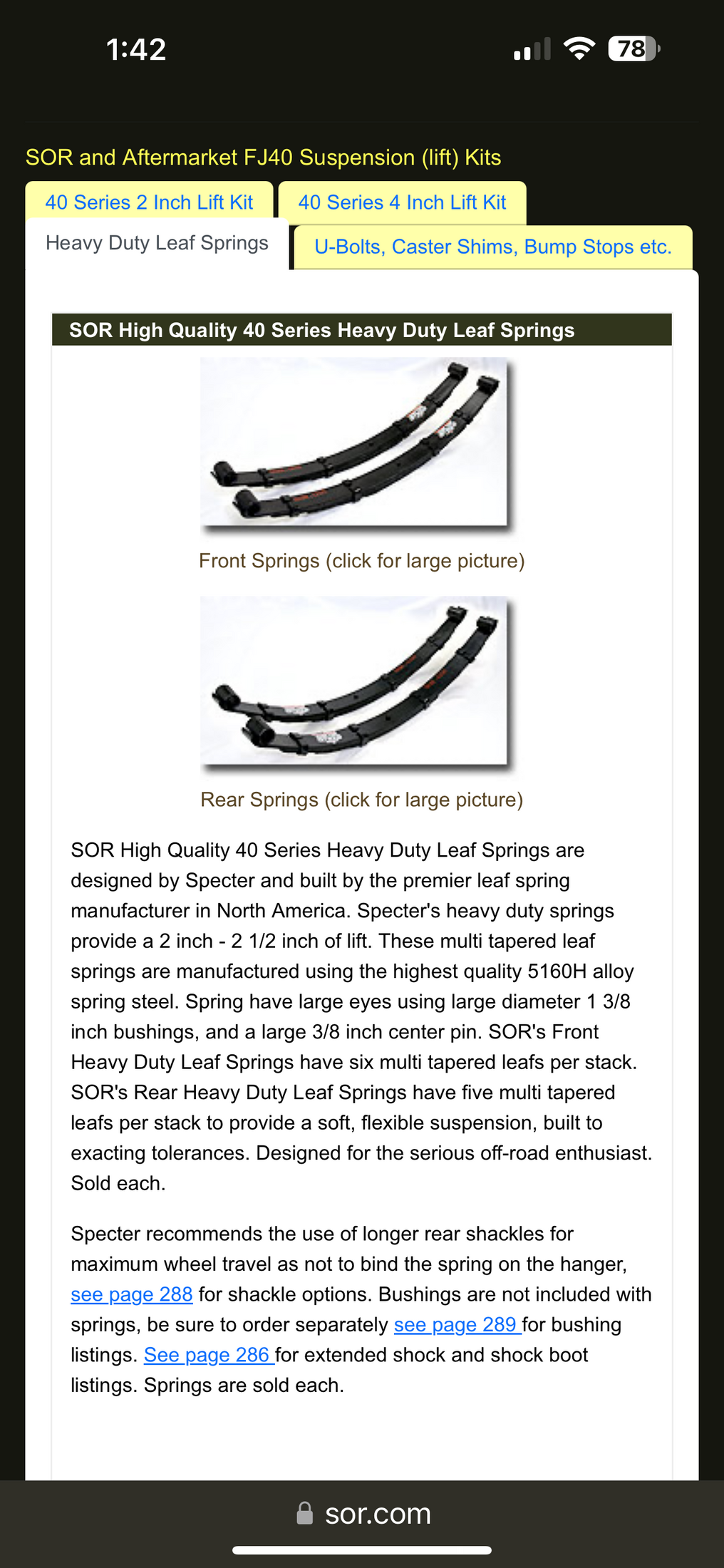

These SOR heavy duty springs only have 5 leafs in the rear and 6 leafs up front. They are thicker steel than the stock 6 leafs in the back and 7 up front…
Removing a rear leaf would leave just 4 leafs in the back😳. Removal of one leaves a fairly large gap in staggered leaf length, depending on which leaf I remove. It would be least visually “strange” to remove the shortest leaf, but would I get much benefit (articulation) from its removal?
In hindsight I wouldn’t have purchased these springs. But I installed them before the project spiraled into a body off restoration, before it became a Sunday driver.

How does it ride without shocks besides being bouncy? Is the ride softer? If not, then it's the springs. You can adjust spring ride by removing leafs or cutting leafs shorter except for the main leaf. Also loosening spring clamps may help slightly. Or just get some leafs that are softer. I've heard good things about dobinsons

These are the OME shackles that came with the 2" kit. Cruiser Outfitters.

I think the lift comes from both- more arch and longer shackles.
