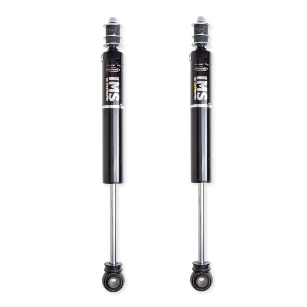

I’m running Bilsteins on my 40 and Dobinsons IMS on my 80. Bilsteins have been fine and IMO were an upgrade to the OME’s I had before. Dobinsons are fantastic on my 80 and they are available for a 40 up to 2” of lift, if I had a do over I’d spring for them on the $40
Well, I see the days of $29.95 shock absorbers are gone….i Have some thinking to do and see where this plan is going. These must be remarkable at $550.00 for just the front. I would imagine I would spring (no pun intended) for $500 for the entire front and rear. But as I mentioned, I love driving the land cruiser but it’s off-road days and mine, have gone the way of the $29.95 Monroe shocks….

I had what looked to be oem fronts and Monroe rears………. No doubt the Dobinsons are great but for me, the Bilstiein 5100’s were a significant improvement!

+The XL's. Fox and Dobinsons are (All) excellent bits of kit. I'm just saying, given @knuckle47 description of his intended terrain, driving environment and 69yr old spinal column, the Bilstein 5100's are an outstanding option. Not to mention for the discerning TLC owner, with a Mrs who watches the Platinum card, they won't break the bank.
